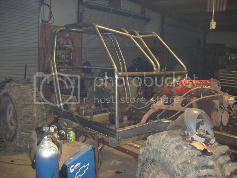

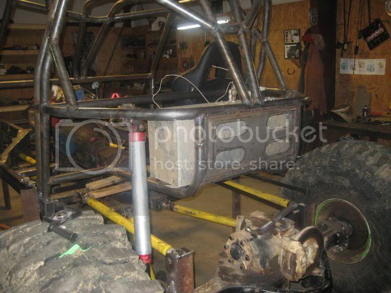

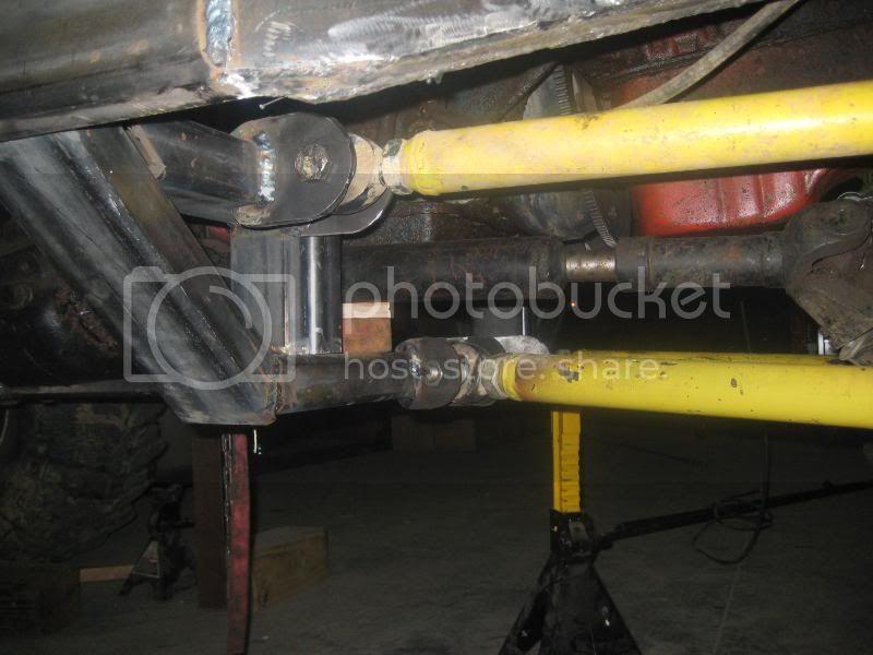

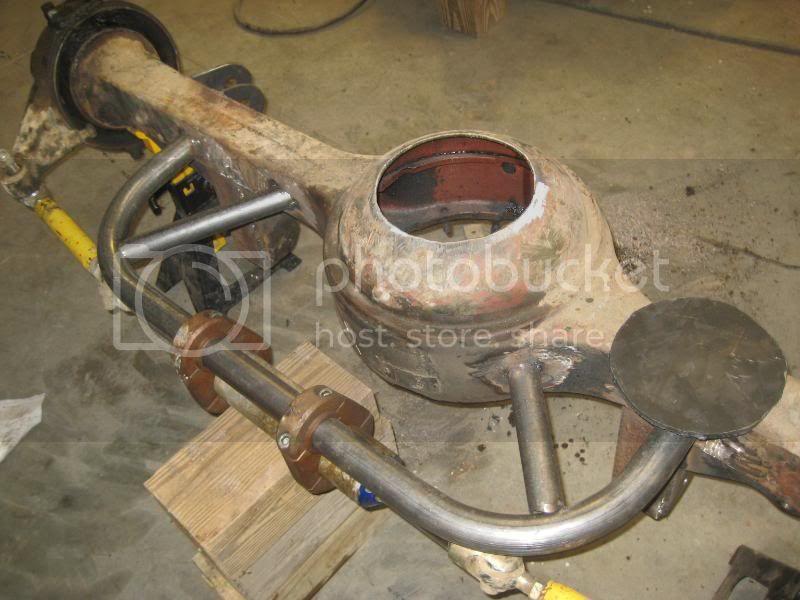

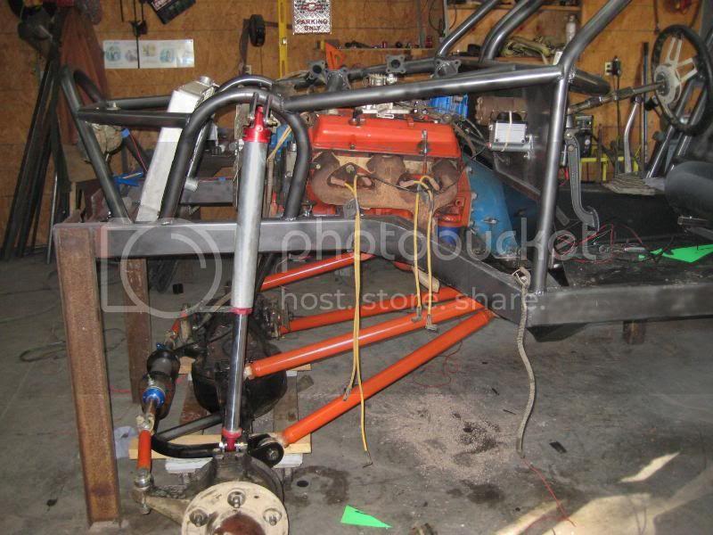

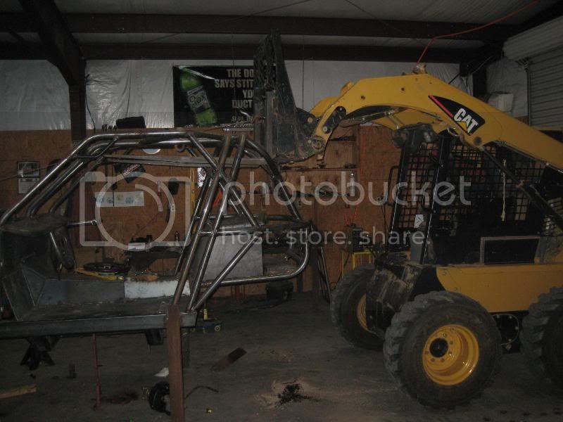

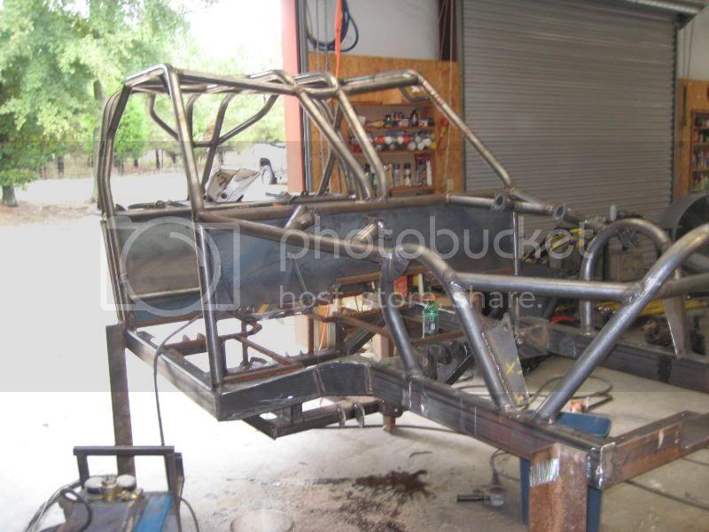

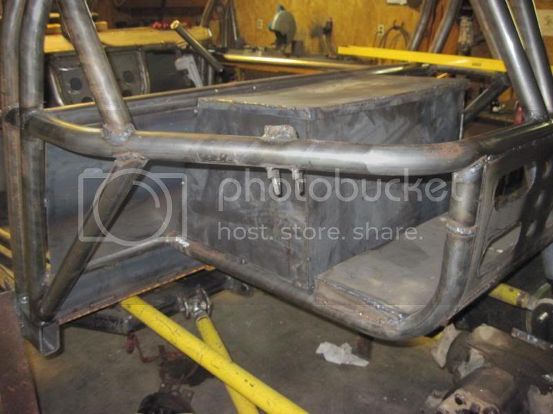

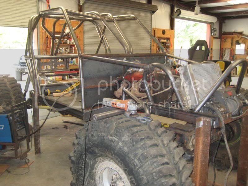

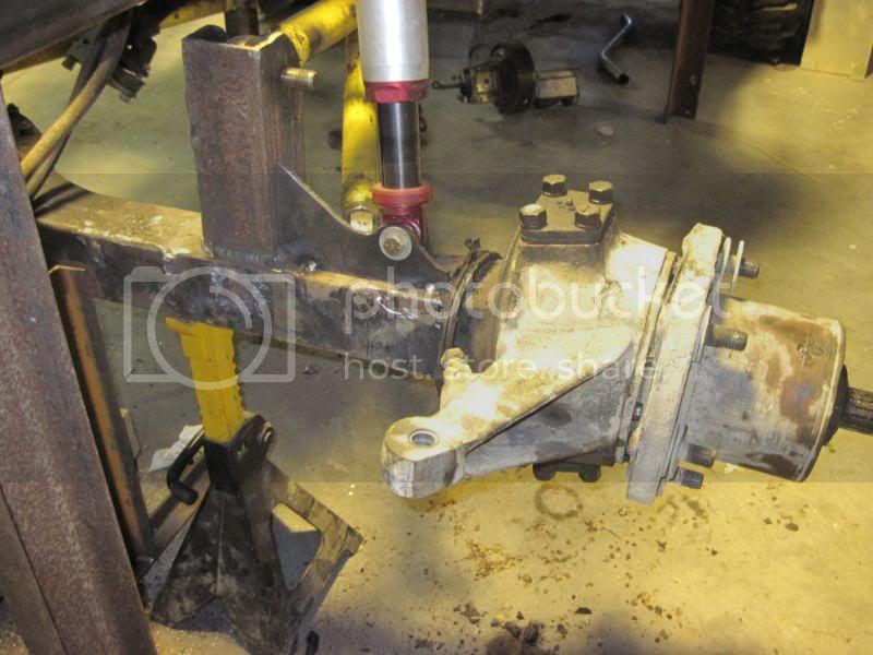

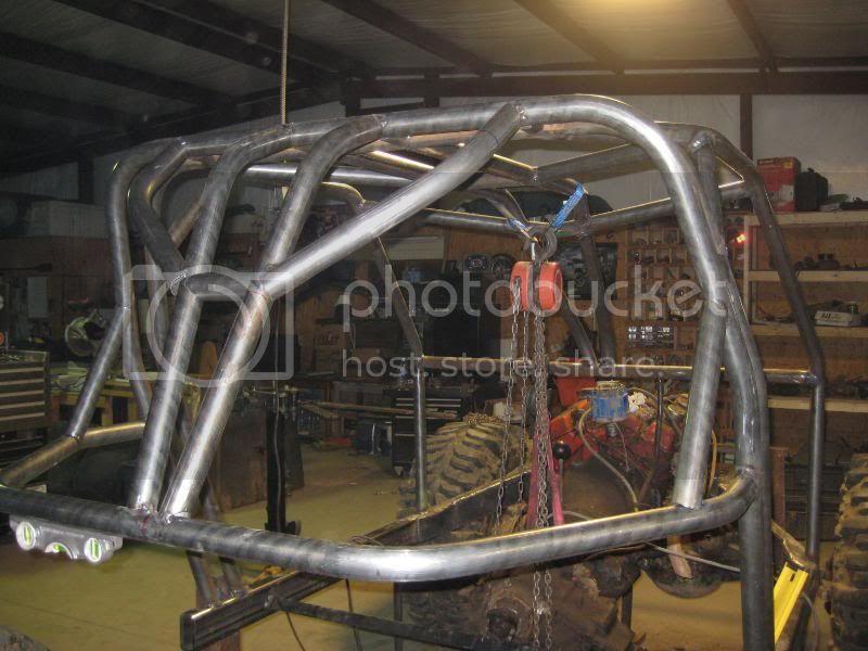

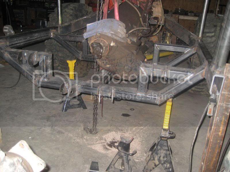

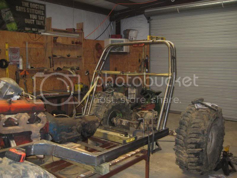

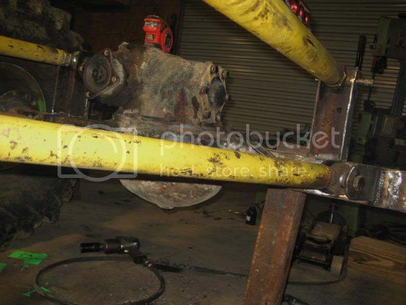

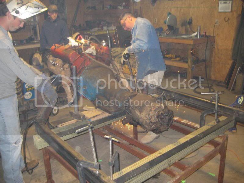

Specs: FI 350, turbo 350, NP 205, Rockwells, 44" boggers, 4 link F&R, and a bunch of other parts stripped of the old K5...........

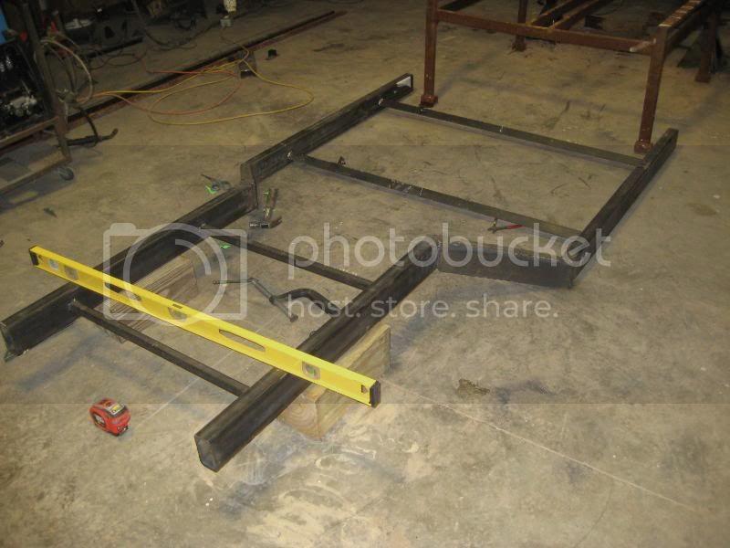

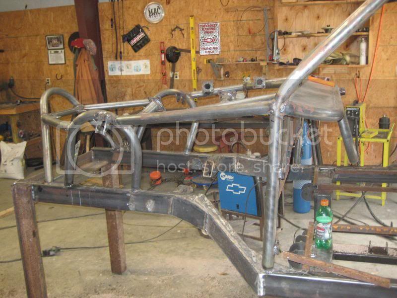

2x4x1/4" Frame.

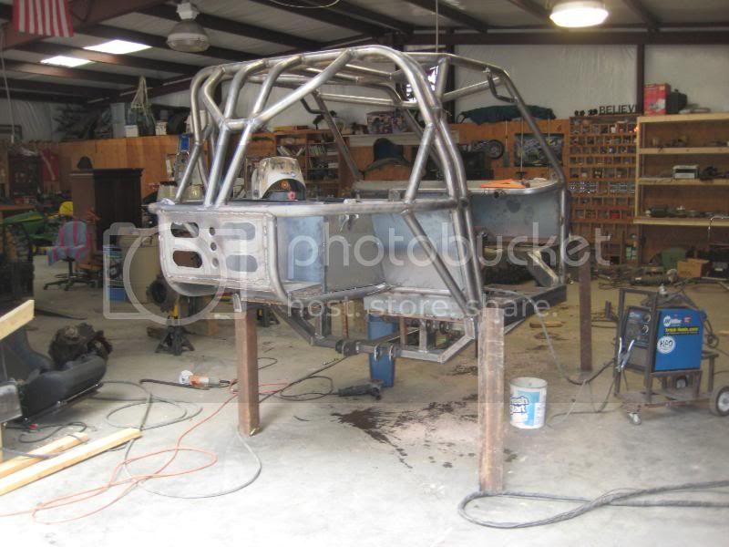

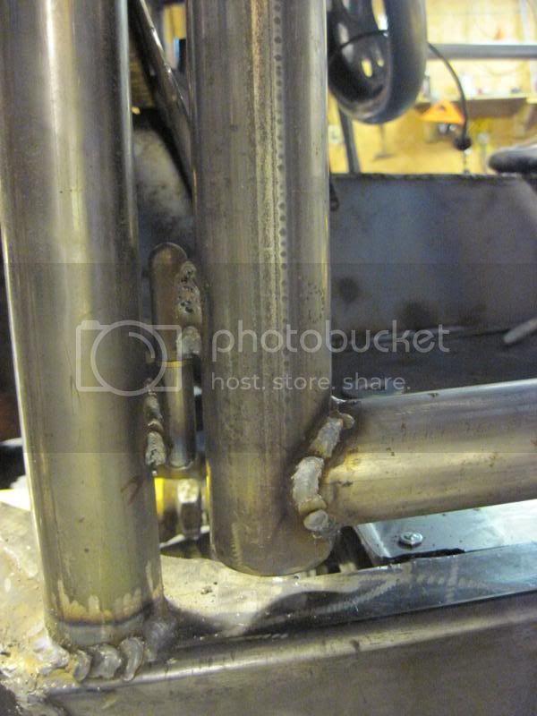

All tubing is 1 3/4" DOM

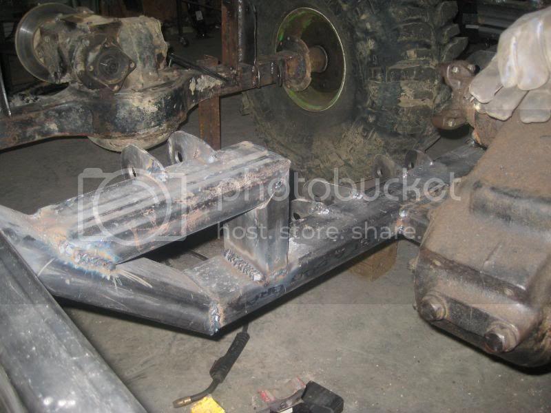

2x4x1/4" Frame.
