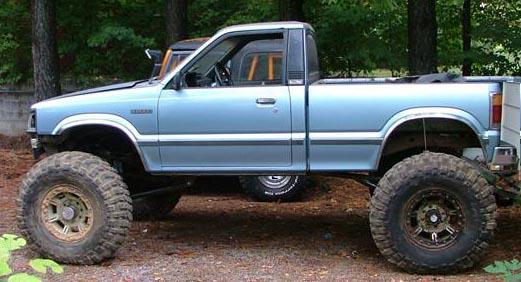

Got the front lower links done, just need to clean the frame and weld the brackets to the axle and frame.. plan is to have a roller tomorrow nite:super:
The pics suck, damn camera phone...
As it sits, 117" WB, 28.5" Belly clearance.
Front lower links are done, working on uppers and mounts for them...

Well, finally got some progress to report...
The front 4 link is 98%, just need to make my truss fit and link tabs for the truss... then fabbing spring mounts.
~Mo
Its officially a roller!
Finished up the front links, truss, spring mounts...
Now all thats left is everything thats not done yet :mad:
~Mo

I see some sheet metal that's gonna have to get whacked........ :D Hey wait, are you gonna bob it?
CrustyJeep said:
Looks pretty good :D
The plan is to bob the rear so the tail lights are just behind the rear tires.
Still have to "clearance" some on the front. I do have 2" spacer in rear right now, so they might come out and i'll cut the wheelwells.
