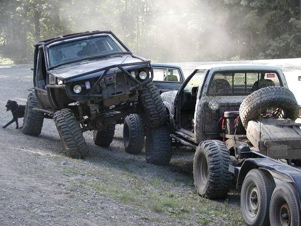

Well, holy crap its been a while since the last update:rolleyes:
Thanks Bunk for reminding me :beer: Thanks for the props guys!
Heres some updates:
New motor went in without snag, runs great and stays cool! Moved up to an alum radiator and shrouded fan.
Cracked the fuel cell and installed a 17gal unit, made a semi bling hold-down cage and added some go-fast holes :redneck:
Umm... then this happened...
Causing this to happen...
Which in turn allowed me to do more upgrades:mad: ...
As it sits now :booo:
The last time its been offroad :eeek:
Hope to have it back together for holloween ride :awesomework:
Right on man...So let me forwarn ya..You should double shear those tie rod ends at the steering arm. I broke 3 bolts before i did..One turned into a roll as i was going down a 10 foot drop off. I have btf arms as well.
