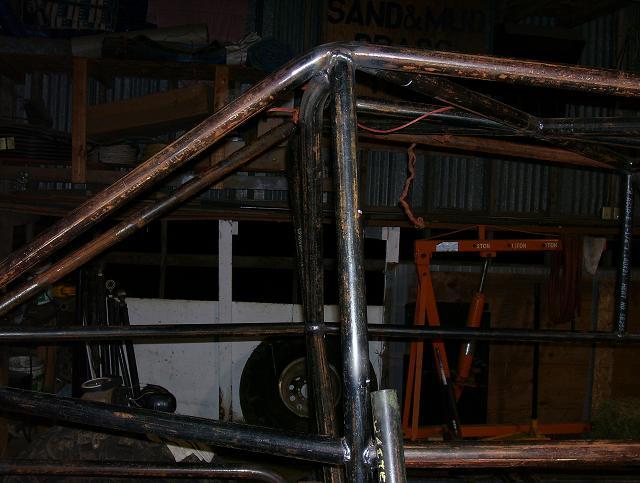

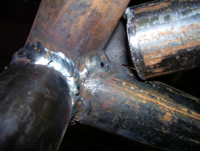

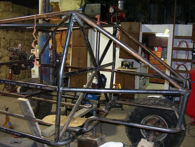

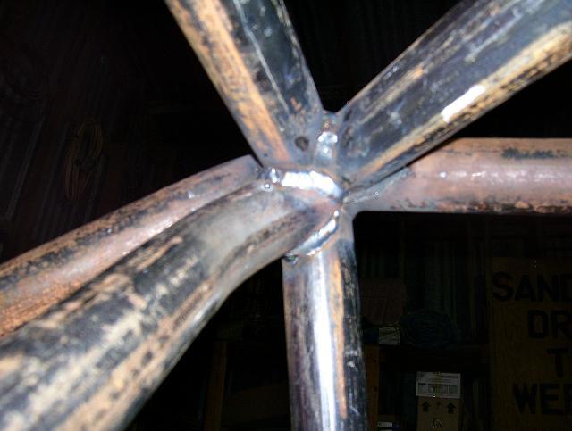

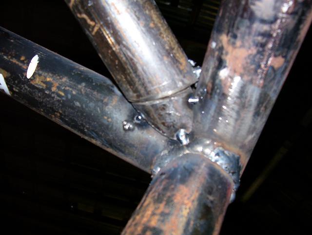

to get the last piece in place I cut one ear off and then tacked it back in place and will weld it up. Just no other way that I could figure out how to do it. Once its welded up it should be pretty daam near the same strength wise.

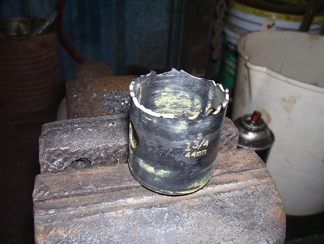

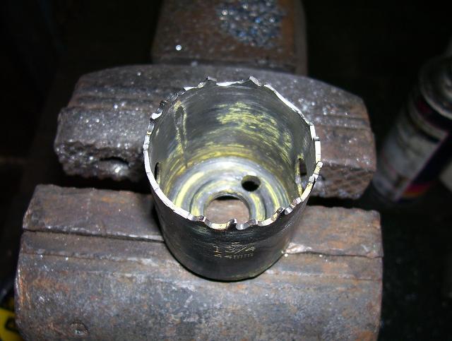

I thought the hole saw was begining to run a lil ruff and was grabbing and twisting the drill a bit :redneck: :fawkdancesmiley:

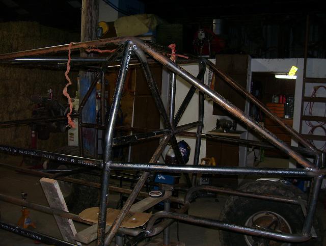

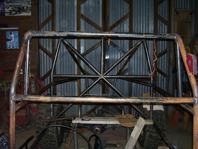

put a lil bend in the x brace behind the seats so that I would have a lil more head room
OK so its a lil bit more then a "X" brace behind the seats :;

How wide is it?
I believe that its 56" wide, it should be sitting at pretty close to ride hieght with the bottome of the frame at 28" and the top of the cab is sitting at 74". I would like to have the bottom of the skid at right around 20". All this is on 37"s that actually measure around 35 :rolleyes: .
It sound's like you are building with werock rules in mind, just remember to leave 40" from the butt of the seat to the inside of the roof.
Hmm ok I will have to remember that, I know that they have a 3" rule between ur head and the nearest roll bar.

wow, lookin good stan, needs more triangulatoryness..... Pups are neet too.
Thats what I was thinking also lol.
