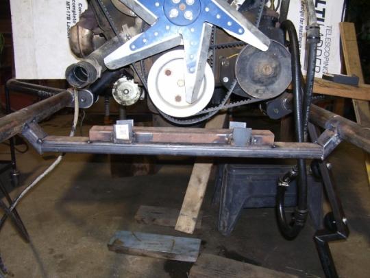

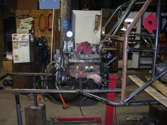

well got a lil more done, motor is sitting in it. Finally got my ARB's RD99's. Good luck on getting them right now, ARB is out of stock and will not have any back in till who knows when. I know that through the end of Feb. that they will not have any in stock. I found three and was happy to get a couple. My 12 gal. fuel cell showed up, I sent a R&P off to get heat treated and chryod, brake pedal and MC showed up, cutting brake lever showed up and a bunch of lil parts.

I have my lower radiator mount in place and mounted. The lower winch mount/bumper is tacked in place, I still have to finish the upper mount up. I had to go with a reverse mount MC because my hood is so narrow it would be sticking out of the firewall all by its self. Poly performence set me up with a single pedel dual MC unit with a 3/4" bore for the front and a 7/8" bore for the rear with chebbie half ton brakes all the way around. I wish that I would have made the cab a couple of inches longer for more leg/pedal room.

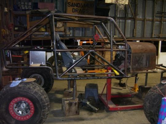

Why is there 3 feet of chassis in front of the motor? What's the wheelbase going to be?
the wheelbase is going to be around 108, a lot of the front end will be getting cut off so it will not be that long. figure 9" for the winch, 6" for the radiator/electric fan combo and 3" inches for the mech. fan so it should be 18" in front of engine. The frame will be even with the front of the tires.

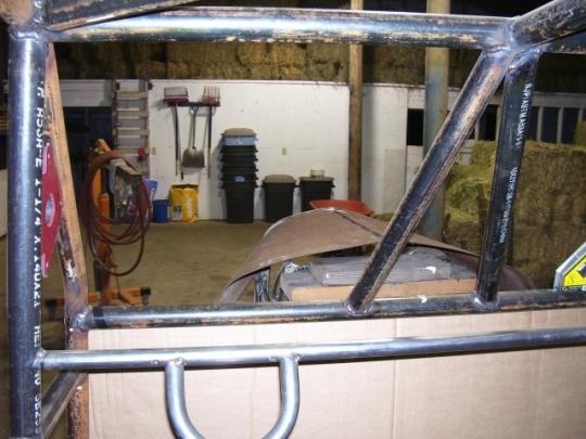

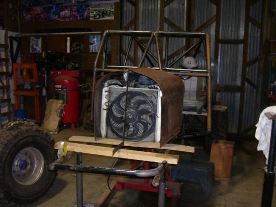

a few pics of it with the hood on it, gonna be a tight fit to get everything to fit in there. I have to run the reverse swing brakes or they will be sitting out swinging in the wind. I have about a .5" of clearence between the hood and everything lol

Make sure and use hi temp paint on that hood, wow that is close. Good thing its not a big block or a hemi...... Looking good so far. :awesomework:
