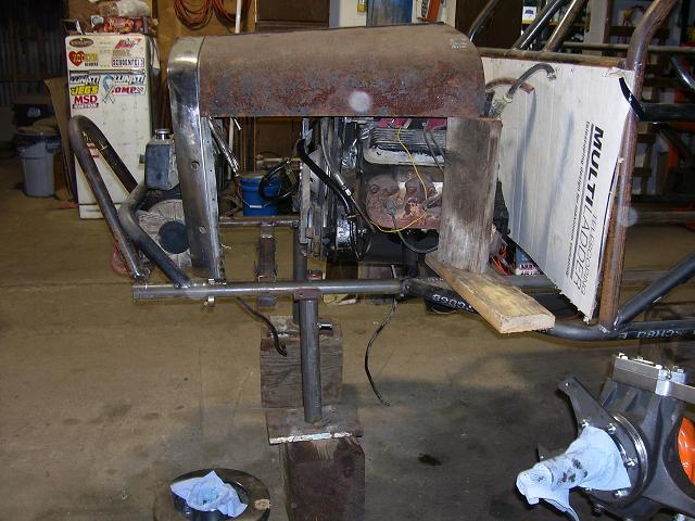

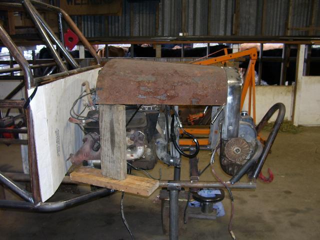

a couple of more pics of it with the radiator shroud, I am going to have to cut a bit of the radiator shroud to make room for the 8274

I am planning on putting a Exo cage around the front end to save the sheetmetal. As narrow as the front sheetmetal is i hope it last for a while. I was going to build my own sheetmetal but it was to cheap to buy them. Now I just gotta figure out if I am going to blast and paint it or just go rat rod and paint the rust clear coat:redneck:

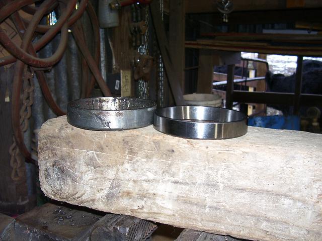

spent the weekend working on on putting the front end together and setting up the R&P with the arb's. Had to due a lot of clearencing to get the ARB in the curry 9+ pro race case but we finally got it done and the gears setup. Put the front end together and had a problem with the hubs sitting all the way on the spindle. After a lot of head scratching, looking up part numbers, a few phone calls to diamond axles, and checking parts numbers and sizes we found out that we had the wrong inner bearing race. :mad: . New ones area at the parts store and I should have the front end together by thursday. Then I will have to clearence the steering stops to get my 45deg of steering.

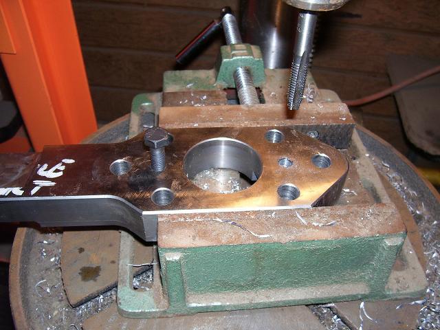

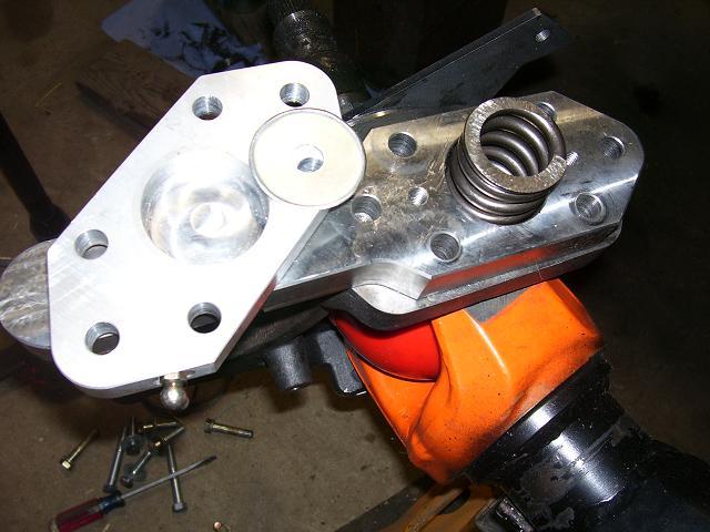

made a couple of changes to the solid axles high steer arms, the keyway such a tight fit that you have to beat the arm off so I added a couple of 3/8" bolt holes to use as pusher bolts. I also did not like the kingpin spring rubbing up againts the aluminum cap so I added a thin sheetmetal shim to protect the cap.

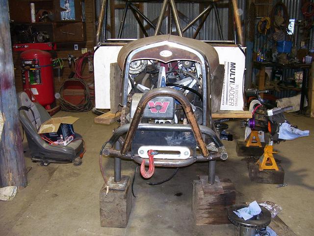

a few pics of the front end with the front bumper, radiator is not in there right now :redneck: .

Looks good, :awesomework: Did you have to heat the arms back up to get them back on? Wow those were tight fitting. I like the washer to protect the cap, probably nothing would ever happen, but a little extra protection won't ever hurt. Spring steel against aluminum doesn't usually do well. Glad we figured out the wheel bearing dilema. I wonder how many others ran into that problem. It ended up being the race for the carrier bearing of a D60, as the inner wheel bearing and carrier bearing are the same, just the races change. 387A as opposed to a 387S. Sure made us think. :mad:

Hey Marty thanks for all ur help, figured out a better way to get the arms on and it works so slick and easy it makes u go duh:rolleyes:

here is the difference between the two races, not much but it made a big diffference :redneck:
