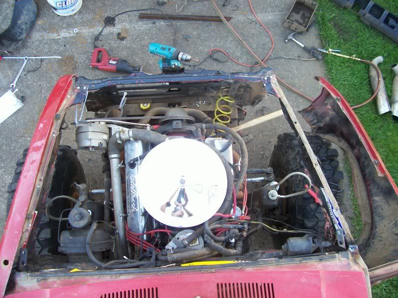

I have a 4.3 chev in my samurai.......is the stock water pump good enough to push coolant all the way back there
4.3 stock pump will work just fine. The biggest issue and one to pay close attention to is how to easily burp the system of air.
any one know of a good wright on this i am looking at moving mine from front to back.. i just wann know what pipe is good pipe to use how far away from exuast to keep it and good tricks on running the hoses stuff to look for and watch out for!
so where yeah guys running this thru the frame rail or just along side it seems like it would be really close to the muffler if not ran the out side where it would get ripped off or broke and pick up a bit of heat from the muffler if ran on the inside
