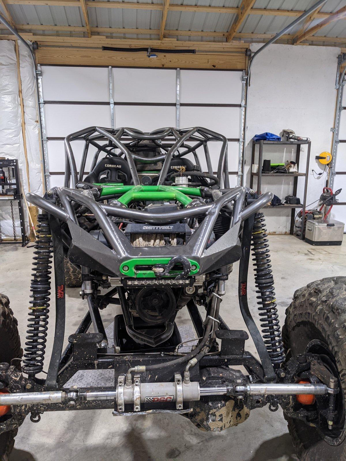

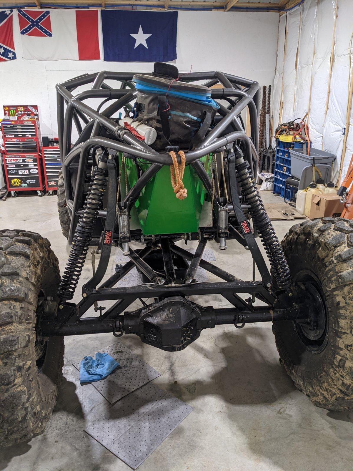

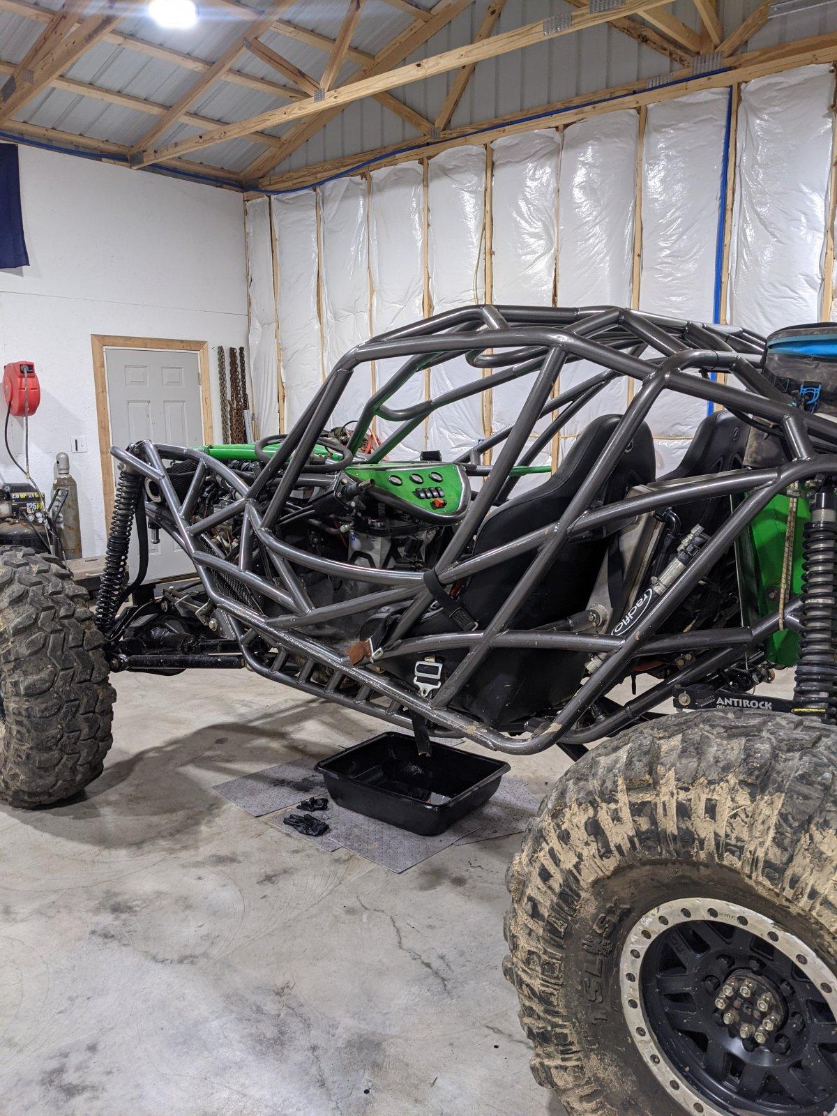

Few quick pics I took while I was in the shop. My cooler has seen better days, I need to pony up and get one with the magnetic lid like Broady's, but after 2k for a new transmission and about another 2k for some metal to start a flatbed, the cooler is at the bottom of the list.
