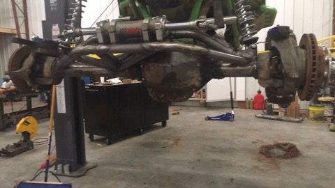

Is 3/8 plate overkill for the ram mount? I have 1/4 also. I'm do something similar to this
Sent from my XT1585 using Tapatalk

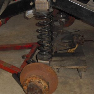

I just cut that truss off to make that axle fit under my buggy. 3/8 ram mount and the piece on the front that ties it to the axle was 1/2 I replaced with 1-3/4 .188 tubing
I seen you were selling your axles on FB, was wondering what you were going to. I'm going to use 3/8 for both pieces, and put in a couple gussets. I would be done with it also do if my knuckles would ever show up.
Not much progress, drill my cooler from 3/8 to 1/2 npt and put in fittings. And new ball joints came in. Just waiting on knuckles to show up, and pick up the chassis. Wheels will be done with powder coat next week.
