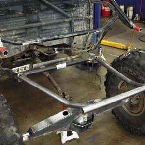

My own toy thang.....

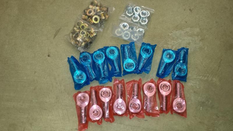

Another box of goodies
I will say I was extremely pleased with the new meats..
