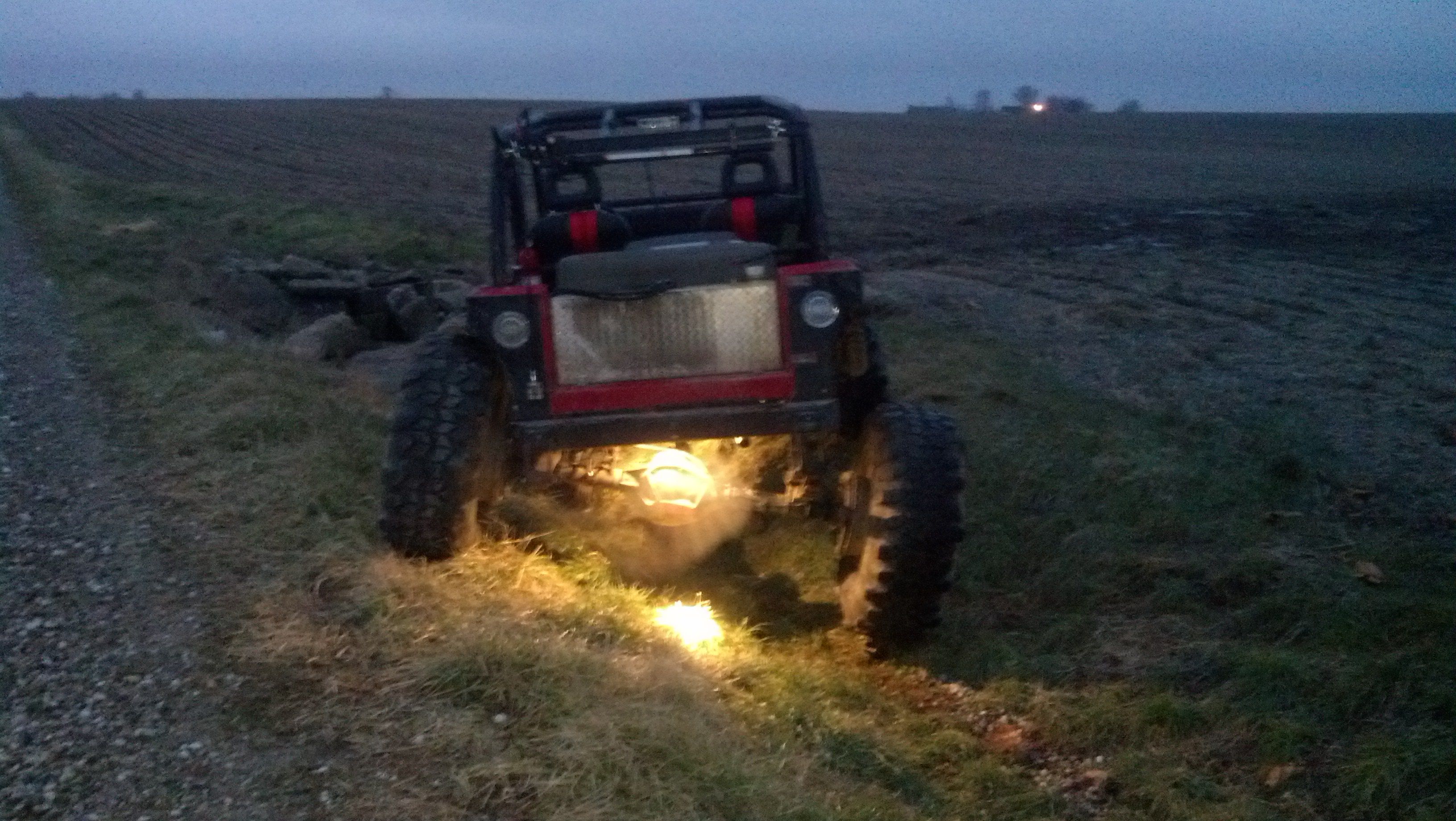

nice project. if your going to use that cage your going to need to add a lot of tubing to make it strong enough to withstand a roll.

and somehow i think the cage is the least of my worries

I'd agree. I'm curious how bad the frame is. 6s were a stretched 5, as you can easily see by the bodywork. The 'stretch' section is easily visible. But the real weakness was the frames. They weren't boxed construction (except up front), and were extremely weak, prone to cracking, and suseptible to rust corrosion. If I were in your shoes, I'd be doing a frame off, sandblast, and rebuild of the undercarriage before I worried about how bad the tub is.

i'm tempted to run a cj5 full soft top & have the extra 20 inches as tool storage ? but we'll see how it all plays out?

wagoneer springs & axles, chev 350, sm465, dana 300,
summer & fall i will square up the body & frame then next winter i'll strip the wrangler down and assemble the drivetrain under the 6
