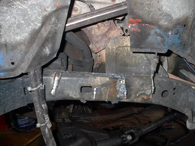

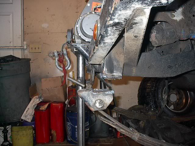

I finally moved the Toy from the backyard
and wouldn't you know it the damn thing just started shedding parts :D
First the fenders and grill made a run for it

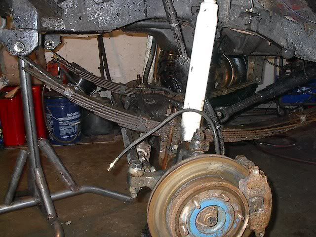

Then the front springs decided to join in on the fun

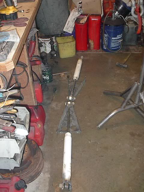

Then wouldn't you know it the damn shocks jumped in too
Hmm whats next :cheer:

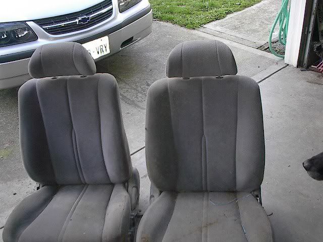

I am also going to drop it down a good 2 to 3". Between fitting the seats in and lowering it I figure I am going to end up losing some more sheetmetal and endup redoing most of the tube. :cheer:

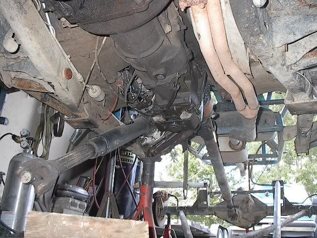

I am running 16" at both ends why are you going shorter in the front?
Trailtoy1993 said:
Right on!
I have the shorty toy tranny and with 16's upfront the driveline wouldn't have enough working motion. :;

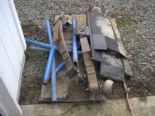

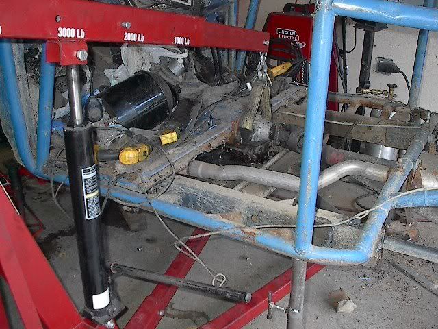

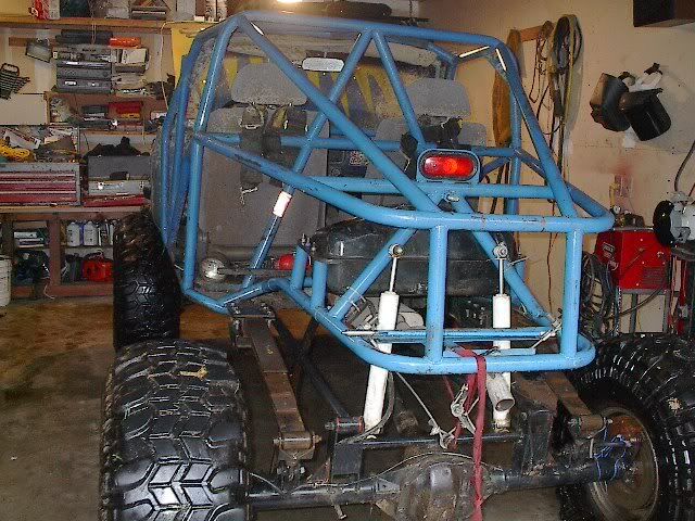

Since I was frustrated with my commuter car I decided to take a little aggression out on the Toyota today and cut some more stuff off :cheer:
Bye bye quarters
You can go to mister seats
Along with a few pieces of tube (Probably going to lose some more)

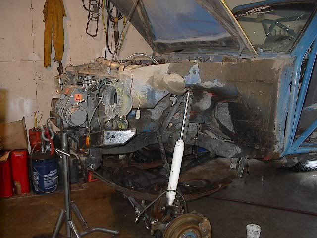

Hmm who needs a floor board
Mr Belly pan can go too
The aftermath
