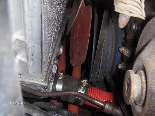

In this set Tonight I redid the motor mount x member so that if needed the oil pan could be removed without having to lift the motor:redneck:
um.. why the gaskets if its just for mount flanges? am i the only one wondering what exactly needs to not "LEAK" ?:haha: cool work but why the gaskets :redneck:
jeeze you could have linked the page at least so I didnt have to go hunting:booo: . The gaskets are to keep the water from getting in and rusting the tube out.

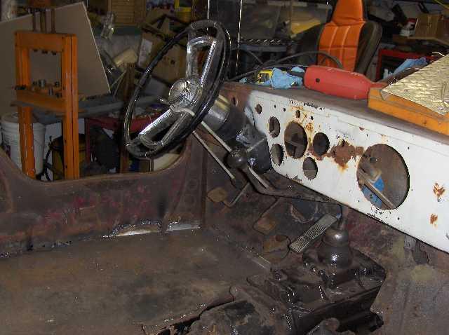

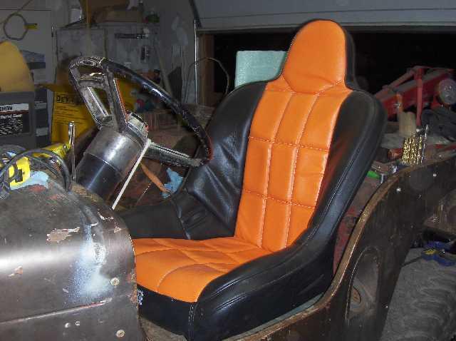

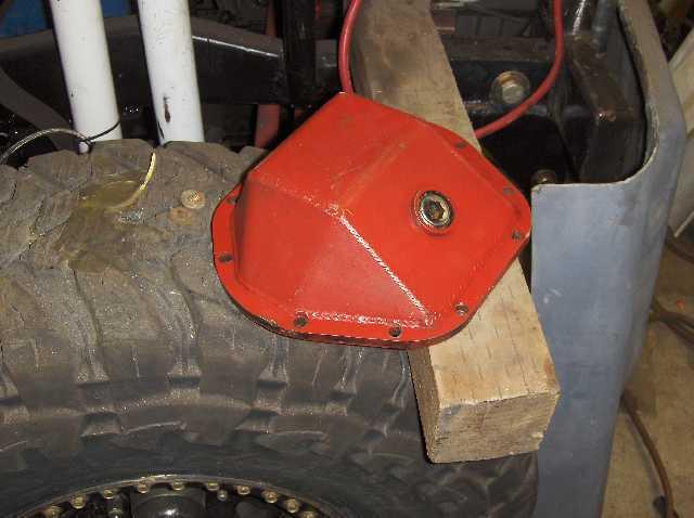

I'm trying:redneck: Heres a few from the last couple of nights. New floors, pedals and steering column. also the diff cover I picked up for the front:cheer: I am going to have to cut into the fenderwells to get the seats back far enough. To close even for a normal size guy like me :haha:

what happened to your cj5 flatfender tub? Is that column a telescopic one too? Lookin good jim, I will have to stop by and take a look.

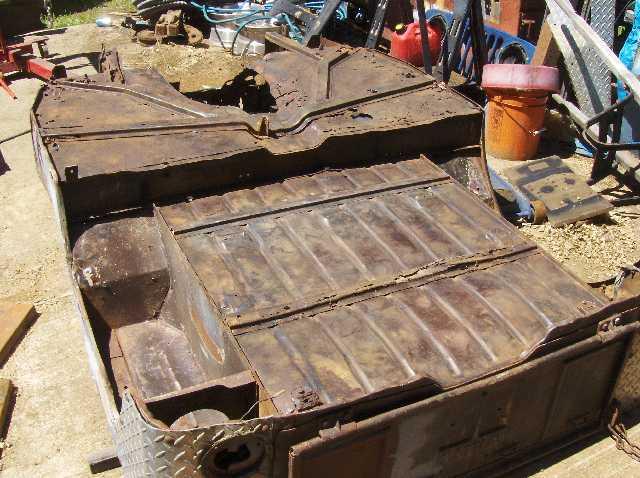

That tub was going to be even more work than this one as well as I never would have been able to put a top on it if I wanted to. Plus this one has a tailgate which is something I wanted on this jeep. The column is a tilt tele one from a early buick I think. I dont really care for the wheel but dont know if I can change it with the telescoping feature.

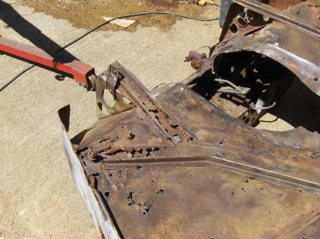

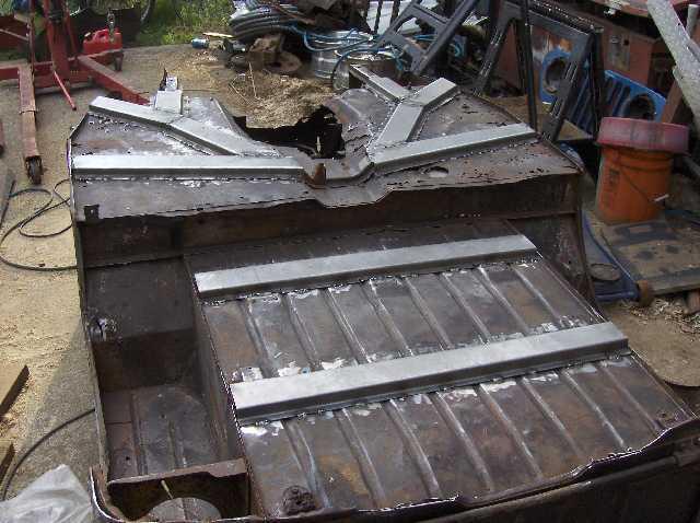

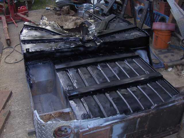

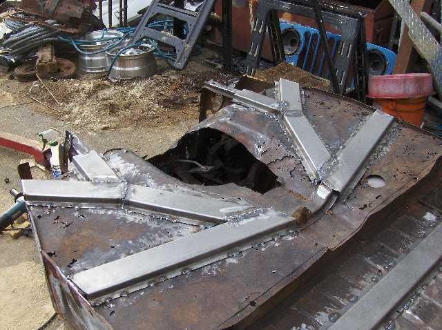

Got a little bit done yesterday:cheer: seeing as to how this tub has been around for some 60 odd years it was due for a little structural repair:booo: jpfreak bent up these neat ribs to go over the old ones to rebuild the ribbing (thanks Kevin:cheer: ) Almost looks like new now:haha:

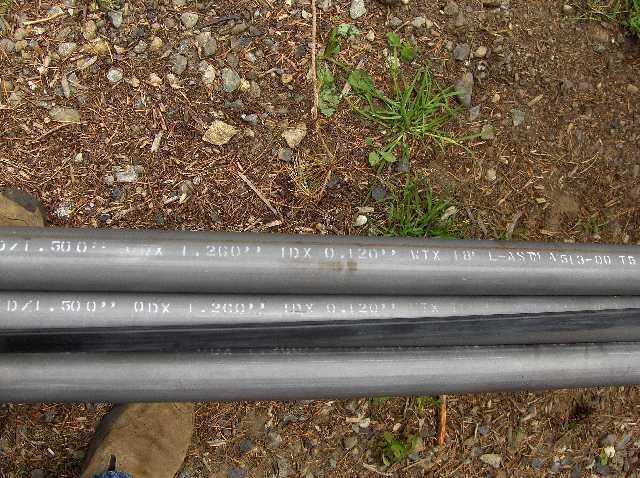

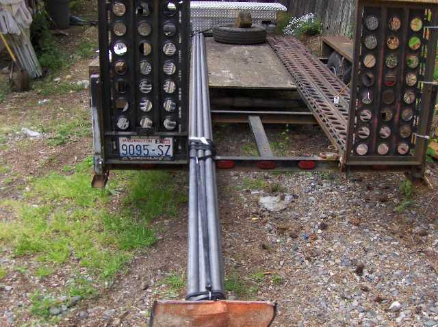

for all you pipe haters I went and got DOM for the cage. 6 sticks of 1.5 x120 wall:cheer: Thanks for the hookup Avatone:awesomework: Now I just need to get the jeep put back together and out to AMJs place for him to create something beautiful:cheer:
Hmm now where did I put that bender again :eeek: :redneck:

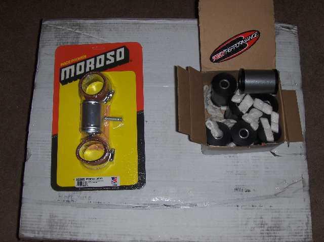

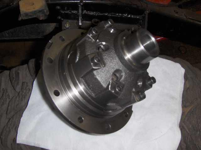

couple more:cheer: New detroit for the front , return line adapter and bushings for the cage to tie into the frame. also got the gizmo to have turn signals without the colume switch.
