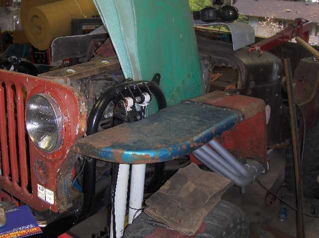

Front hoop is about 95% finished. Just need to tie it into the shock hoops :cheer: I would have done it tonight, but sweating like a pig for 3 straight days in the garage is enough.
Nice work andy!................I will pay you very well to graft in the toyota 3 oval insignia into each side of the tub. :D
Like the battery placement!!!:redneck: Seriously, the rig:awesomework: looks great!!!

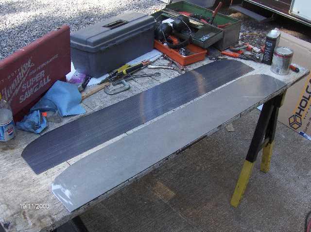

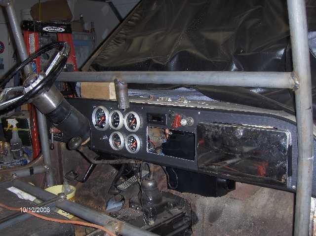

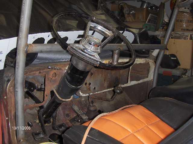

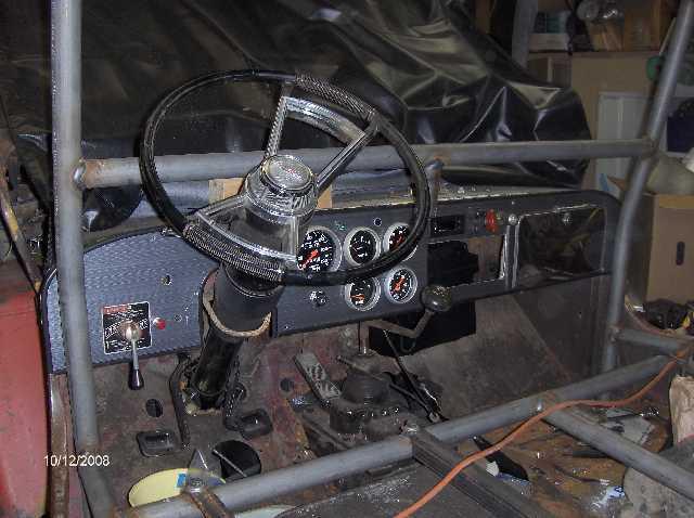

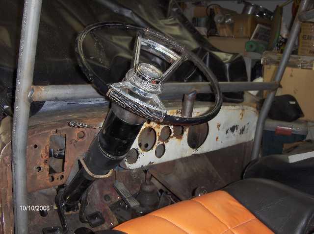

Finaly got back to being able to get some work done on the Jeep:cheer: Got the heater mounted in place (mohave) and built the dash this weekend. In the pics. Dash as it was . Kinda hacked up from a few years of use:booo: So I hacked out the rest of it to make room for the new dash. This made it a lot easier to get the heater in place at the same time:cheer: I made the dash out of a piece of etched aluminum from wilsonart that I had left over from a job I did a while back. I used a piece of 16 gauge aluminum for a backer since the etched stull is like 24 gauge. All put together and I like the look. Still need to make the switch panel (hole). The switch panel will be hinged at the bottom to allow access to the fuse panel that will be mounted behind it.

What's the lever for on the left side of the dash? And what's the bottom of that center bar off the dash bar attach too?
Looks really clean. :awesomework: Do you have a closeup of the etching on the aluminum?
