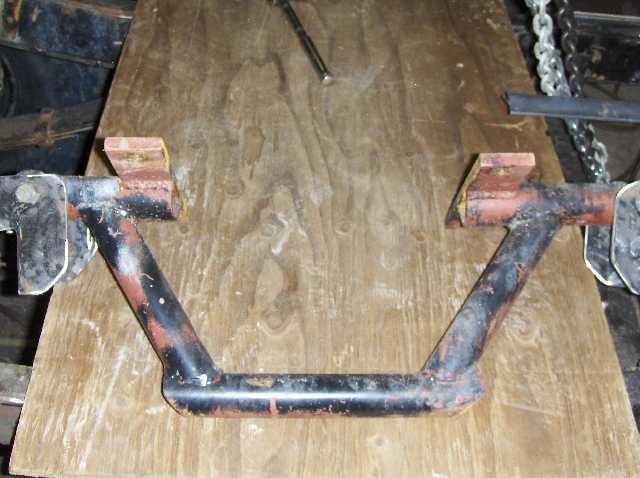

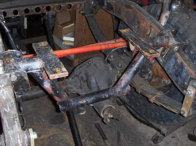

Little seat mount action
Jim was by earler said to go ahead and cut the filler neck area but I decided to work around it and make it so he could get the fuel tank out easily if he needed to:
It added more time to the process but I think it was worth it.
Passenger side was a breeze. Just a couple different planes and two bends
Getting the seat sliders on so I can figure out the finishing touches:
Of course they include hardware to mount the slider pieces together but not to mount it to the seat itself, so another hardware run is in order.
Little bit more
Make a little more room for the seat
Also got the bars running side to side for the seats. Couple of tabs and the seat will be in there. Once again the goal was to get the seats in a comfortable location and make the tank easily removed.

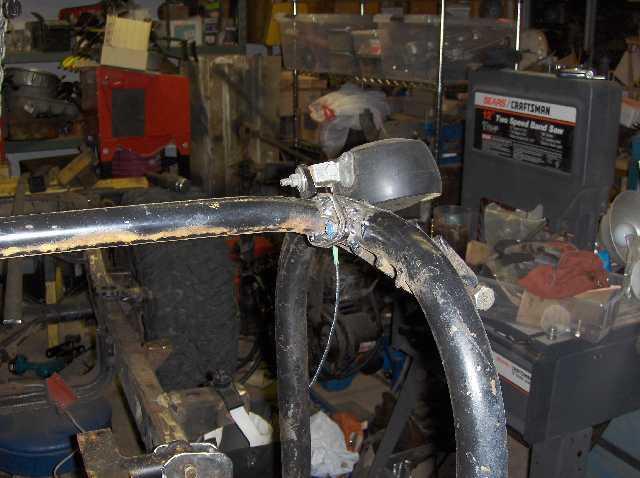

Jim is putting a heater in the rig and wanted to make sure he had defrost. He had a great idea to use the dash bar as the vent. He said he would drill those holes for it later but I knew it would have been a pain in the ass so I went ahead and did it before I welded the tube in:
Lots and lots of little dots
I think this bit got a little pissed off :haha:
Lots of little holes
Of course you need a place for the heater to hook up to

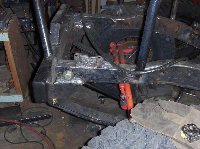

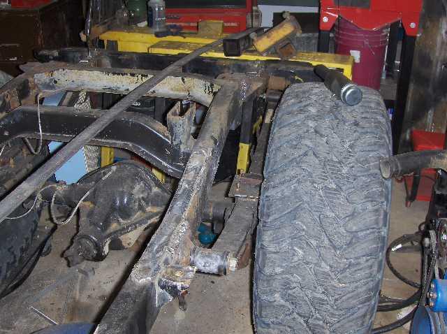

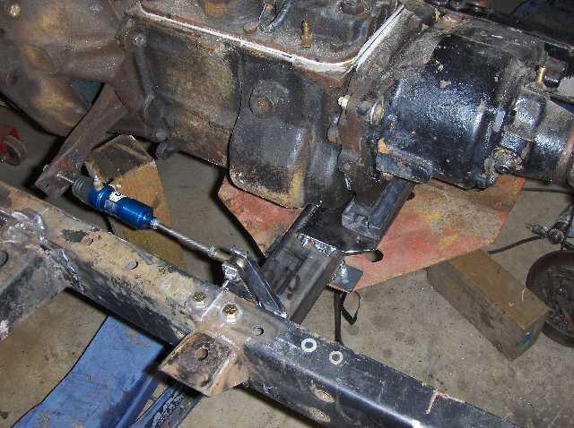

Got the front frame mounts done
Of course the hardware store was out of the right size bolts I needed :looser:

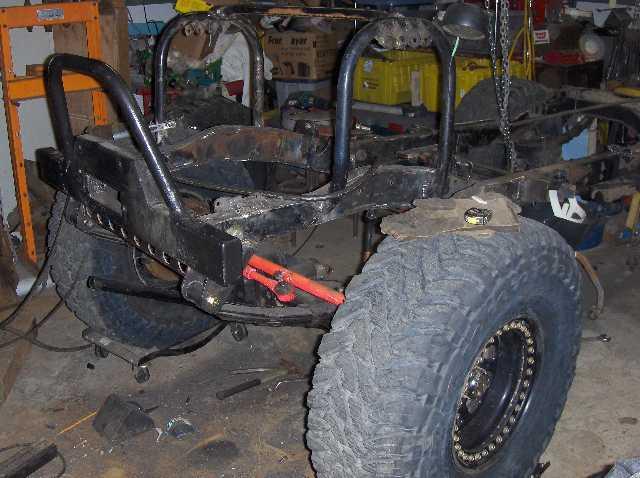

Almost there :cheer:
Front reciever so Jim could move his trailer around the yard easier. I sliced the support between the spring hangers and mounted the reciever to the bottom of the bumper. Jim made the bumper so he could remove it with a couple of bolts so instead of just being able to weld the support to the reciever I made a couple of tabes for the supports to tie it all back together.
The cage is all finished:

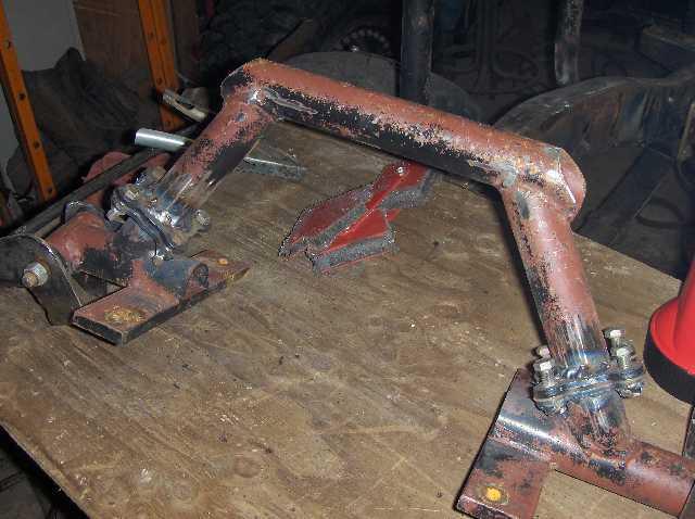

Also got started on the tire carrier:
Now we have one tire rack:
Jim even got a piece of the my old Toyota :booo:
The start of the hub mount. Pick a circle any circle :haha:
Hate when this happens
All better ****ies
Hub mount finished up:
Test fitted the tire and about popped a nut. It even spins :haha:
Finished up by making the pins to keep it open and shut :awesomework: Put little cables on the pins so they can't get missed placed at the wrong time.
