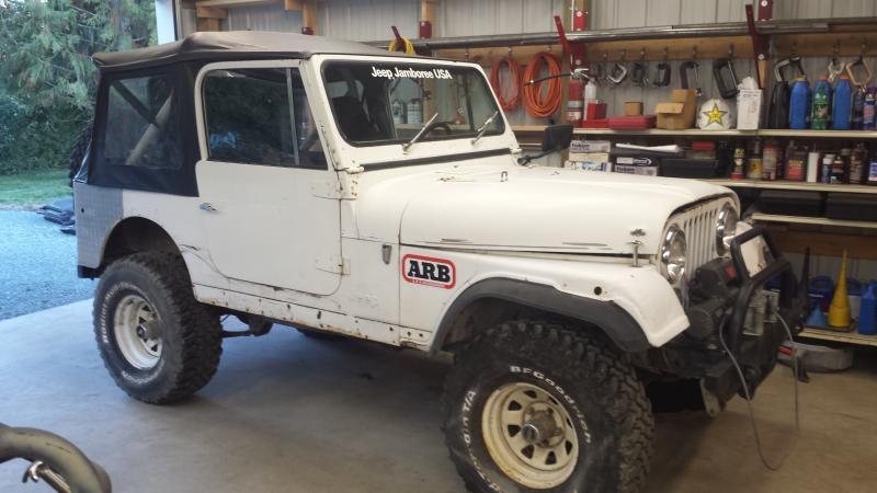

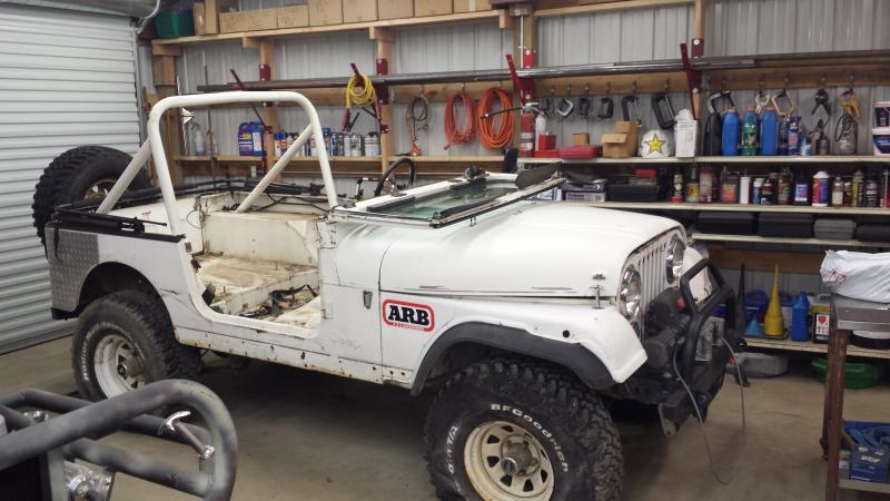

So this is the next project coming into the shop. This is an old buddy that i wheeled with when i got started. Its been sitting in storage for 10 years and time to bring it back..
Billy Brown. I recall he was part of the 4play site way back when also.
I have a "good" non rusted tub for it so thats getting done up. Has a blown axle on the front and possibly a cage and a lot of little things that I am sure I will find that need attention along the way.
When its done billy's brother will be taking it but it will basically be an old school jeep--simple and good working for trail running..

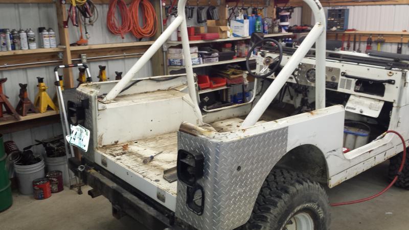

Got the donor tub all cleaned up--had some green slime on the poor thing..
Unloading it by myself off Bills little trailer wasn't too bad. I have it on dolly's so I can still move it around.

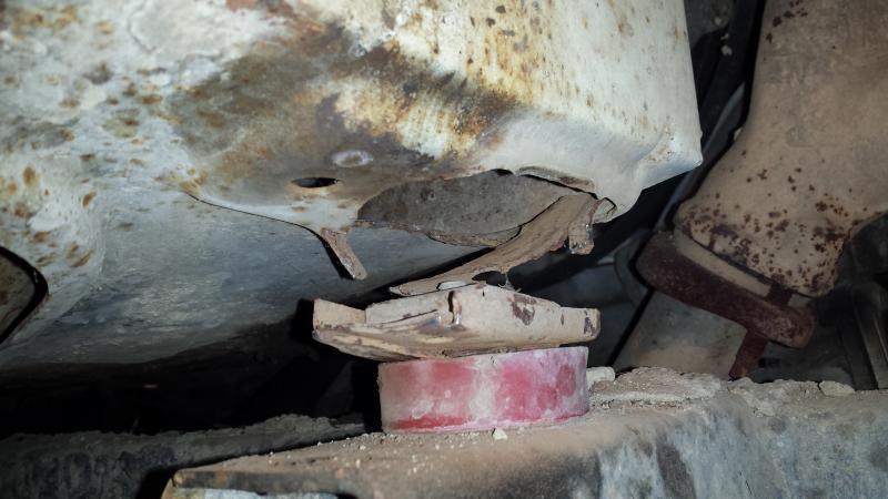

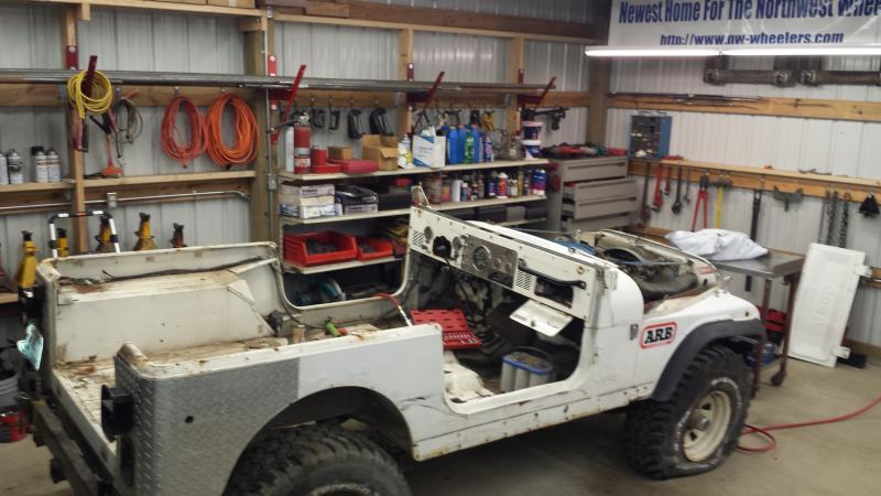

I had to body mount bolts that didn't wanna play nice. One I buzzed a hole on the top side and drilled the bolt out of the threaded insert and the other I just beat the tub until the insert came thru the rusted tub.
Took some time but I got everything unhooked and rolled the rig out from under the tub...

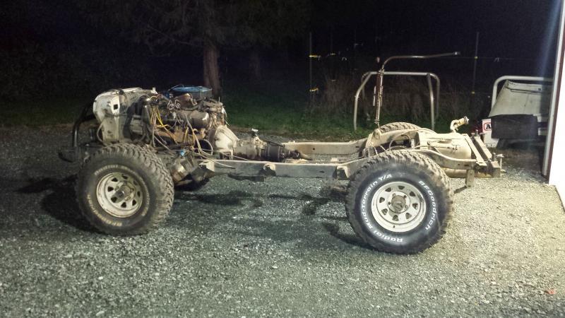

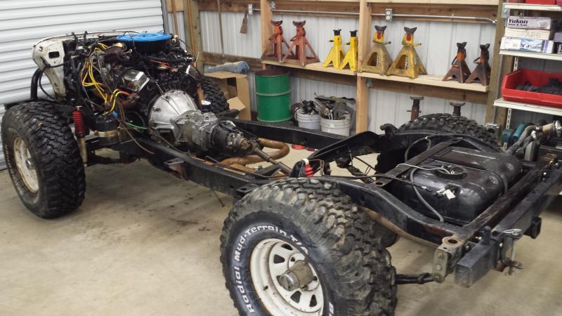

Got the chassis rolled out of the shop so I can clean it up since there is a bunch of work needed on that aspect and also give the frame a good once over to make sure there are no cracks.
Got it all cleaned up and inspected the frame. I am shocked at how good of shape its in. Only damage is a couple bent body mounts on the lower edges--its in beautiful shape.

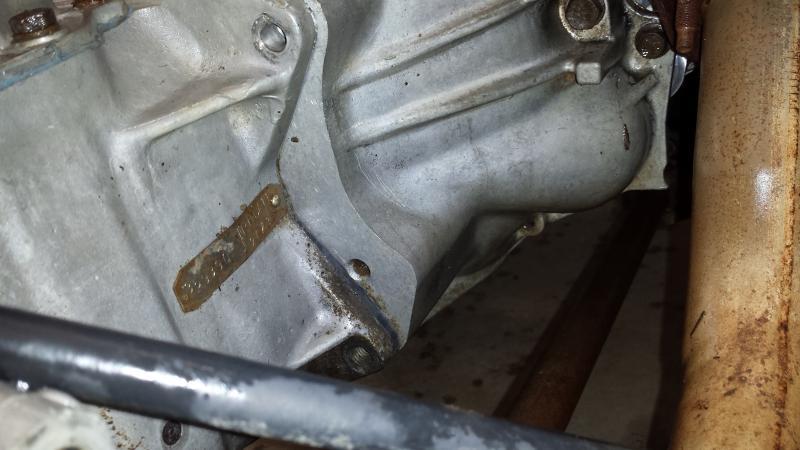

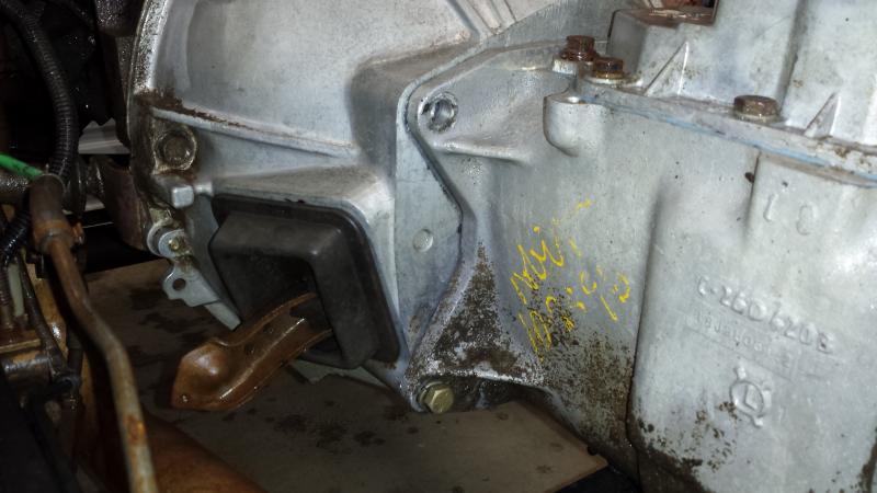

Here I had to take a double take and make sure I saw what I thought I saw. Found 1 out of 4 bolts left holding the bell housing to the tranny :eeek:.
So I will inspect the threaded portions to see if they are damaged or not and go from there. I don't see any other damage around where the 2 mate up.
