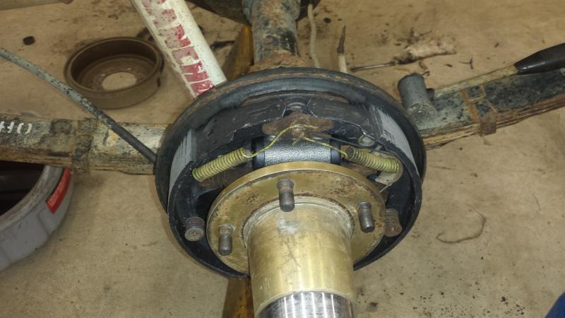

So since I am waiting for parts I decided to get the rear brake stuff done.
Of course the hardlines are rusted to the brake cylinders,lol.

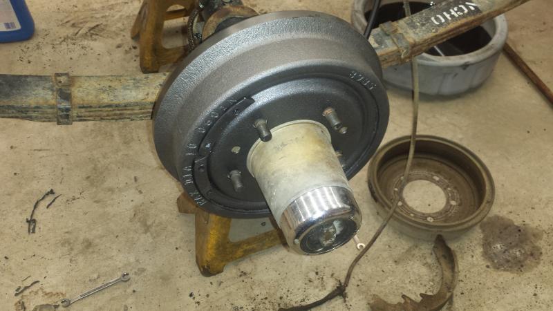

Got the rears done up with new cylinders and shoes.
Also got the new passenger E-brake cable installed.
