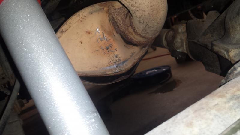

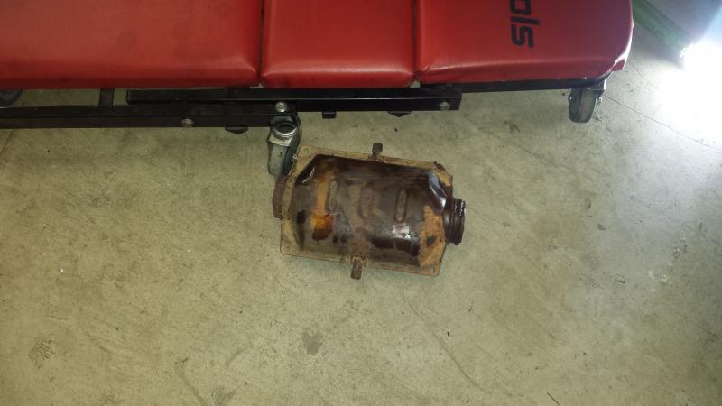

First found the converter was coming apart and plugged the exhaust. So that fell off.... :awesomework:

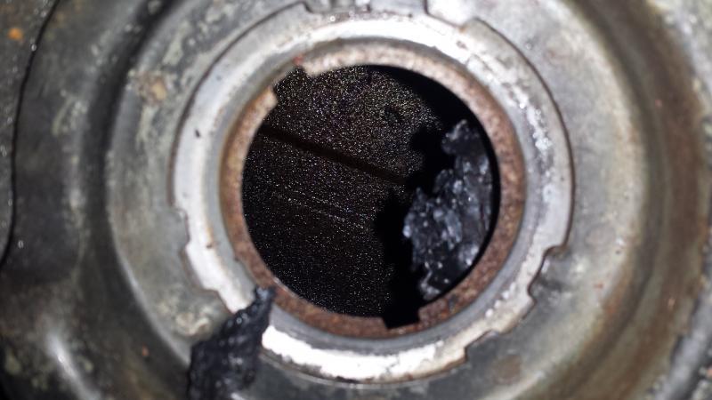

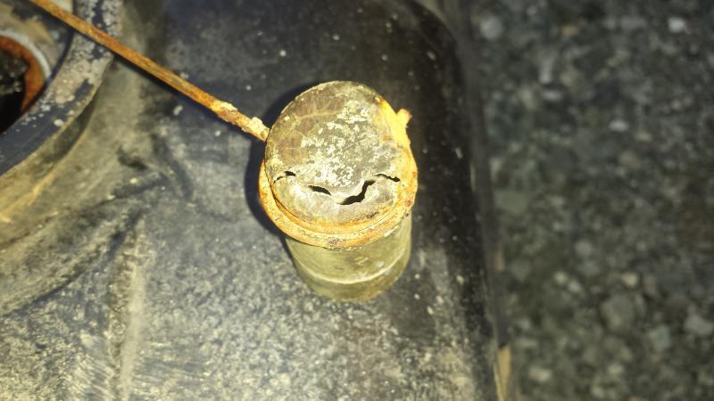

So the fuel gauge also didn't work and bill wanted that fixed so I had him order a new sender. Well thats when I found the nasty nasty in the tank--lots of rust.
So I went ahead and had him order a new tank also.

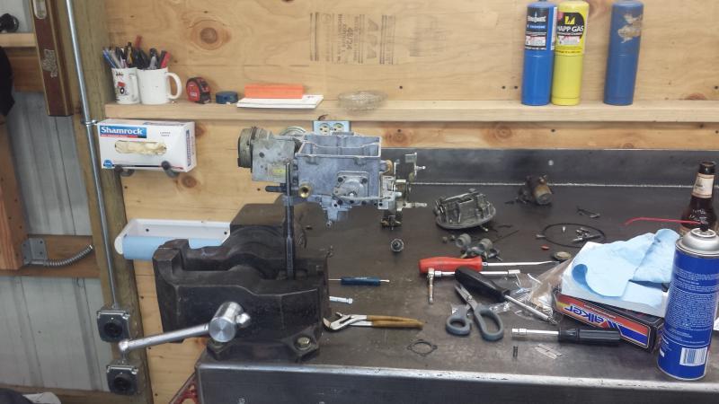

Also the same time the cat went the carb also started to flood over so I was going to rebuild that also. Good thing because there was a load of crap inside it.

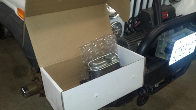

So a cross between some cat crap in the muffler and excessive fuel there was a load backfire and the muffler got opened up like a can and the cat chunks fell out. But the rig now has lots of balls and sounds like a race jeep :redneck:

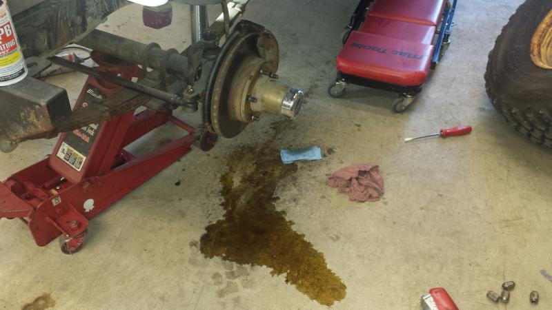

So one last thing to do was bleed the brakes. I never bled the fronts since they were never touched. Well this is where things went south.. All of a sudden a ton of air and no pedal--fawk..
So ya the master **** out and had to replace it. Now the brakes work sweet...

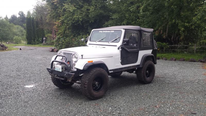

So since Bill had left the wheels here I went ahead and dropped them off at my old work and had them mounted. They are like 3/4" offset when is what the rig needed. Now the tires don't rub the leafs on full lock and it really looks good now.
So thats it folks--this one is done.....:cheer:
