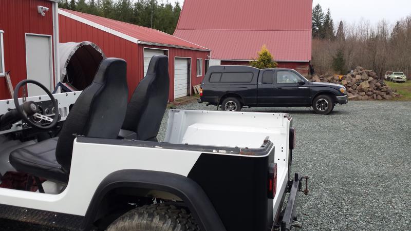

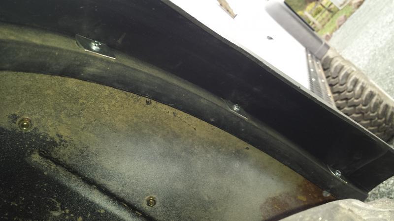

Got the fender flairs on. Re-used the ones that came off the fenders (but attached correctly) and I believe the rears are the yj ones.
I also got the softtop rails put on. Had to drill 4 holes.

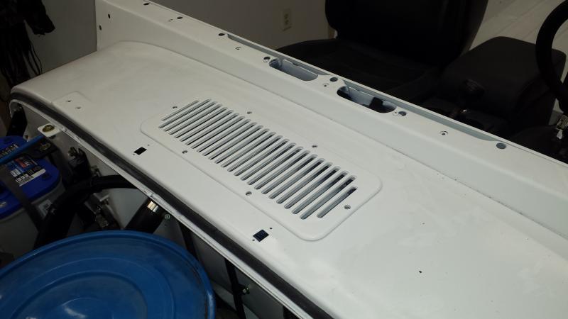

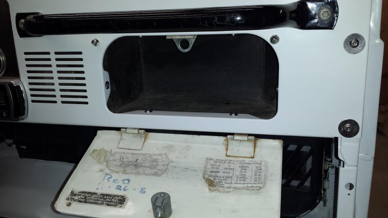

Got the glove box door painted and that and the grab handle on. Pretty much finishes the dash.

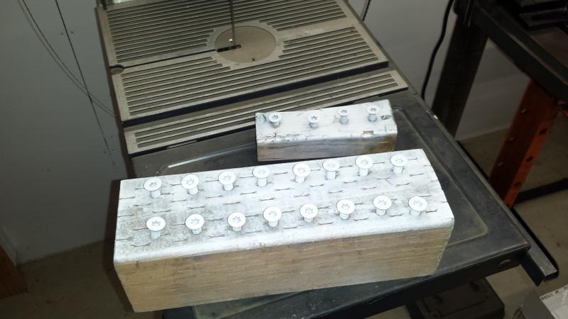

Got a bunch of small stuff stripped/painted.

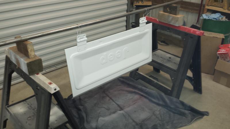

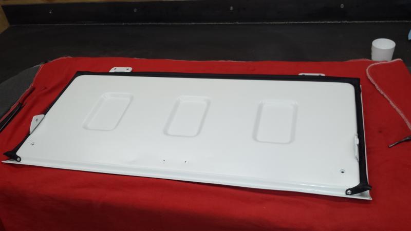

Tailgate is done and just waiting for the new seal so I can put that on.

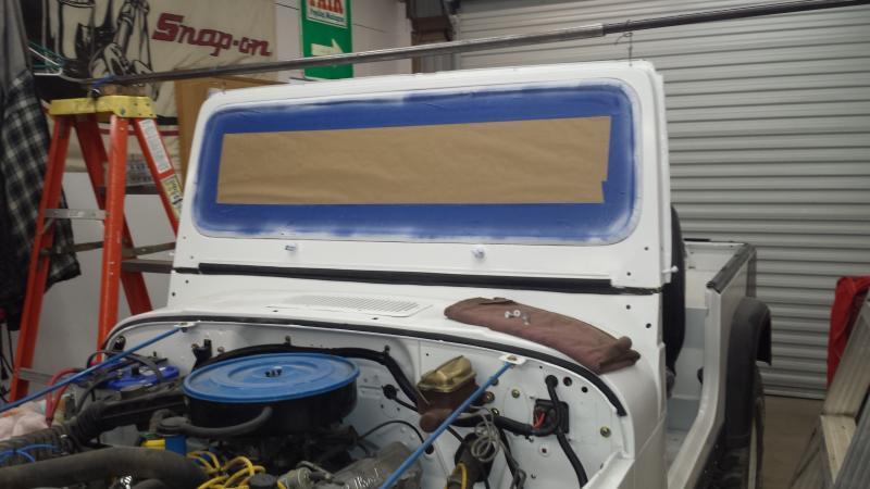

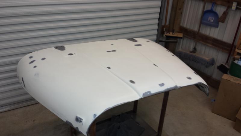

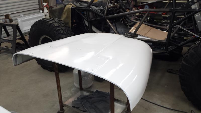

Spent a little time on the hood. The base coat is on and waiting for the top coat of paint to show up.. Also waiting for the new hinges so hoping by end of the week to go on the jeep.

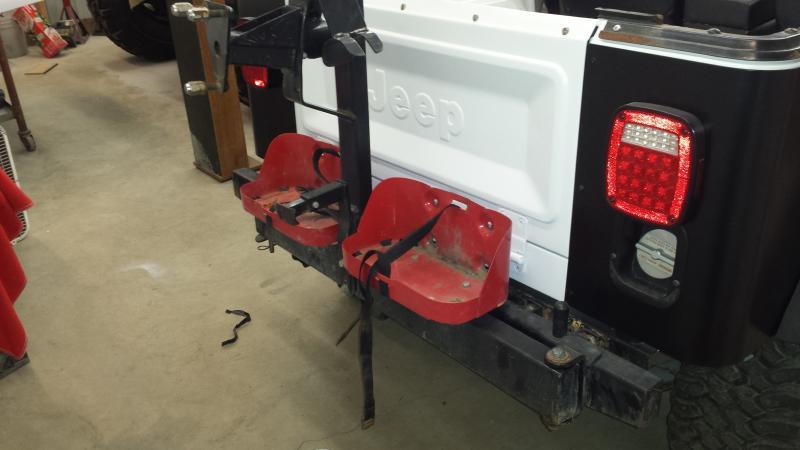

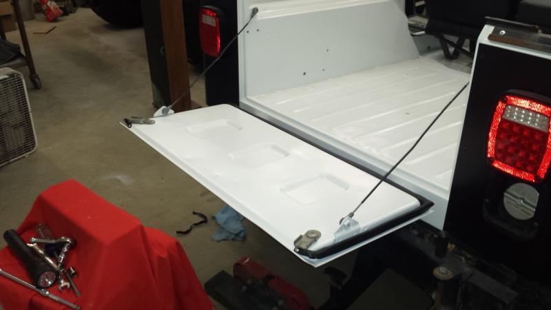

So while the frame paint was drying I grabbed the tailgate. Put the new seal on and installed it. I also grabbed the spare tire carrier and threw it on.

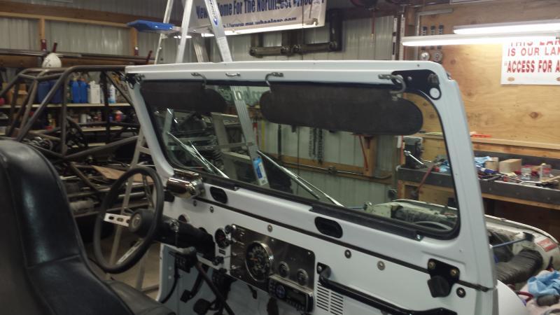

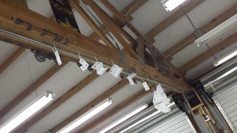

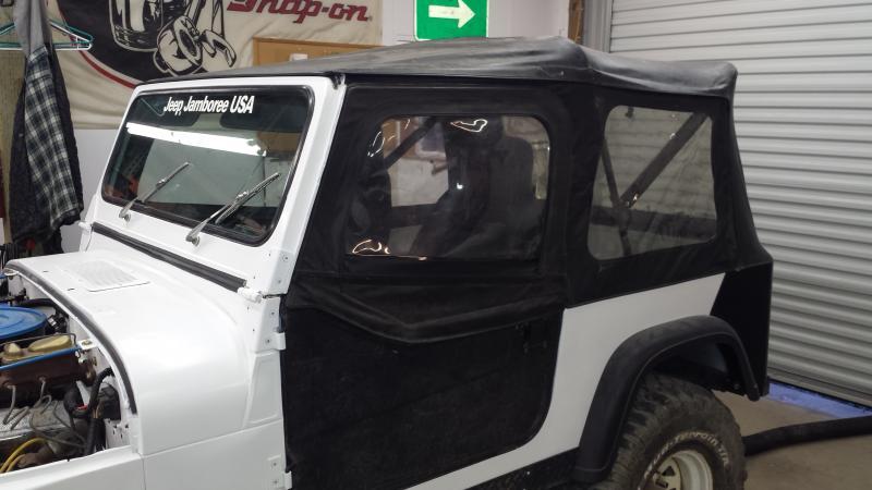

Pulled all the soft top down from the loft and threw it on to make sure fitment was perfect. Its really looking like a jeep again :cheer:
