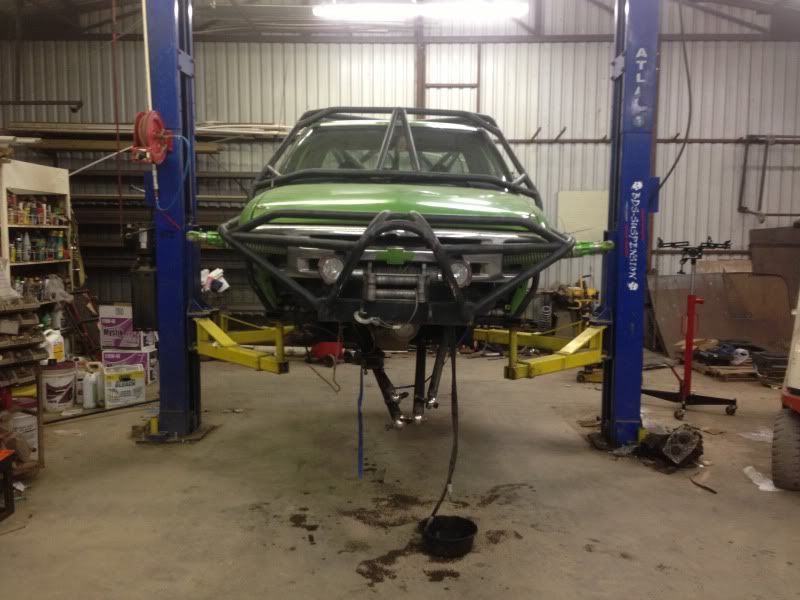

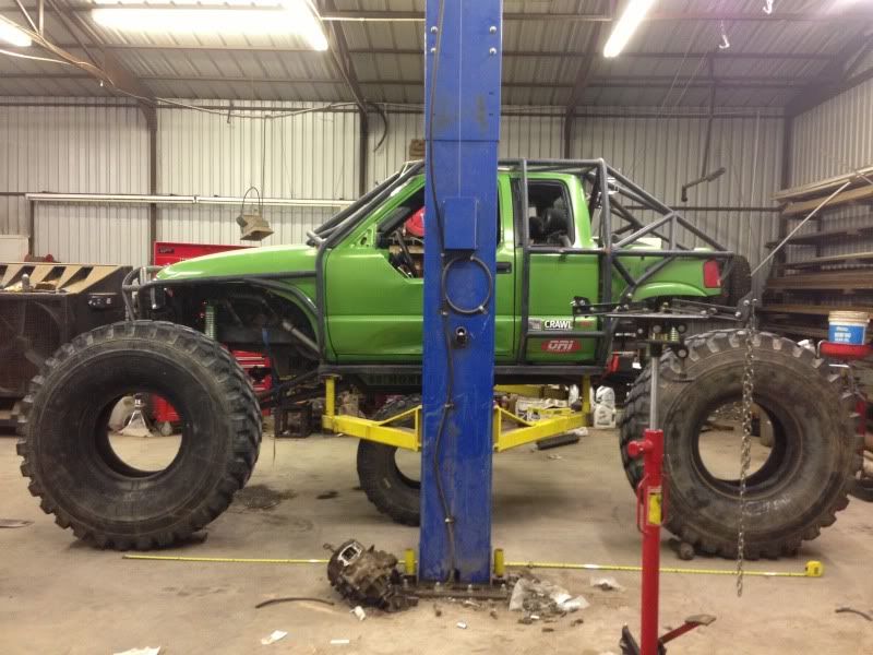

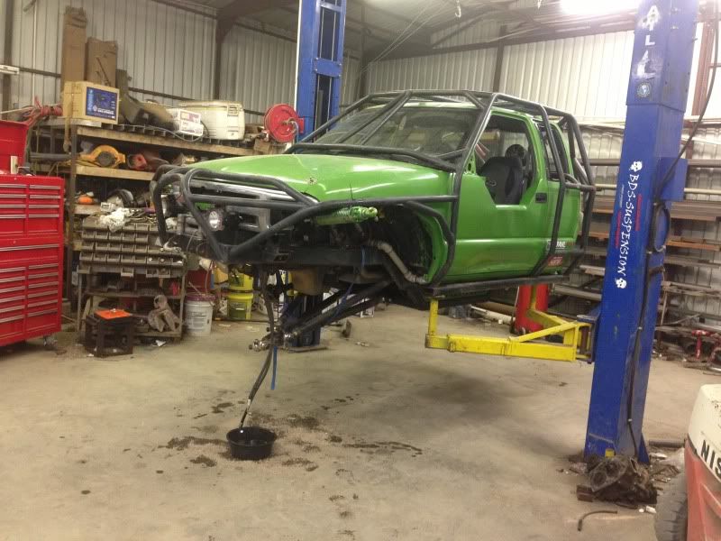

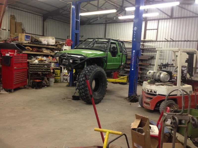

Well I got my stock Rockwells and 47s out and I'm waiting on my new 2.5/5ton hybrids!
I rolled the tires in tonight and did some measuring
137wb
33in belly
43 to the door
93 to the top of cage
Gonna be a big rig lol but it will be fun!
Has a supercharged 5.3,
I'm swapping stock 205 for a doubler kit with a lomax 205
I know xzl suck but can't swing mickeys right now
