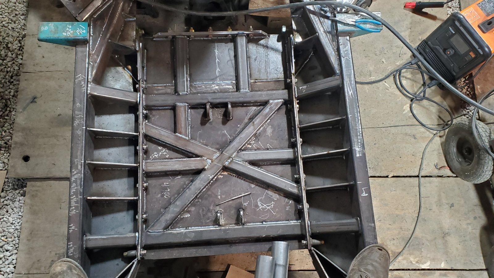

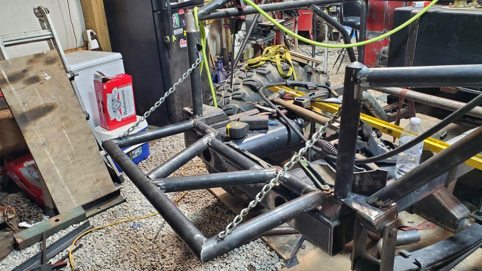

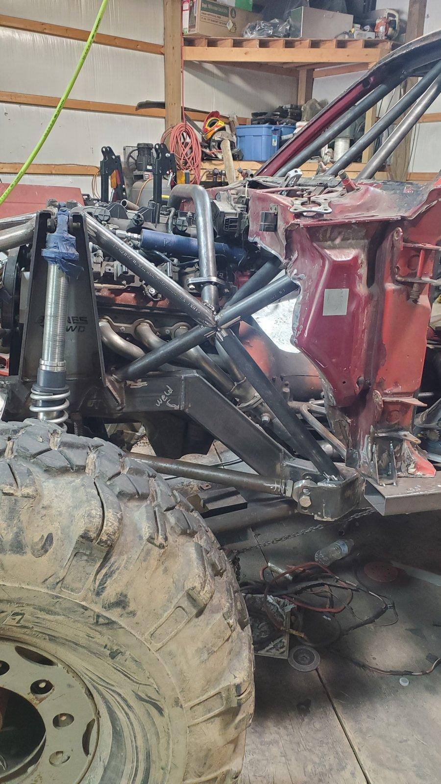

Worked on the belly pan, bottom center is .25" plate with .187 2x2" split in half for gussets sides are .187 plate tube mix up to the frame rails

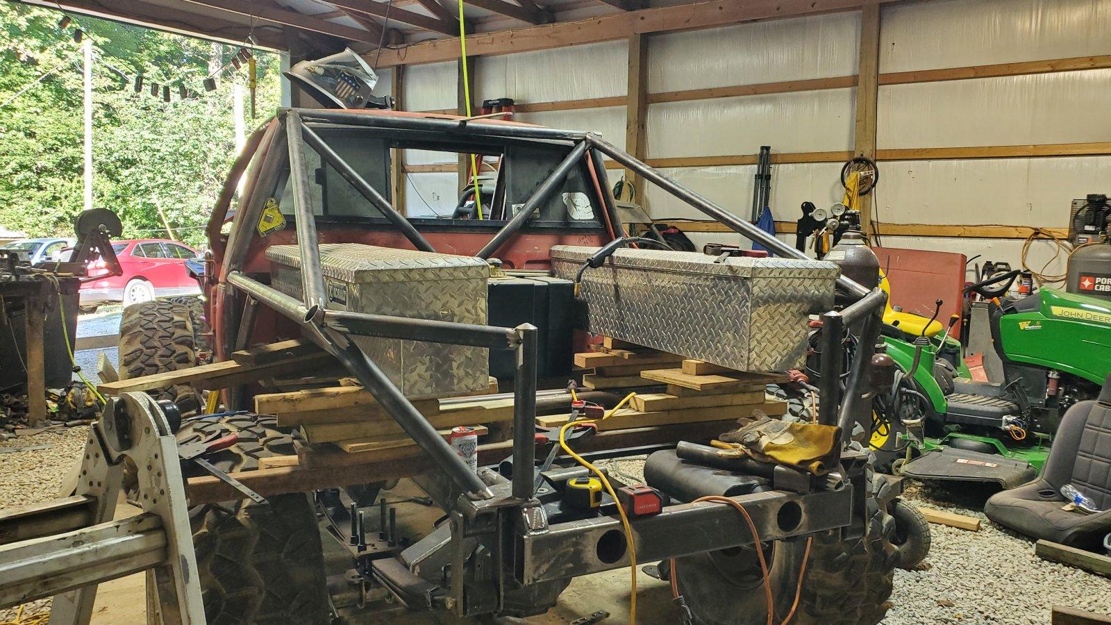

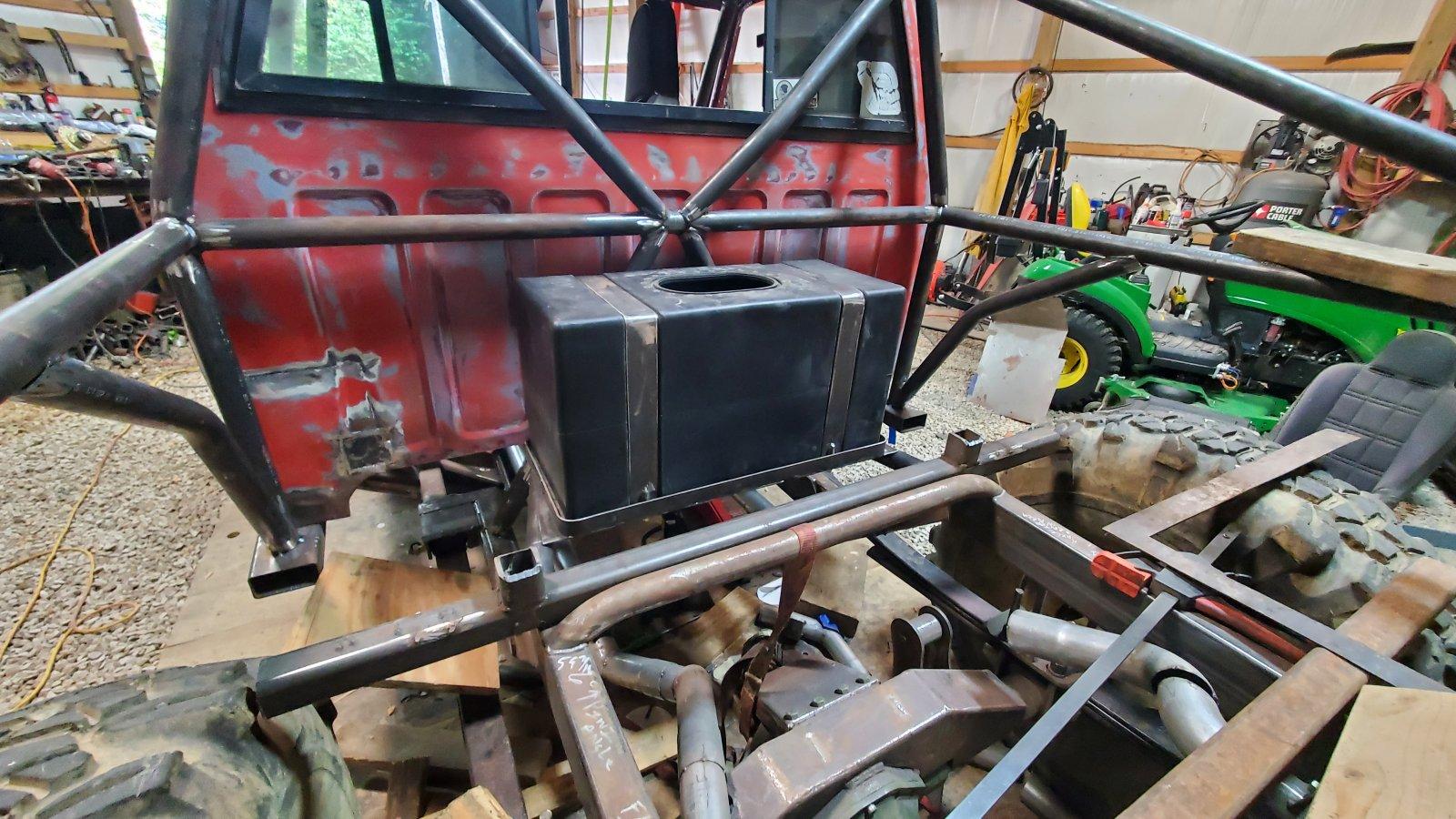

Got main parts of the boat sides in, will be adding more later, really wanted to see the cab sitting on it close to what I'm looking for

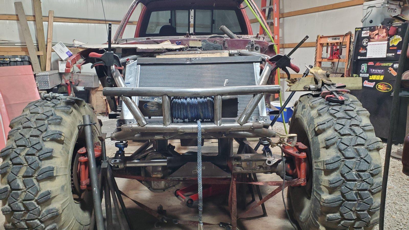

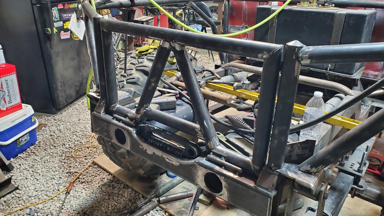

Finally made a decision on front mounted radiator, also redid the fro t frame winch mount, still undecided on my radiator mounting

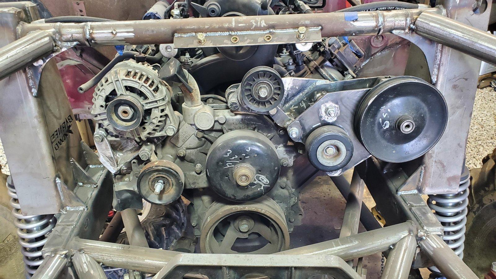

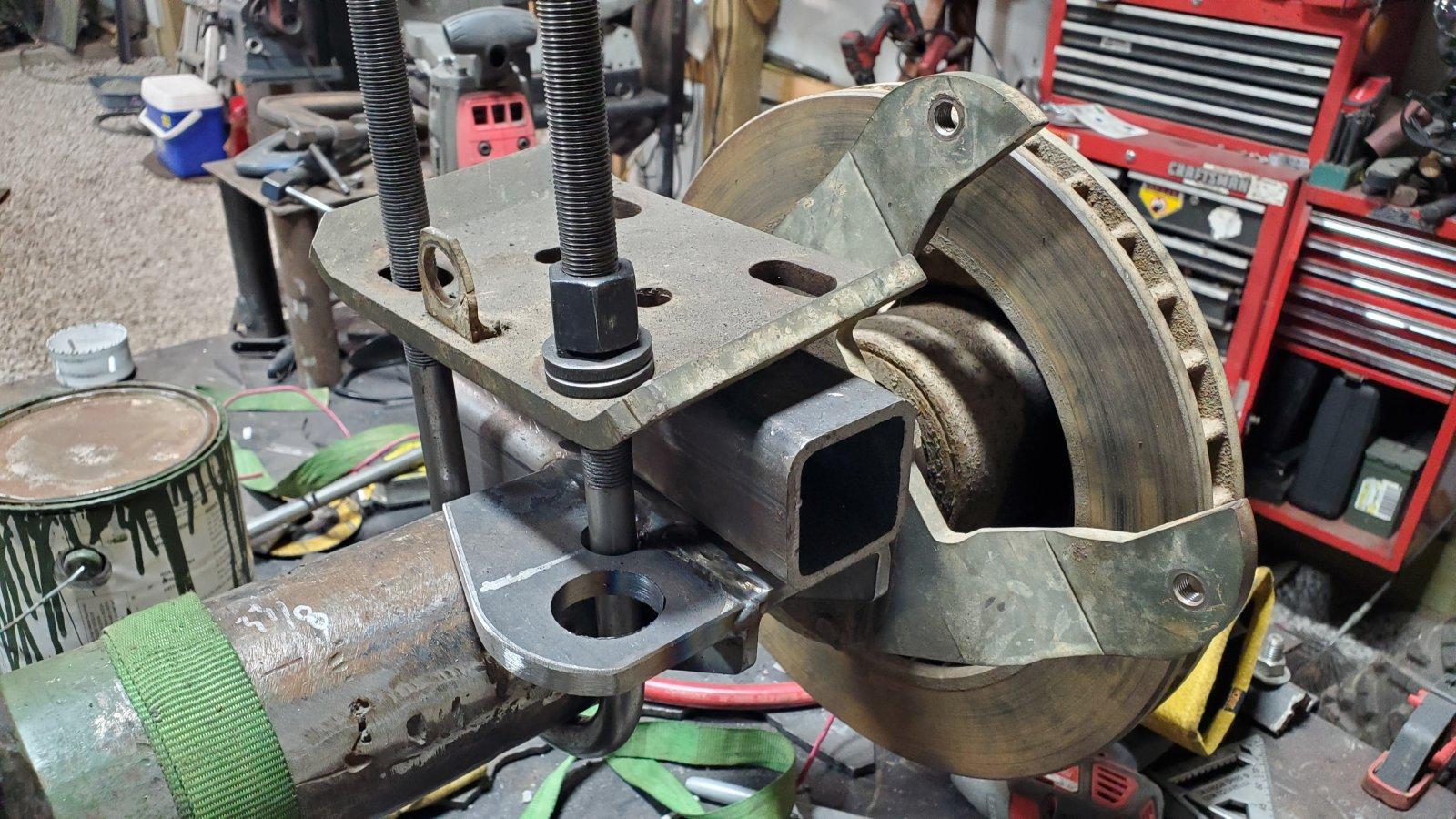

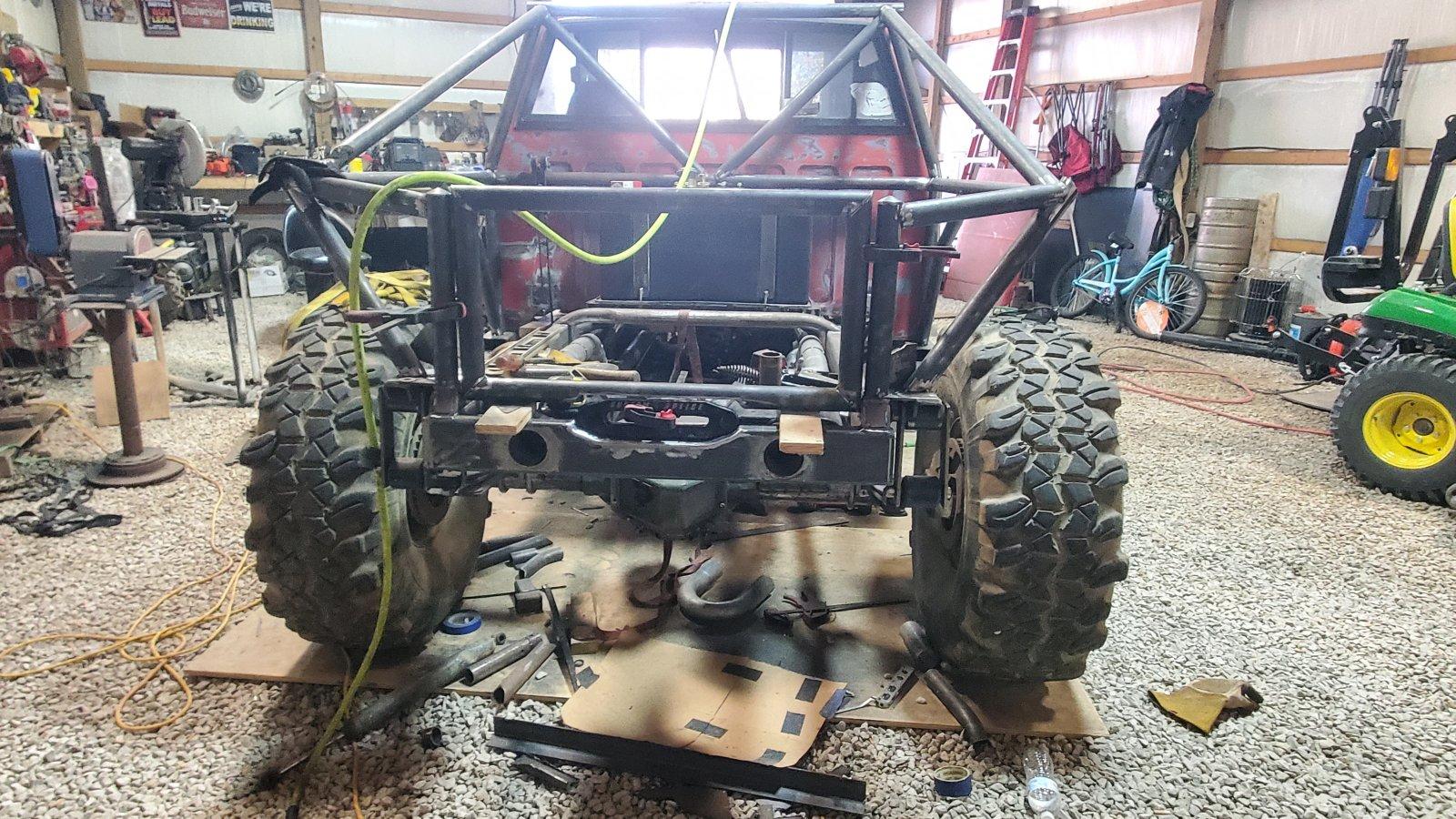

Built some accessories brackets, going to switch to ls1 pump with spacers, will be running the scotts performance pump. It might work won't know till it's running

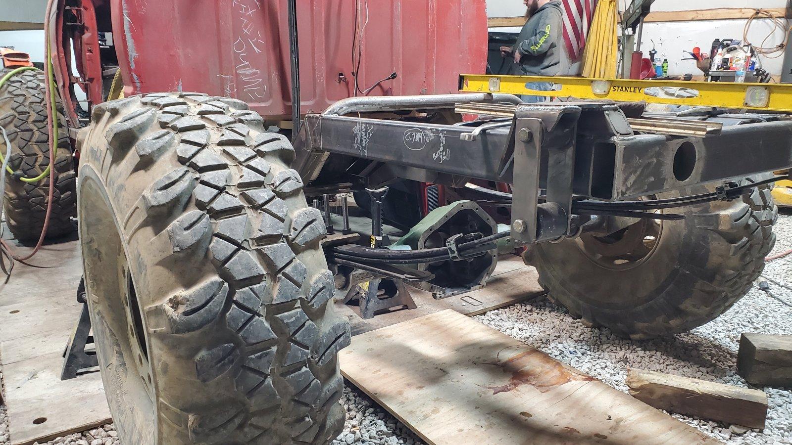

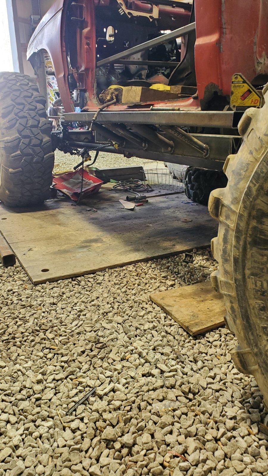

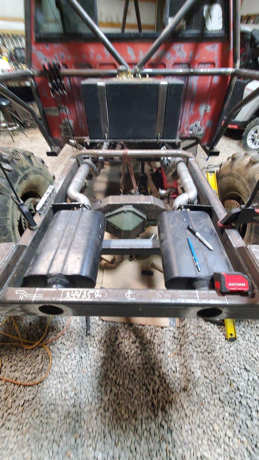

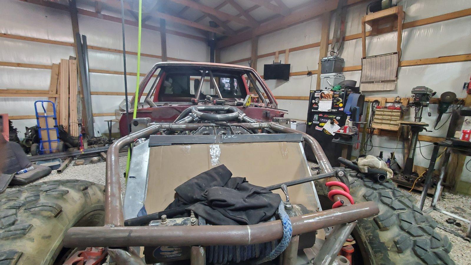

Had to change up rear frame section raised it 4" and moved it back 1.5" for axle clearance and better shackle angle

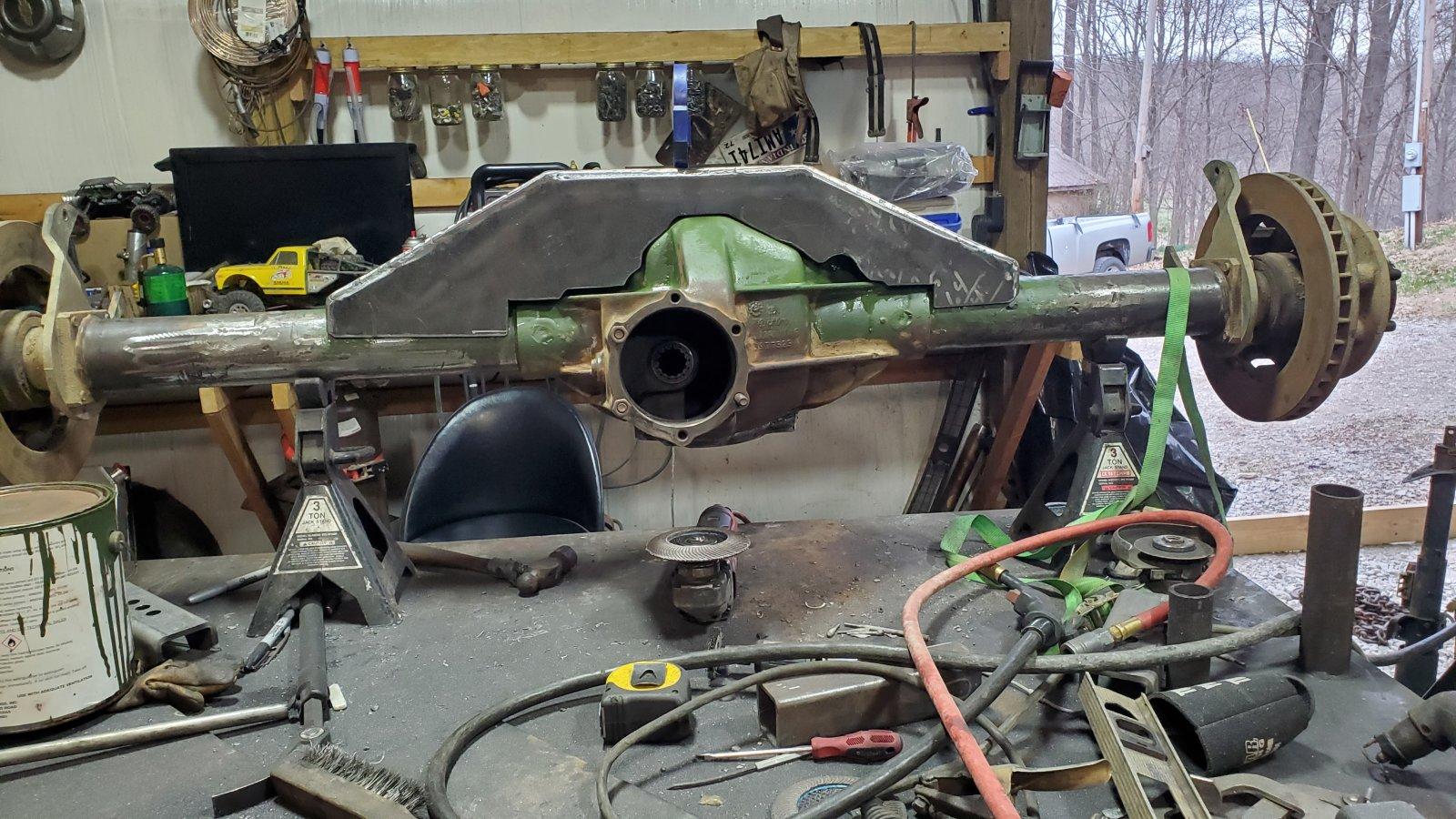

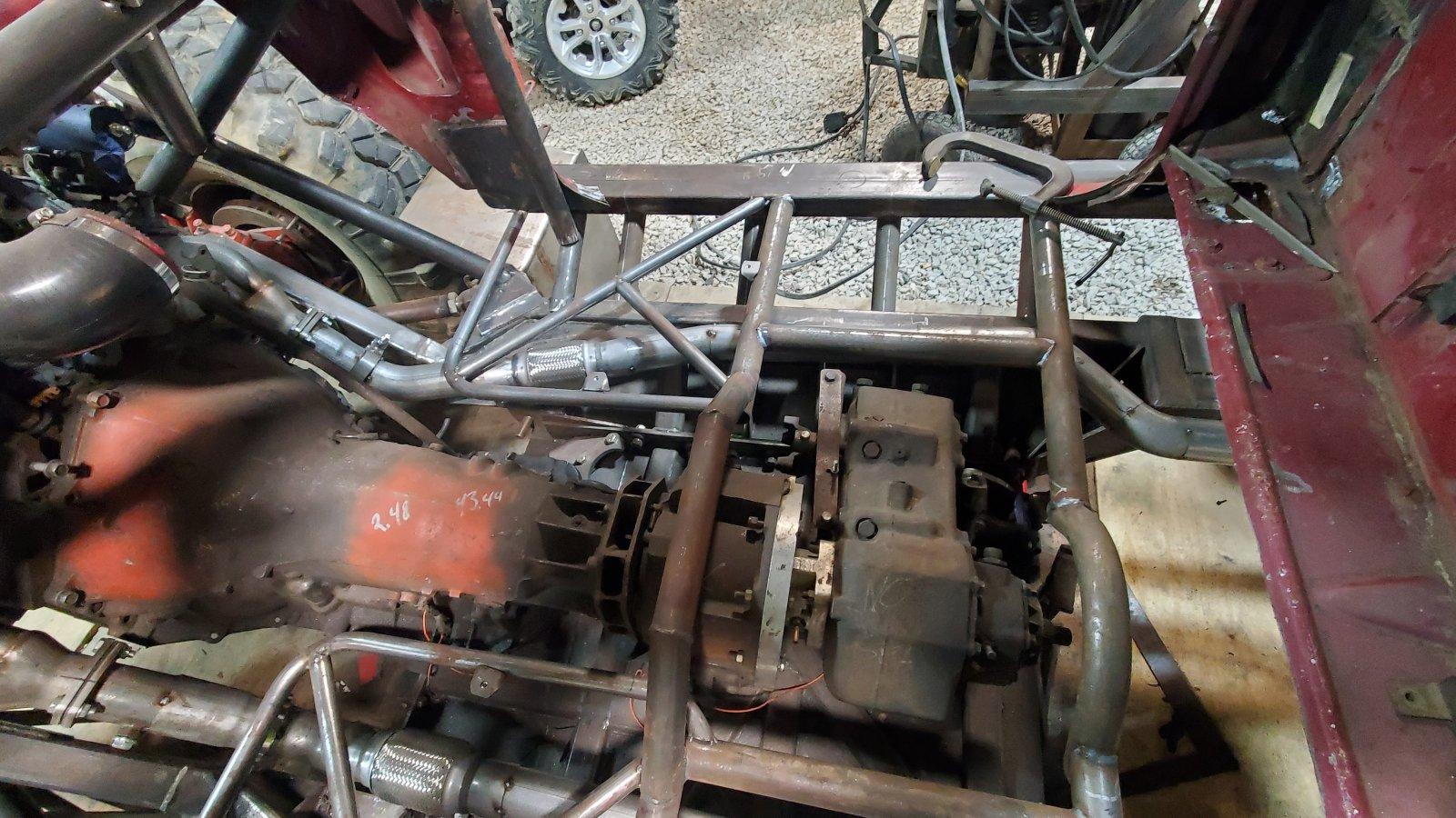

Built a truss for rear axle I'm still no sure I like it yet,might scrap it actually has a pinion tie in it just isn't in this pic

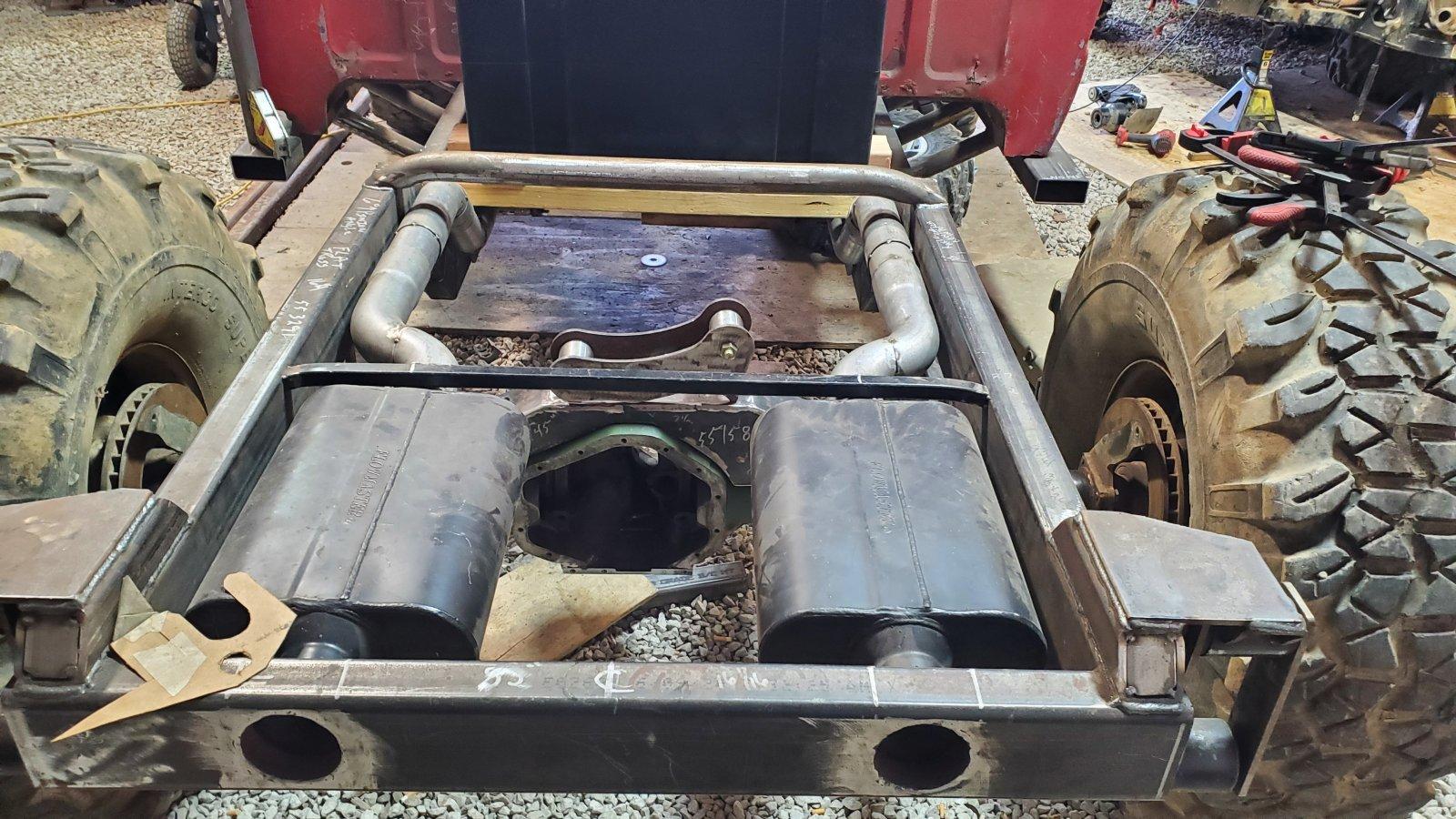

Started exhaust, but now have to redue some spots because of the before mentioned from change, dual 2.5" into old school Flowmaster, exiting through the rear bumper.
Wanting to put together dual master front and rear independent brake system, without using a cutter style hand brake. Looking at wilwood setup with balance bar removed, or bent fabs pedal assembly. Any thoughts on either
