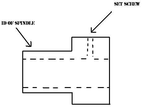

I've been doing some research on my ford external hubs and found that stock replacment parts are almost obsolete and aftermarket are weak and expensive. After asking around on PBB I was given the idea to make my own drive flanges. So here is the start on my "homemade" drive flages for my booty fab external hub dana 44. I should finish tomorow.

I was working on my drive flanges all day sunday I hope to get them done today. Here are a few progress pics. I think I'm going to buy one of those cheap instant garages so I can get more work done during this ****ty weather......I hate working outside. I plan to build a two car garage this spring/summer. I can't wait!
