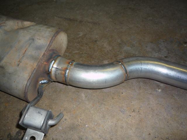

Ehausting Day

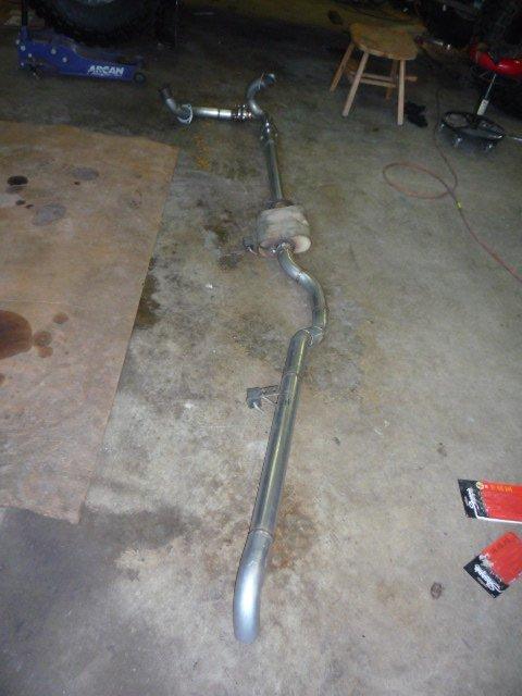

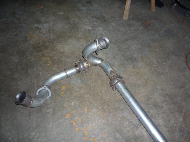

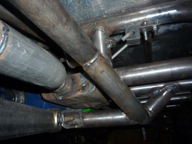

Made the exhaust today i need to add two more hangers to complete the trianges. the front is a busy little two piece Y pipe with two flanges with gaskets. Then a piece between the Y pipe, flanged to the muffler, and tailpipe assembly.
Thanks Doved85 for the welding job.

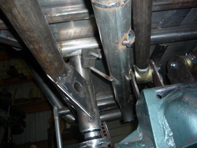

Fawking tried to weld my finger today redoing the rear hanger, i had put the weight on the springs and thought where i put the rear most hanger would be ok. well i checked today and then relocated it.:looser: it no longer hits the link bar at full stuff. but i can see its a good thing its only tacked as it needs to move about a inch outboard. Also made the piece to hold the radiator in place from the top. im hoping to photo engrave a bunch of original looking info on it.:awesomework: belt routing all the stuff from the original bezel on the donor blazer. shop logo and original MFR info from the whilly.

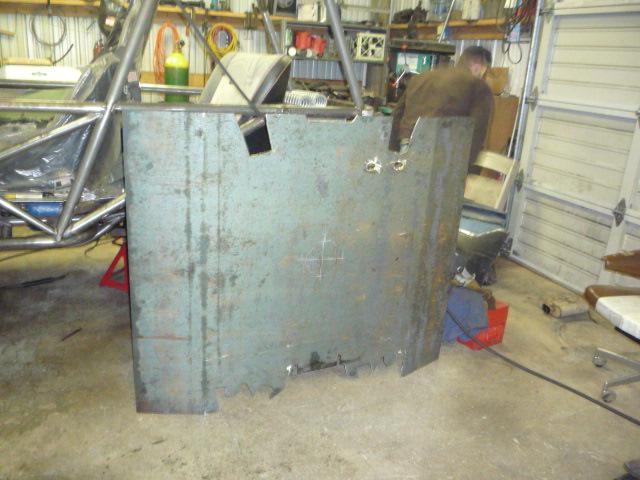

So i stripped the old layers of paint off the hood and painted it with a base coat of metalic dark grey.
moved the fuel cell over an 1/8 inch so its now perfectly centered. it looked centered before till i put the bump stops in and i realized an 1/8" gap on one side and a 3/8" gap on the other side, doh now they both have a 1/4':awesomework:
moved the rear exhaust hanger over an 1" or so.

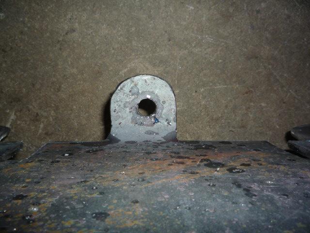

made the rest of the rear seat belt brackets.

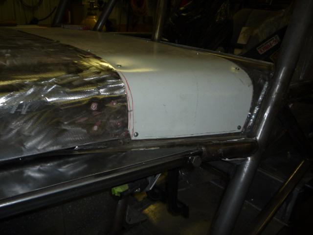

I'm thinking make the roof and all the tabs for that and im done.:cheer:
well worked saturday and changed the hot water heater in the house sunday. not much progress but some little things that needed to be finished.
like tapping the subframe for the sheetmetal floors.
making the cowl mount independently fromt the hood, they shared a few bolts before.
adding hood latches.
added the A pillar supports out of 1" .120 wall hrew.

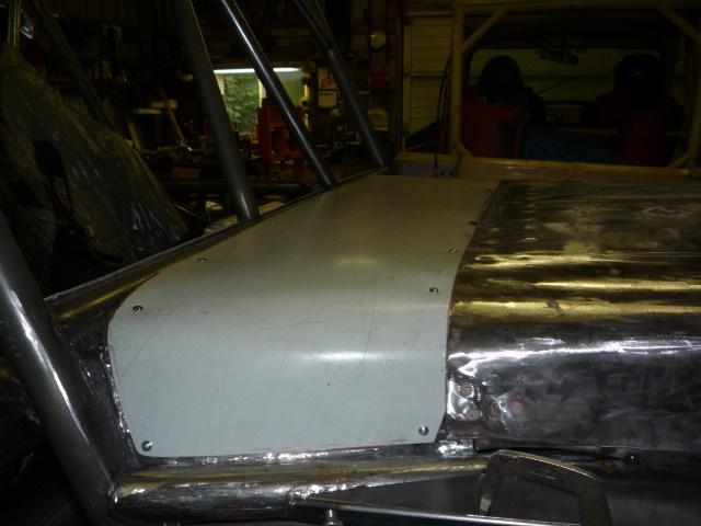

decided to completely redo the interior sheetmetal. making it one piece and much simpler.
roof is still to be done, i need to buy a new piece of .120 aluminium plate 50" by 60".

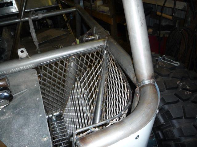

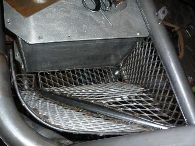

looks like time frame wise ill have to do the switch panels myself. i had posted some pictures before but they dissappeared. so some old and new progress. i actually made something today. kinda look like shrimp baskets.:haha:

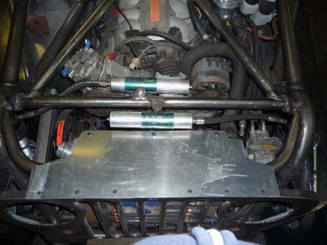

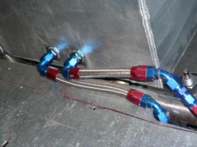

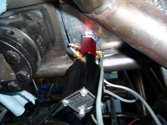

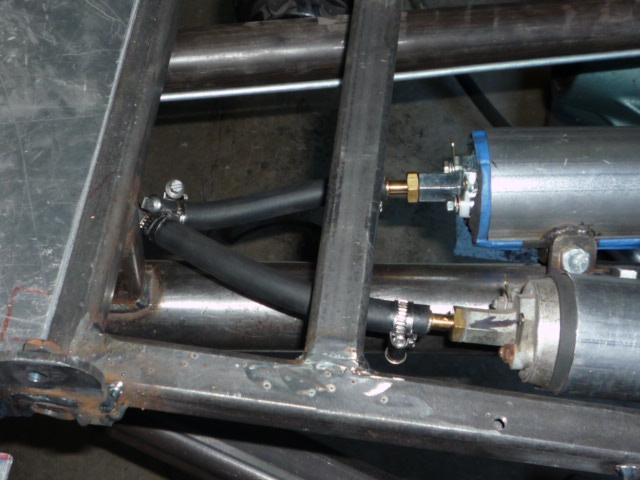

fuel system. three walbro pickps in the tanl so i should be able to get the last bit of fuel in all situations. extra fuel pump just cause i had two.:fawkdancesmiley:

the shrimp baskets.

With that fuel pump setup, are you not worried about back feeding?
I have heard with the higher pressure pumps, that to do the setup you have, you need check valves?
I may be totally wrong but hey I thought I would ask.:redneck:
:awesomework:Good work!
i believe these pumps have a check built right into the exit side. if not i will probably need some.

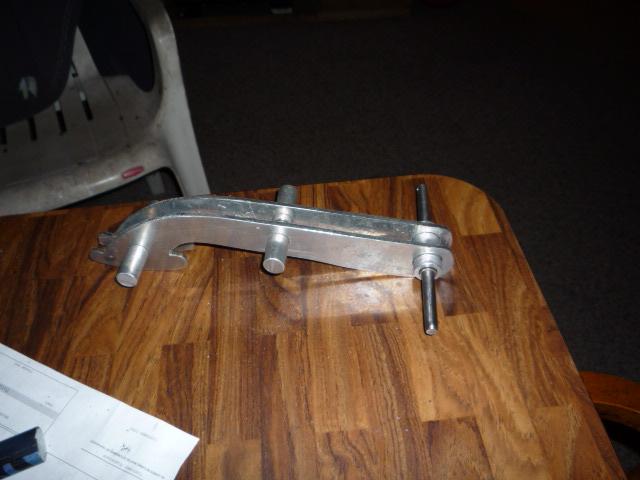

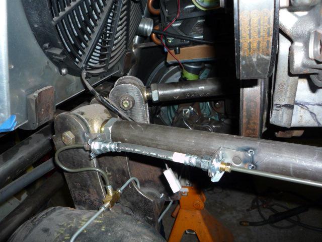

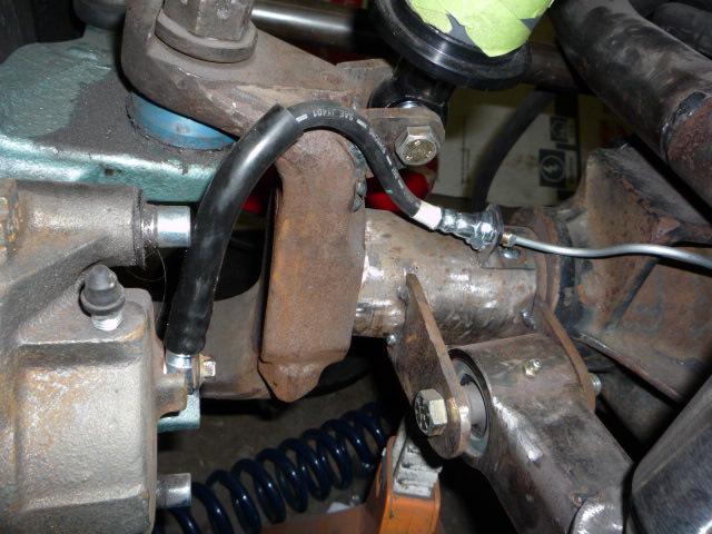

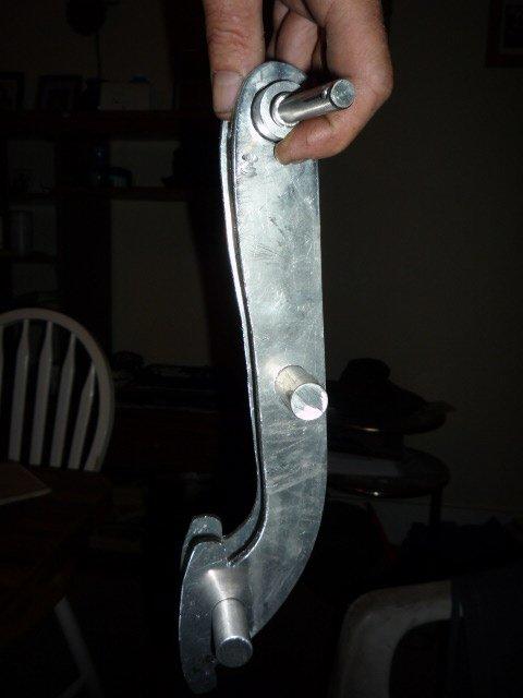

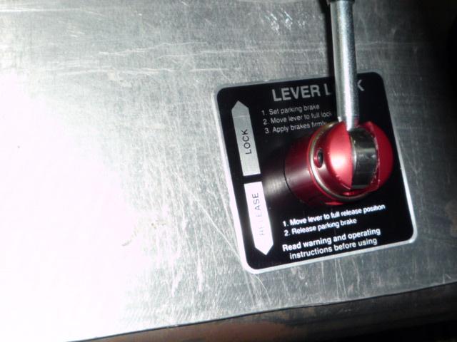

finnished off the shrimp baskets today and made the thrid pedal assembly so i can be legal. one pedal must operate all brakes:cool:
