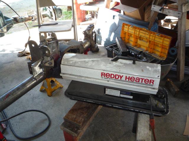

so its saturday ita all ready for welding up the front end with the heat for the ni-99 rod but nobody to weld it up...
anyone with ni-99 experience fell like helping call me.

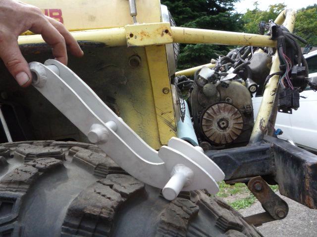

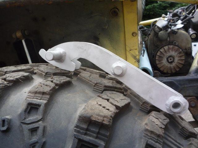

not a lot to post pictures of as im just burning in already fabbed parts and pieces. grinding out any flaws and getting the chassis ready for some paint. a few progres pictures. my third brake pedal.

did ya guys get your front 60 brackets all welded? i wanted to stop by today to check it out but ran out of time.

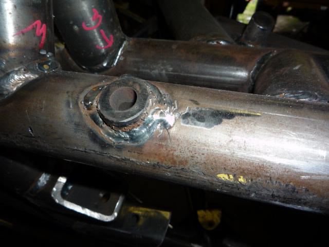

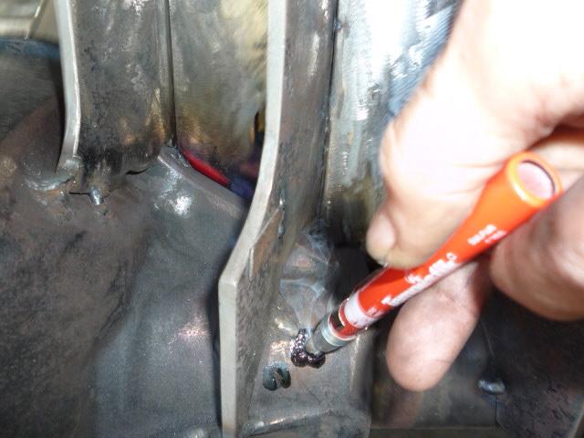

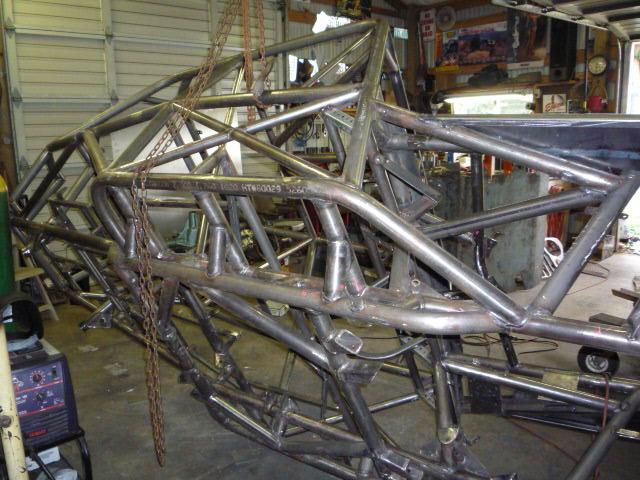

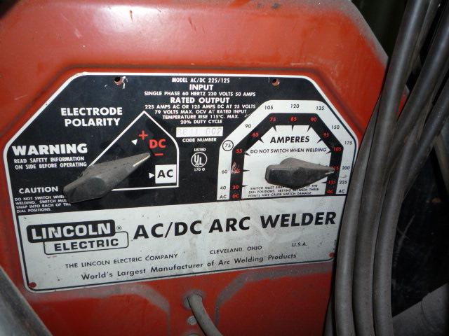

the start of the process. preheat to 600 Deg F for at least an hour, maintain heat while welding, beat the piss out of the face of the weld as it cools, grind out any defects and reweld, cool slowly over three hours. how hard could it be?
well its all done, and i did it all by myself so if it rips off i guess its nobodys fault but my own.:kiss:
set the welder to DC negative. went at it and im pretty proud how well it turned out.

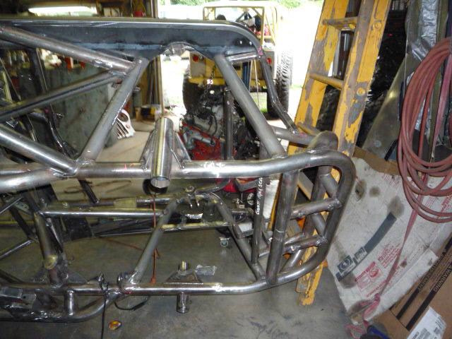

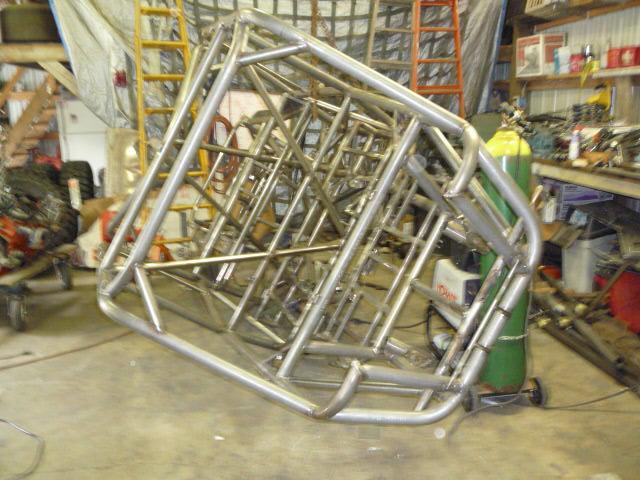

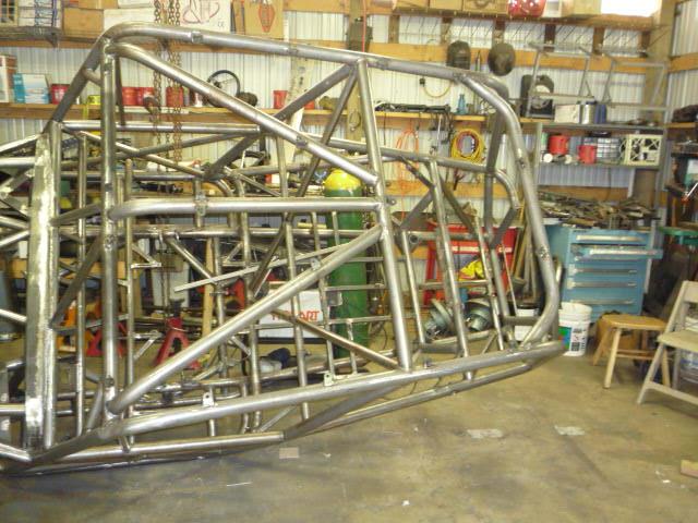

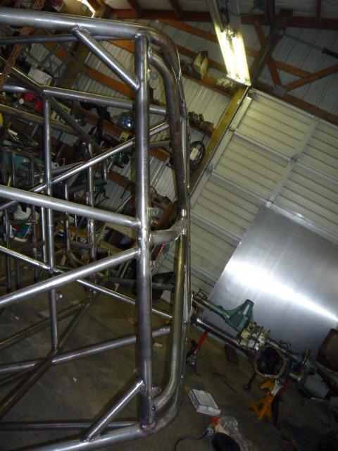

chassis is all welded up i believe. ive said that before and then found something to grind out and redo or a little area not welded...but this time i think i got it:awesomework:
ill let it sit and inspect and stripe coat "paint" each joint tomorrow with fresh eyes.:cool:

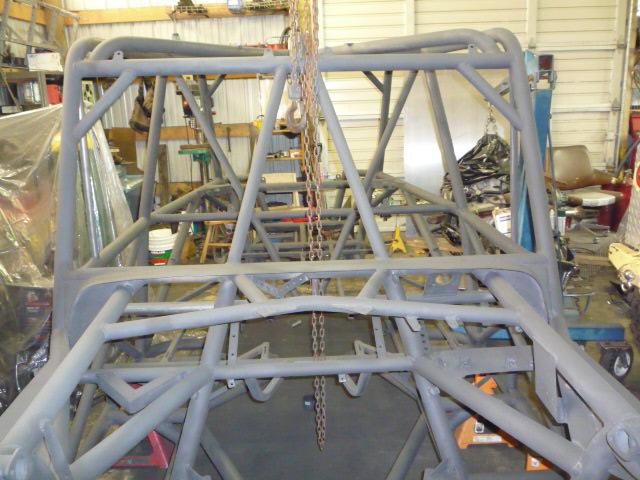

having this chainfall to lift and roll this thing has been a blessing.
11 of these little threaded bungs to mount the belly pan. all the roof tabs in place (Thanks Clark).
it passed inspection

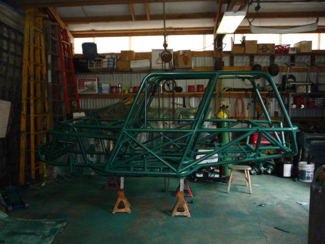

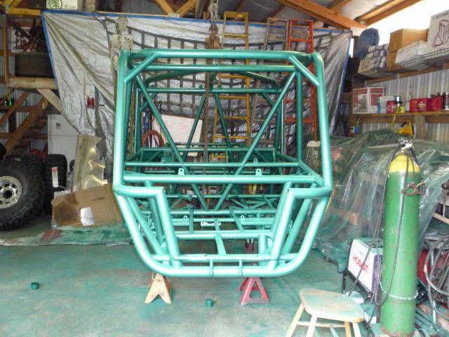

took lots of cans of paint, 13 primer and 13 top coat so 23 total on just the chassis, well and the floor since shooting round tube most of the paint goes into the air and falls on the ground.

welllllll i have been huffing a lot of paint lately, :; and the number is growing dailey as i find stuff not fully covered and or chipped up during assey.
i still have the hood, grill, and dash to paint....
