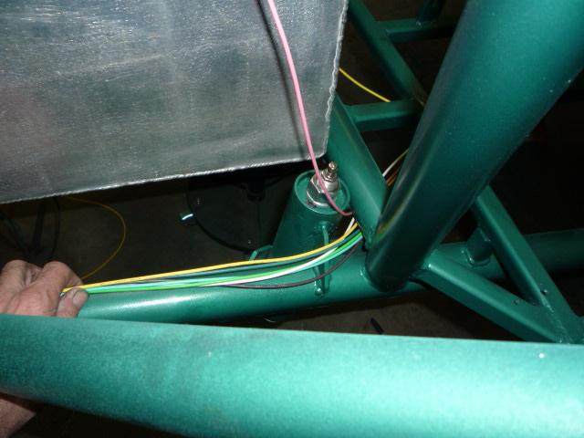

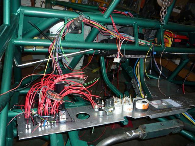

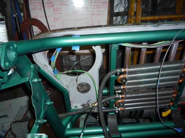

mounted the fuse block, routed the bundles of wires where they are gonna lay more or less.

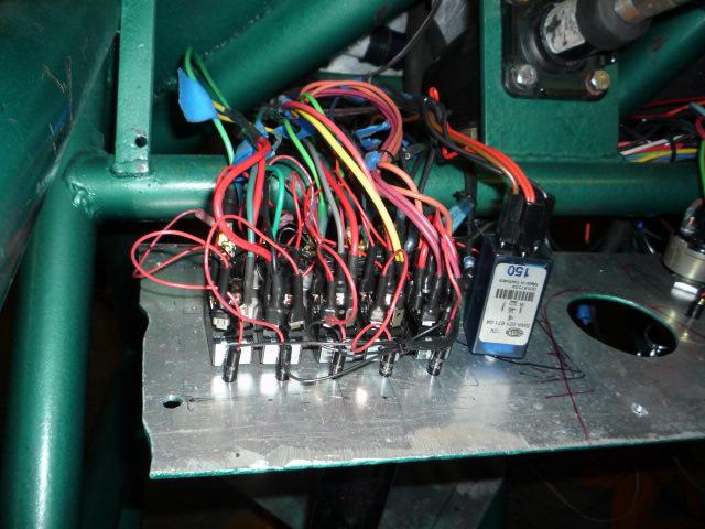

im gonna need to extend three wires as this harness was designed to mount the fuse block on the drivers side but that just wasn't happening.

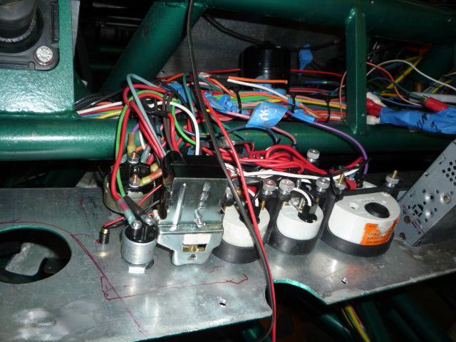

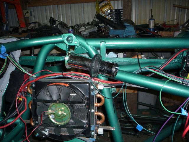

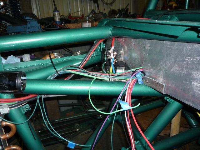

Thanks to Mikey i borrowed the set of crimpers needed to make these kinda crimps. now its mostly hooked up.:D
attachment.php
few things i havent figured out yet like turn signals. i dont have a switch but i layed all the wired for em.
when i honk the horn the AC comp ind light lights :eeek:
im gonna leave the loom unwrapped till i get it running as i still have to wire in the engine transition.
headlights dont have power but tail lights do:flipoff:
