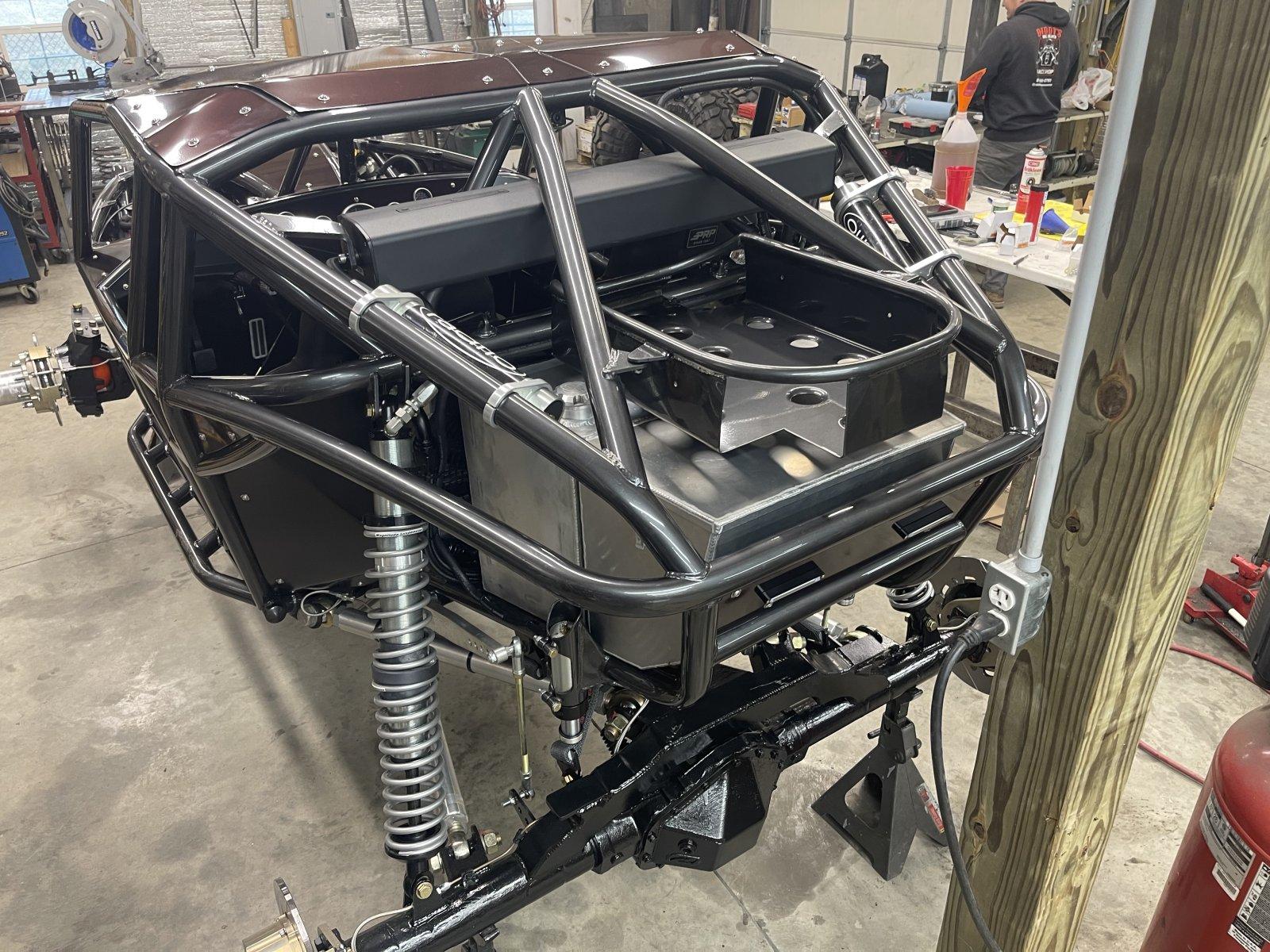

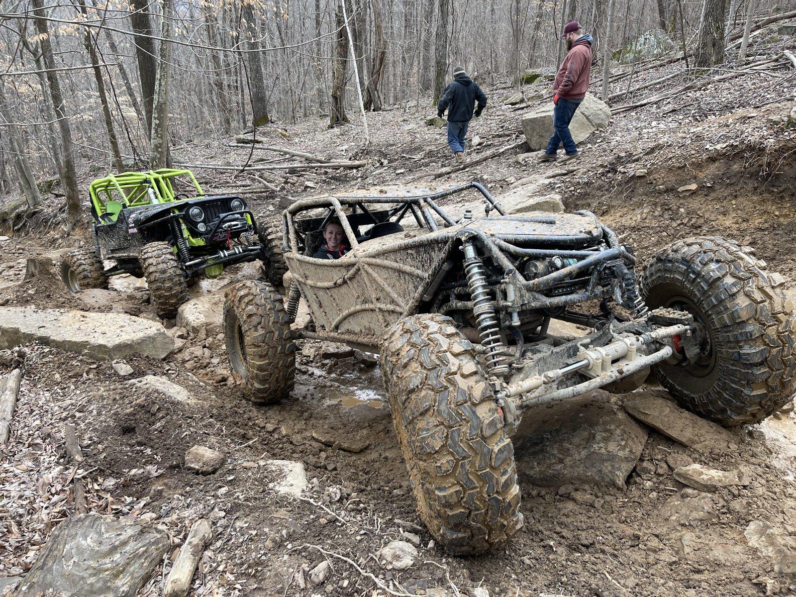

Buggy is looking good for sure. One question though, what is up with the short springs on top? I am sure the shock guru has something up his sleeve....
thank you
all shock and shock accessories were left up to east coast baby shock Jesus
if we need to make any adjustments or fine tune them down the road we can
It's standard set up. Rear has 14/16 b/c its a 14" shock. Front has 12/14 b/c its a 12" shock. Rear is soo light it's using 100/100 springs. Both ends have 1.5" of pre-load currently.

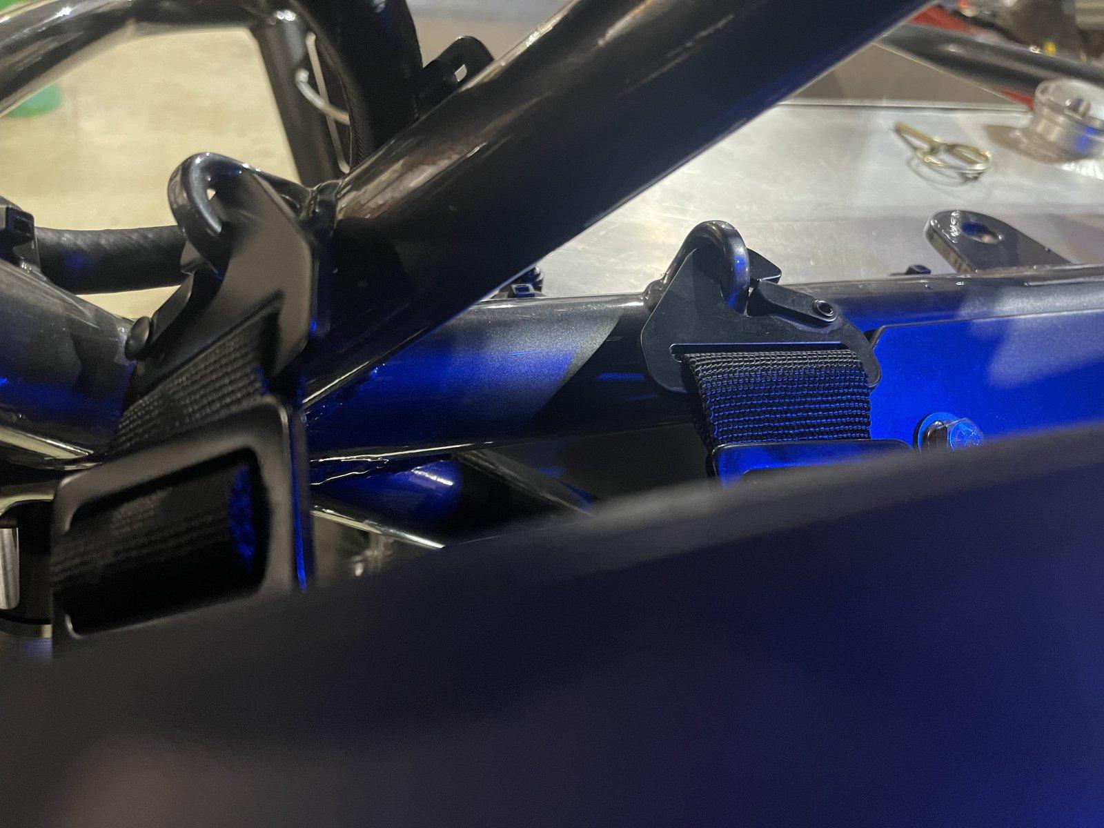

I’m really digging these clips for easy harness removal & cleaning.
these are what we used , they aren't terrible
https://www.armada-engineering.com/shop/fabrication/billet-weld-on-eyelets-4-pack-copy/
they also have a kit that looks like it includes everything
https://www.armada-engineering.com/shop/fabrication/billet-weld-on-eyelets-large-3-pack/
I got mine through Kartek
To take my lap belts currently i have to take the seats out. I could probably get away with swapping the shoulders out but the lap belts theres no way.

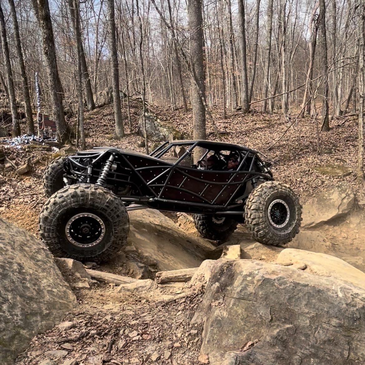

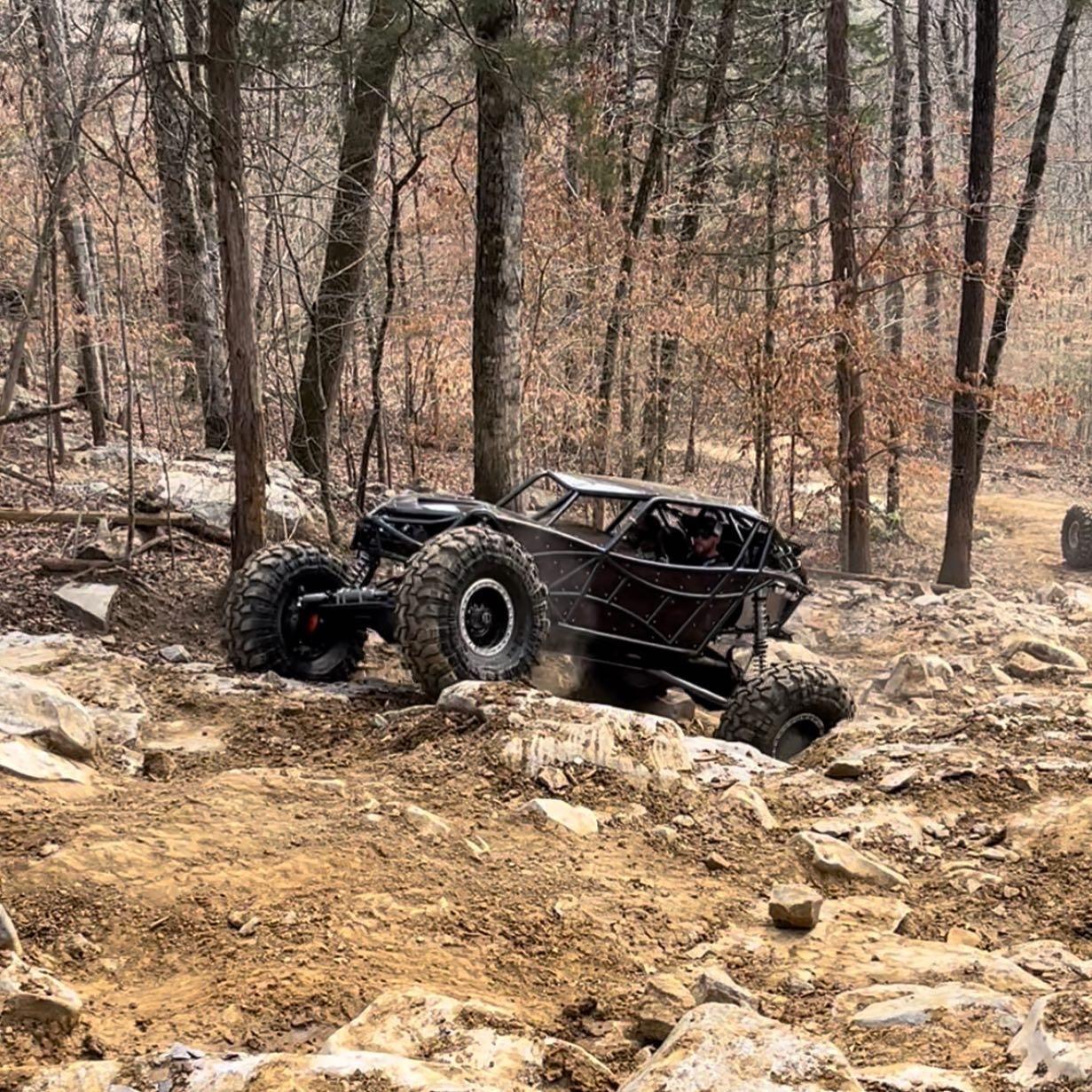

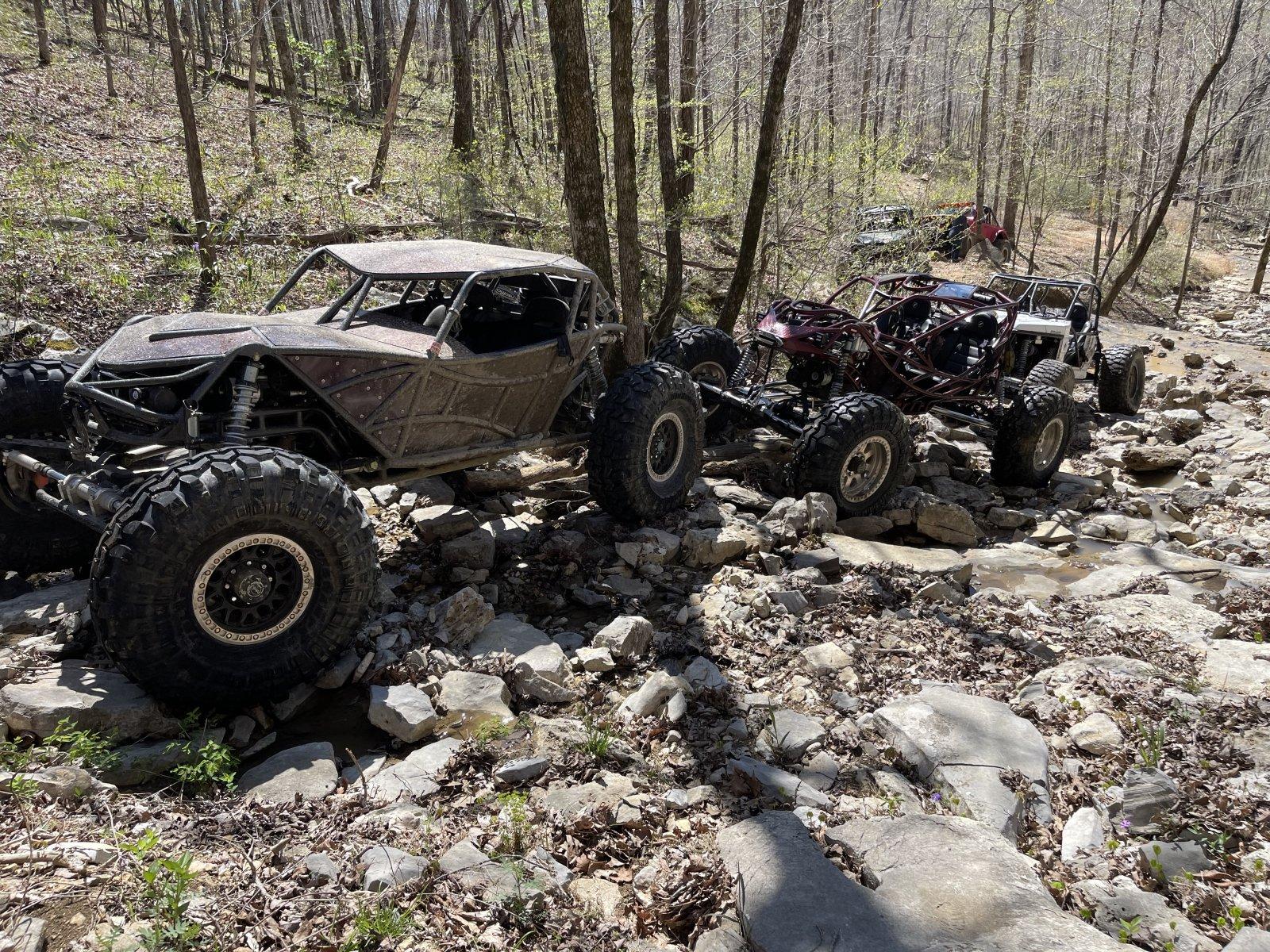

Took the buggy out all last weekend. I think most of the kinks are worked out of it now. Really starting to enjoy it for sure.

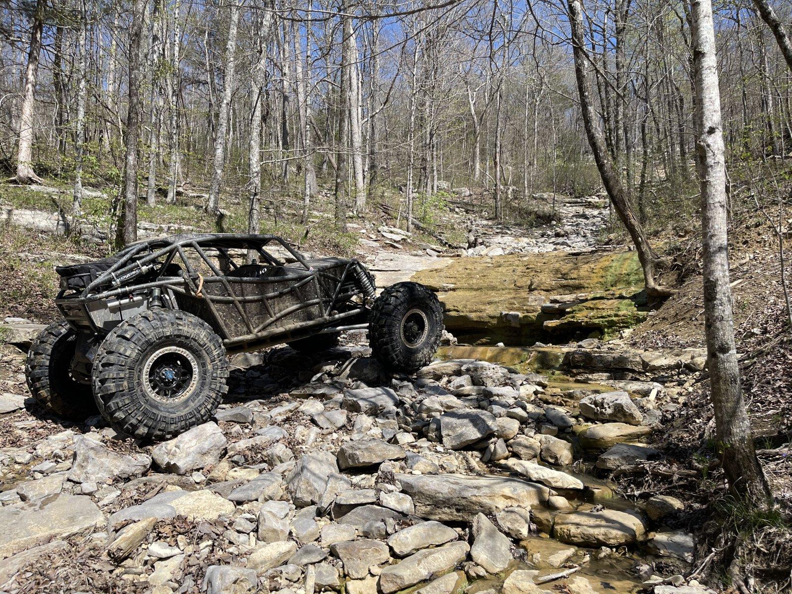

Took a little while to get it back to its rightful color, but she's tucked away nice and clean again.
