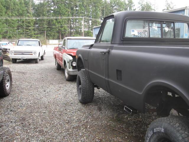

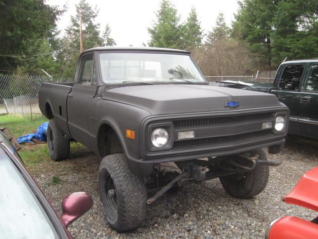

Since I miss driving the Stomper back in the ol days when it was on 40s, I figured this ol chevy that Kev had would be perfect.
I seen this truck in his add and fell in love. I have a soft place for 67 and 68 chevy trucks. I used to drive the ol stomper daily for years till it got 44s then it was no so fun to drive anymore. I miss driving that ol beast.
I figured this would be like "stomper II" hence the "Stomper Legend" play!! Seems bringing back old rigs is cool so here goes.
I have been daily driving this truck since the day after it got home here.
I have put quite a few miles on it so far. Its a little low geared for the freeway but it loves to drive everywhere else.
Here it the sweetness. (man she is purdy)
:cool:

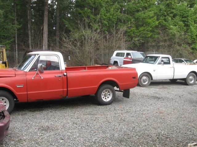

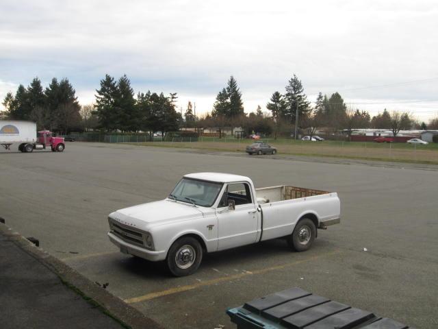

First thing I did was take it over to me friend Tom's shop to brag about my new jewel. Tom is a fine lover of these ol chevy trucks so the new rig felt right at home over at his place.
He wouldnt admit it but I knew he was jealous! :cheer:

Hey Kev, where are those pics you had in the for sale thread. I think you deleted the sale ad before I could save them.
Post them up in here if you could.
Hey unclestripey, ya got any old pics of it too? (there was allot of hippy stickers on that badboy, know anything about that?)

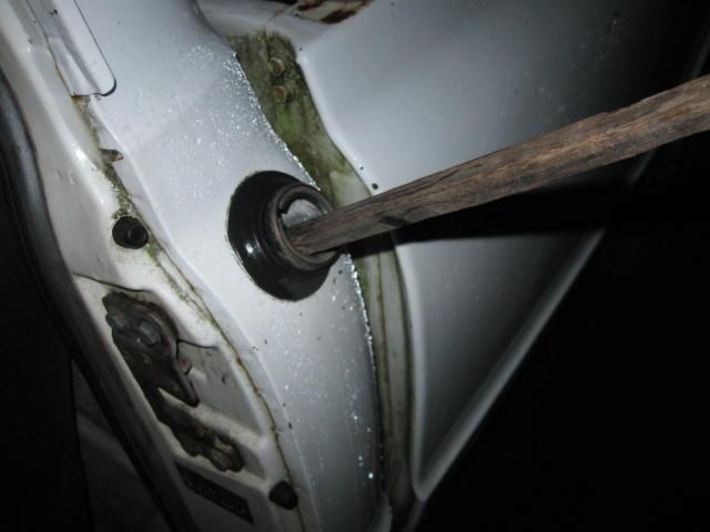

I had a hard time getting the ol lady to go to dinner with me cuz the heater didnt work.
So I got the controls wired up and working smoothly and then replaced the heater core. I had to remove the inner fender and hood hinge to get it out. Cleaned all the firewall passages out and put a pair of new heater hoses on it too.

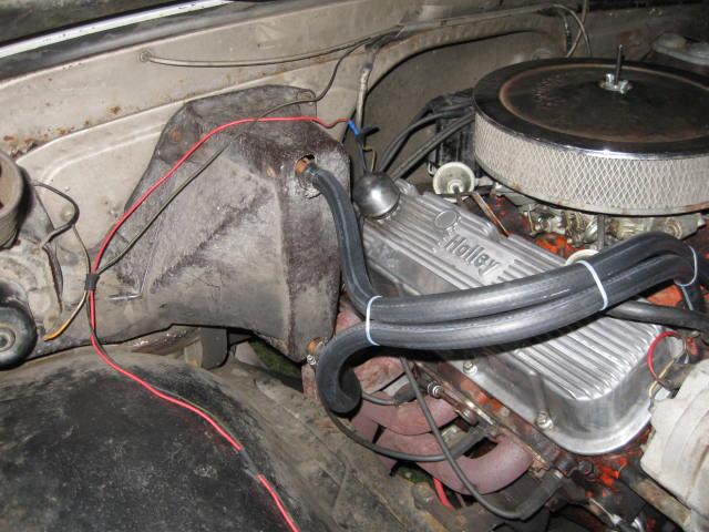

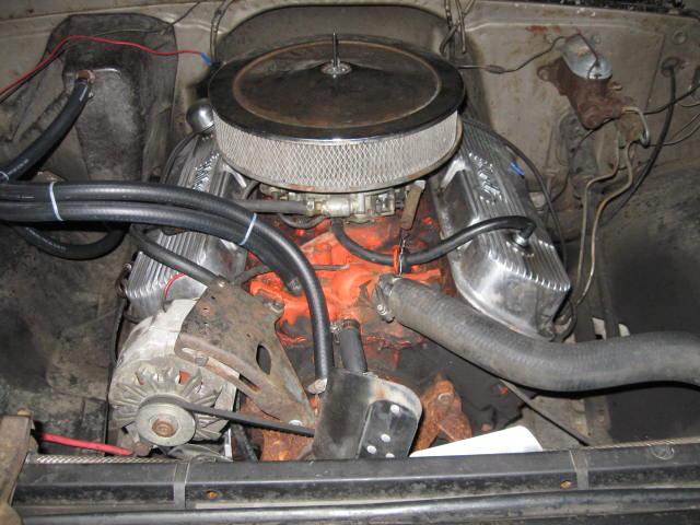

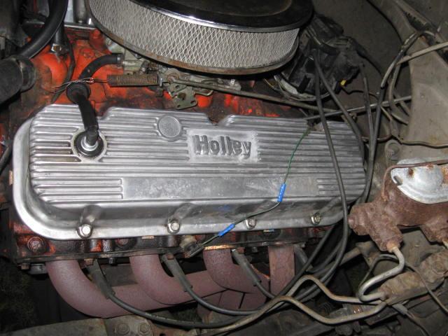

I started hitting my ol crusty chevy buddies and got a pair of baddass Holley valve covers off of the old dragboat. Said he couldnt run them anymore cuz he had a stud girdle now and they were too short.
While I had the valve covers off I wrote down the casting number and casting date so I could run them later.
Got the new covers and gaskets on and almost wanked on to it. :masturbanana[1]:
Then I ran the numbers. Kevin had told me it had a 454 but after looking up the numbers I think different. The heads were cat in middle 1971 and are listed as 396/402 heads. No 396s were actually made in 71, only 402s. It has early oval port heads too. All the evidence is pointing at it being a 402. :cheer:

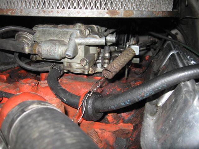

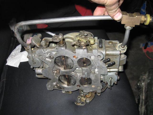

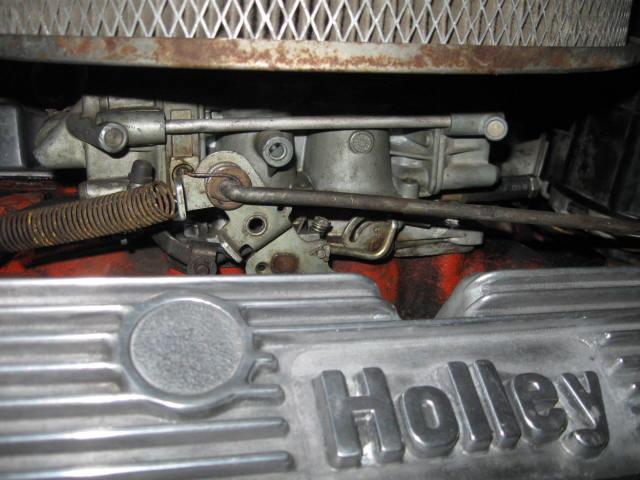

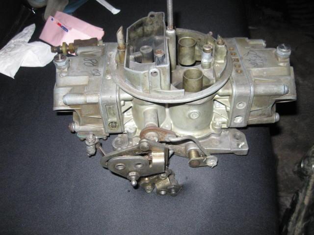

I tried to fix the first edelbrock carb.
I installed and tried to fix the second edelbrock carb. Was a little better but still sucked.
Then I found an old Holley carb I had been lugging around for ages. I pulled it out of its five gallon bucket and stated cleaning it off. Blew it out and fur went everywhere. Turns out it had a rotten rodent trapped under the secondary venturi.
I got it all mounted up and tuned in and now it burns out. :awesomework:
But if ya stabbed it long enough to have the vacuum secondaries open up then it would idle high after stopping till ya shut it off and let the vacuum go away and then the secondaries close all the way and then it would idle perfect again when restarted. I farted with it and put a new diaphram in it and no dice.

Then while I asked a few friends about fixing it and such, one of them mentioned he had a 750 spreadbore double pumper, mechanical secondary Holley for $80. I was all over it like stink on ****.
I am waiting to put it on till I can find a nice aluminum intake manifold.
