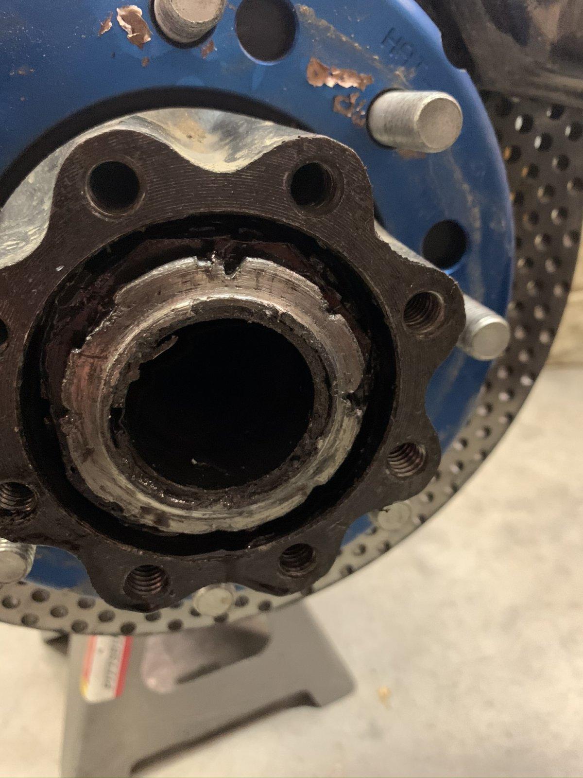

Just before that video I had tried it and didn’t make it, apparently when I slid back the right side upper link tower started bending. If you look close as I’m pulling up to the waterfall the link tower is already bent a little bit. Then when I hammered it and bounced it folded up. That caused the whole axle to shift left several inches and the driveshaft actually hit my engine skid and snapped the pinion shaft off.
Thankfully I have good friends that helped me get it off the waterfall and thankfully it happened where it did. I was able to go get my truck and trailer and drive right to it to load it up.
It was just a failure on my part to gusset the link mount properly. It was just too tall without enough support. Since the housing was already a little warped to begin with and I’ll have to cut so much off to fix the link tower I’m going to replace it with an aftermarket housing using all my parts from this one. I actually found a Trail Gear housing on Facebook today and made a deal on it. It may be a little slow, but I will fix it and it will be back better than before
