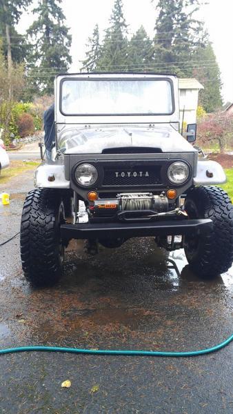

A few things noticed. Brake line is just right. Sliders and fender are hitting not allowing things to line up..easy fix..rake some off the sliders. On to a more difficult decision..a monumental one at that..where do I put the signal lights (and yes I have amber ones)
Went old school, not perfect but they came out okay once I took them apart and cleaned/painted them how I wanted them. Most of the soft rubber grommets were long gone so reassembly is missing those. Just a quick post of one of them going back together.
Not exactly happy with the gap between the fender and the apron, but hey its a wheeler and not a show truck. Pretty much testfitting everything now for fit, wire length, grounds etc. Fender is not bolted to the front bib yet either. Once I am happy it will all come back apart for the final rattle can paint job.
Too late, but this is what my buddy did with his. I think they are for a motorcycle??
I like it and have never really liked what Toyota did. Always looked like it was an after thought to me.
I like it, but something about a classic I guess..even if it was an after thought.
