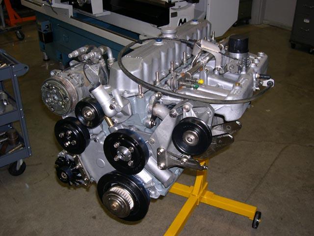

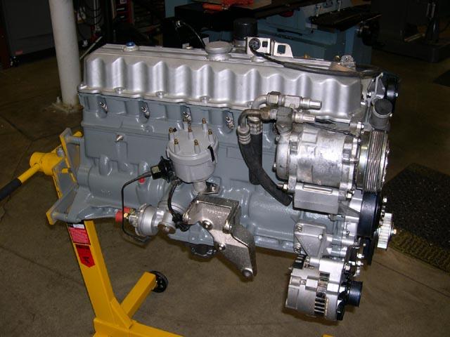

LPG Stroker Motor Pics
Only 3 days lag :looser:

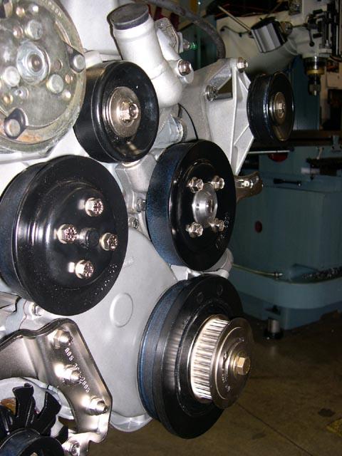

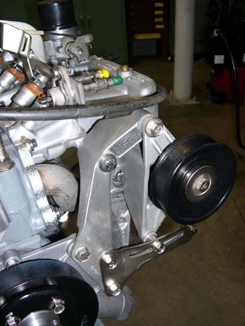

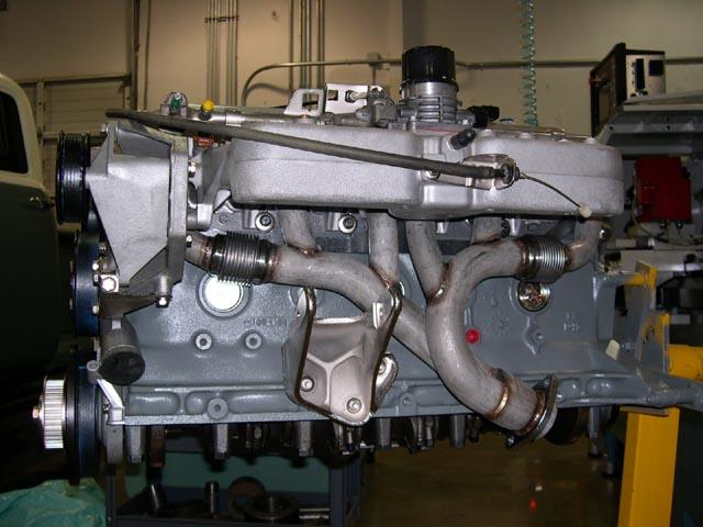

This is what I have going under the hood - jeep six .040 over with 258 crank and rods - .060 off the top of the block to bring the quench back...
Everything has been balanced within 0.1 grams...
The gilmer (cog) belt drives off a hub that picks up the extra .420" of crank snout from the 258 crank and also uses 3 5/16" countersunk allen screws in the puller holes of the damper... Then I used a longer AN -8 bolt for the damper bolt to hold it all together
SInce I am using an external hydraulic pump I did not want the OEM p/s pump - so what you see is a factory part - just impossible to find; the tensioner blocks came on YJ's with manual steering (lots of those running around; huh!) :rolleyes:
And if you cant tell I got a bit carried away with the electroless nickel plating
Enjoy
Matt

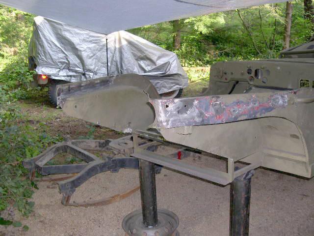

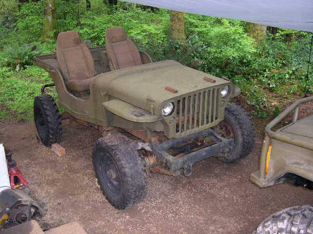

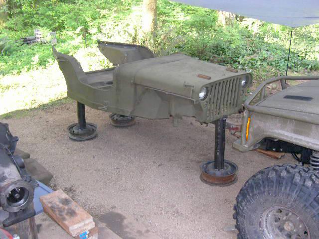

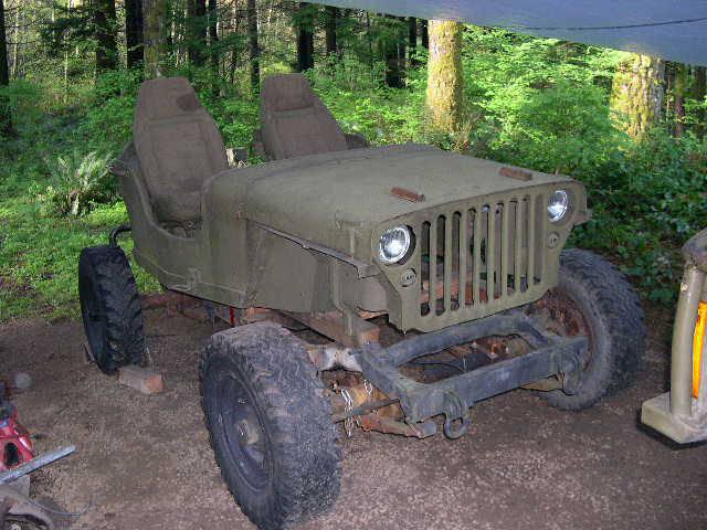

War-Jeeper said:
That thing is sick! I see some of it that even resembles my rig!!! What did you start out with originally?
I had done a bunch of work to what is in these pics but all the other pics are hard copy - I will try and find the original photos when I bought it...
This was when the project went from the bland 1 ton running gear and 38's planned to full tilt rockwell/53's/4 wheel steer...
Matt
