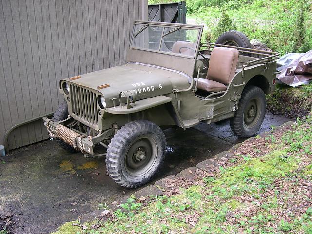

Not much in willys land; the auto transmission for the crawler is supposed to be done some time this week - I took a bit of a break from the big one to finish off the stocker I have - re-built both axles, trans and t-case - motor is bare block and going to the machine shop this week once new pistons get here...

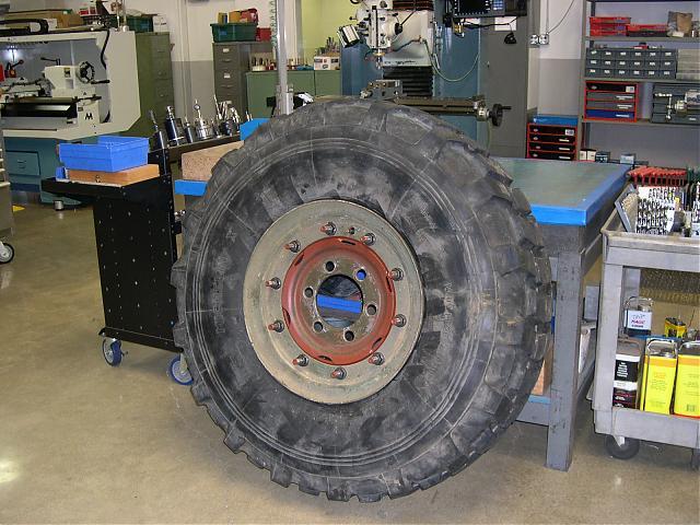

Plus I have been recentering wheels for my duece... going form 37" NDT's to 48" Michelin Xl's...

I don't think I have any from the back - yep I reused the centers from a set of split ring wheels and machined the 10 bolt budd out of the 5 ton combat rim with a step machined in it - then just turned the same step in the split centers - bang together (0.001-0.003" press fit) and weld...
