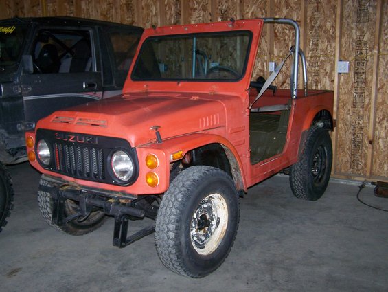

I decided to take a slightly different approach this time, and build a forklift...er...forkloader. :redneck: It hangs from the original LJ shackle hangers, with sami poly bushings.
The dropdowns are 2.5" square tube, with a 1.5" pipe crossmember, and the forks are 1.5" x 3" 3/16" wall. The heaviest I will likely be lifting with it is a tintop sami tub. (yeah, there's a whole lot of :redneck: in this post.)
SO, on to some pics.
Welding the hanger tabs on the dropdowns
Tabs on and crossmember in.
Dropdown hanging from oe shackle hanger.
Forks attached.
Assembly attached to the LJ. The overall angle of the forks was found after a little messing around with a clamp and straightedge, to be sort of a happy medium between being flat at ground height, and being vertical at max lift. If I'd have made them flat at ground level, they'd be sticking straight up at max lift, which would dump whatever I'm lifting on the hood... So I went with level being at about trailer height, to aid in loading axles and such on my trailer when it comes time to store things elsewhere. I can alway run a strap around the backboard to get things lifted from the ground. Ideally, I would have liked to build some scissor folding contraption to keep the forks level at all heights, but time is running out, so this will work.
I still have a bit more to do to it. I'm going to add a couple more crossmembers, one at the joint, and one at the base of the forks. The furthest one forward will be the attachment for the winch hook. I'm also thinking of ideas for the mounting of a moveable backstop, which will keep things from sliding back on the forks when lifted.
I also may recut the tips of the forks, I cut them with the tops short, and planned on capping them, but I'm thinking to cut the bottoms short would provide a better chance of slipping under things.

That's part of the reason I went with forks this time, I had wanted to make attachments for the old stinger, but knowing it wasn't up to the task, I never bothered. With the forks, I can have two attachment points rather than just one on the stinger.
I had planned to build a blade scraper for snow, gravel,and light dirtwork, but I like the idea of the bucket. I've been watching alot of youtube videos on homemade mini excavators, log loaders, and such, and getting ideas for future attachments as well.
Love the fork lift set up! That could come in handy alot. I think cutting the fork tips from the bottom would help for things on the ground but cutting from the top would help with picking things up off a trailer. The backstop idea is good and I would set it to keep things from sliding into the winch cable.
:kissmybutt:
That was my first thought with the angle. The forks wouldnt want to dig in as much if the were cut the other way, from my logic.
