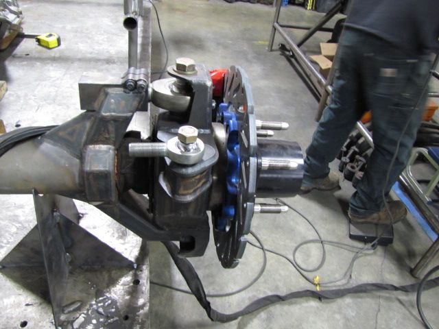

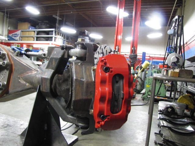

I'm surprised more people arent making their own plate knuckles and C's.
ala these....
ala these....
HOWEVER to get set up to make the jigs and do all the research for one or two sets makes it a TON of work and money. I THINK that is why most of the guys you see making knuckles are manufactures with intentions for re-sale.
