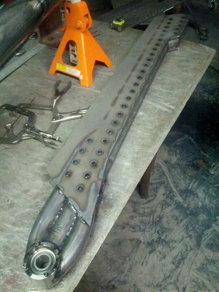

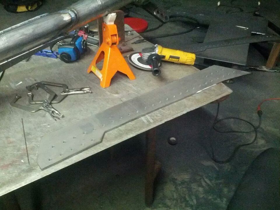

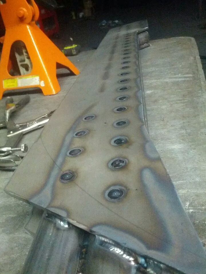

Now I can finish working on the front end while I weld these up.
    134.9 KB
    104.7 KB
    107.9 KB

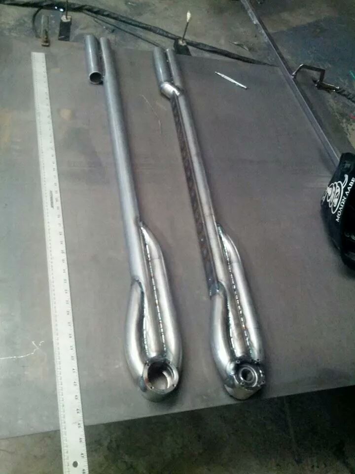

You can do good fab work, but holy **** you like to make tons of extra work for yourself.
Is your thought process something like this? "Hmmm...Need to do trailing arms, should I just use some 2"x.25" wall HT chromo with some plating with minimum welding like everyone else? Nope, I'll make each one three tubes, have 6 feet of welding per link, and let the final product be heavy as ****? Yeah... I'll do that."

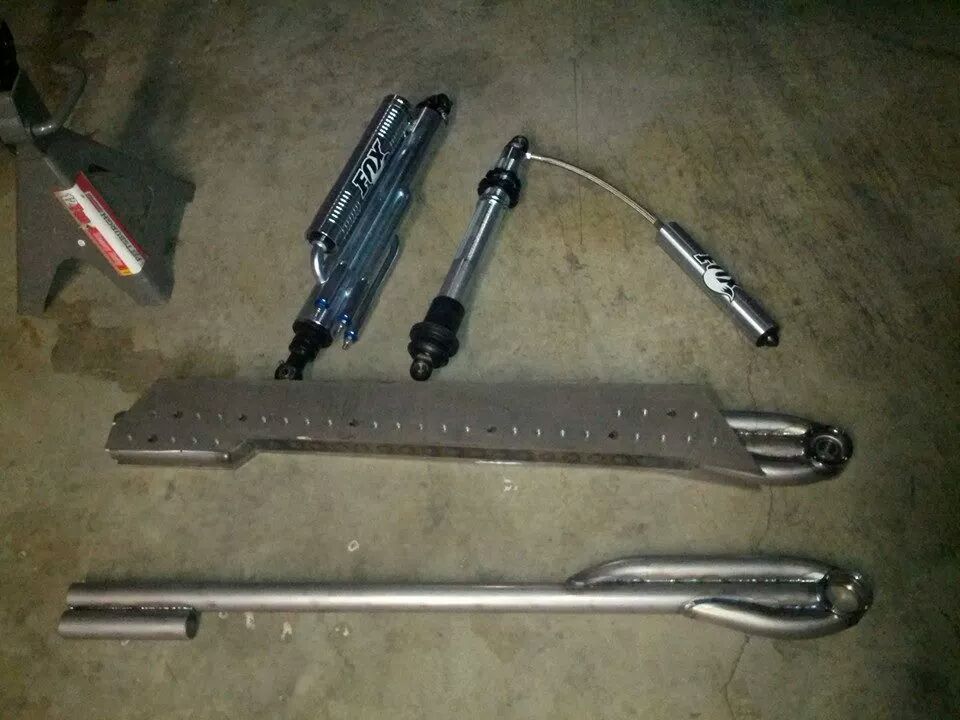

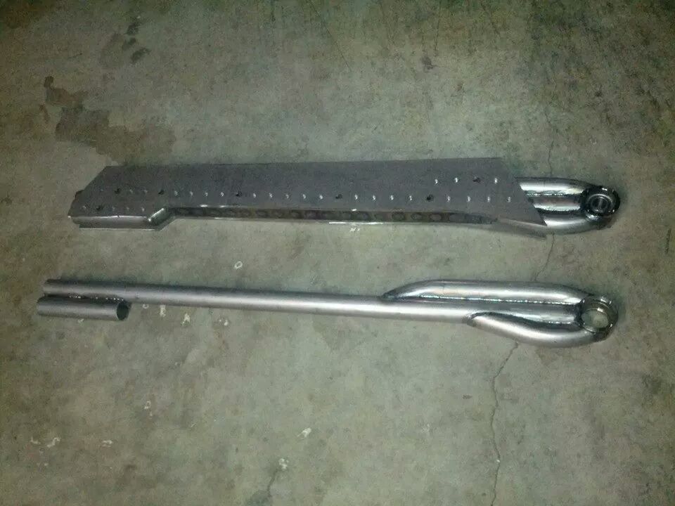

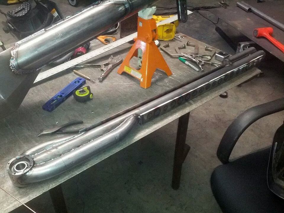

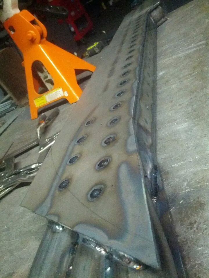

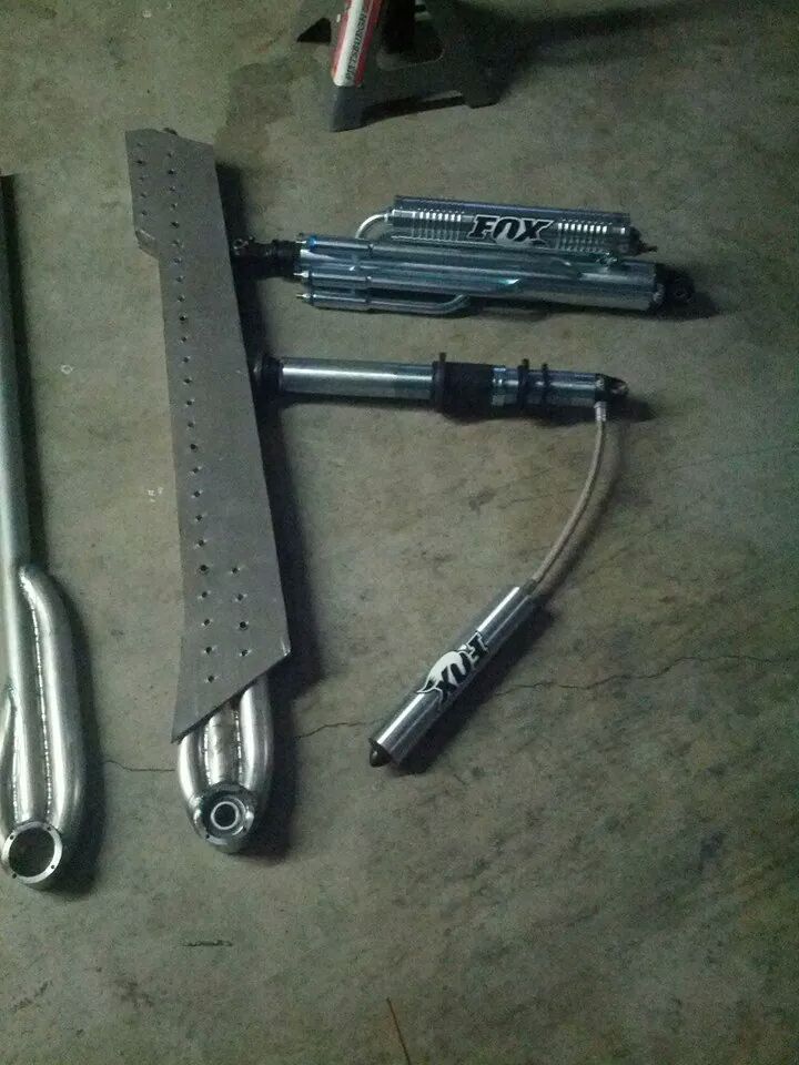

Or I could do like everyone else, and use 2 x 1/4 wall like you said, plate it all in and run fish plates, weld them on. Get less ground clearance and still weight about the same?
There is a fine line between functionality, durability and marketability. It doesn't take an entrepreneur to build the heaviest and most robust product on earth, it takes an entrepreneur to build a quality product people want to buy at a profitable yet marketable price point. What does a set of trailing arms like this cost to replace and what is the lead time during race season?

Looks like around $850 for a pair, with the pro-am wobble stoppers.

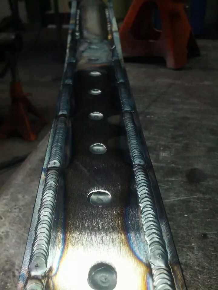

These prototypes will have 2 days time involved. Could probably build them custom like this in 1 day. Quicker if the plate work was laser cut.
I'll bring a scale tomorrow and weight them.
