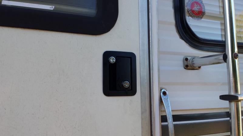

So the lock was being stuburn and only worked when it wanted to. I said screw it and replaced it. It seems this style is very commonly used and very easy to source and inexpensive.

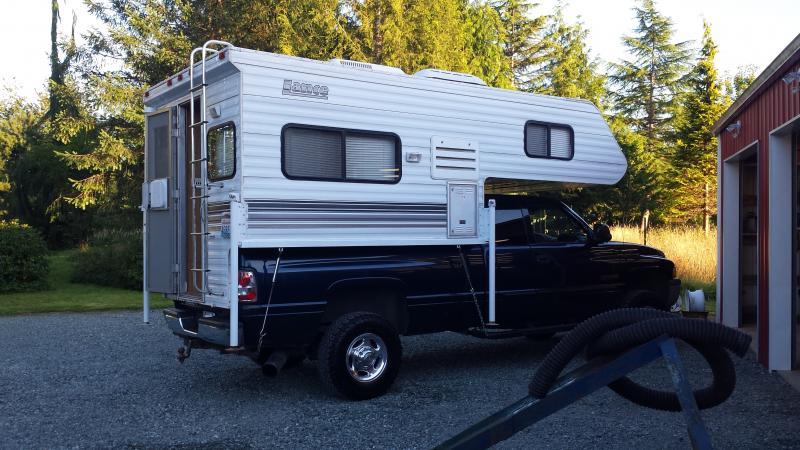

Ready for its first trip to the coast...

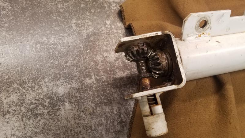

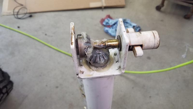

So here is the top of the jack. The top cover simply pops off...

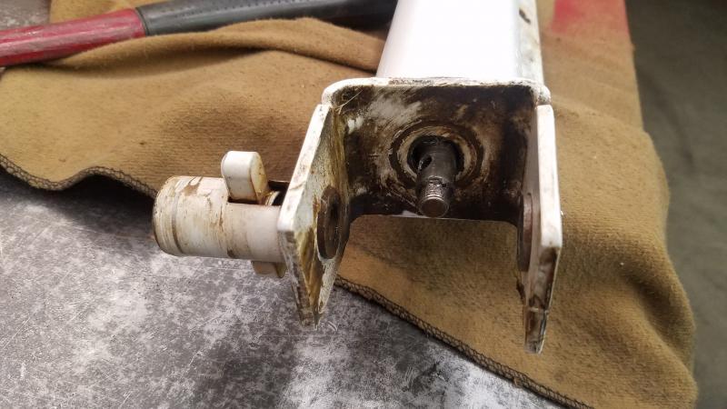

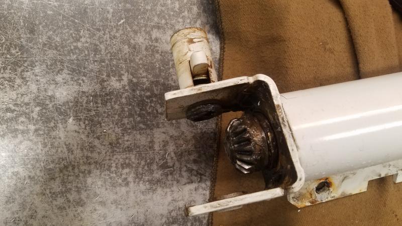

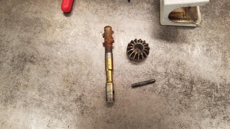

So to get the drive gear off there is a pin on the outer edge. Simply pound it out and slip the drive shaft out. The pins that the tool uses to turn it only lets it come out one way.

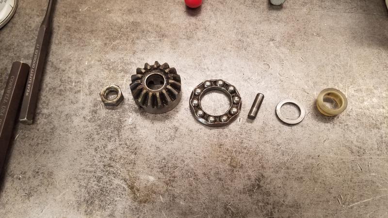

So next you gotta remove the driven gear. On the center there is a nut, remove it and then the gear and a pin(it should just slip out). Then remove the bearing, washer and nylon shouldered bushing. Pay close attention to the nut as it will be important on re-assembly.

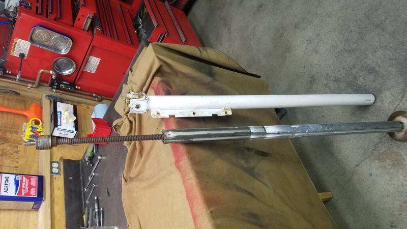

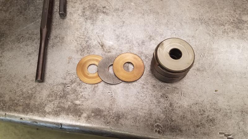

The next part is tricky to get it apart easily. Holding the bottom of the jack set it on the ground upright(don't let it separate). Holding the bottom with your foot lift the outer portion up about 1/2" and grab a 90 degree pick. Inside the jack at the top there are 3 washers and a spring head. You want to make sure the washers don't stick to the outer body by using the pick and then lift it apart. You can see how it sits on top of the threaded shaft. Pull it off once its out and clean them. You can see how they are situated with copper, metal and copper.

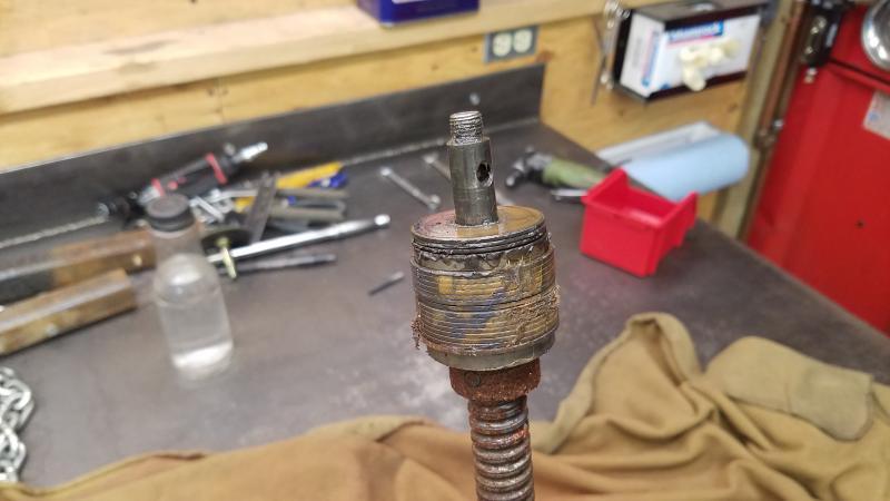

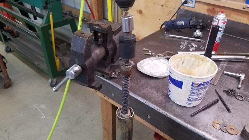

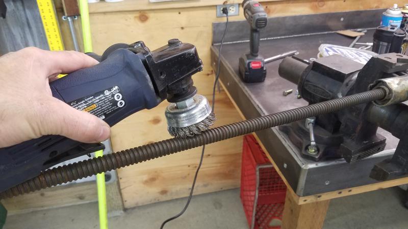

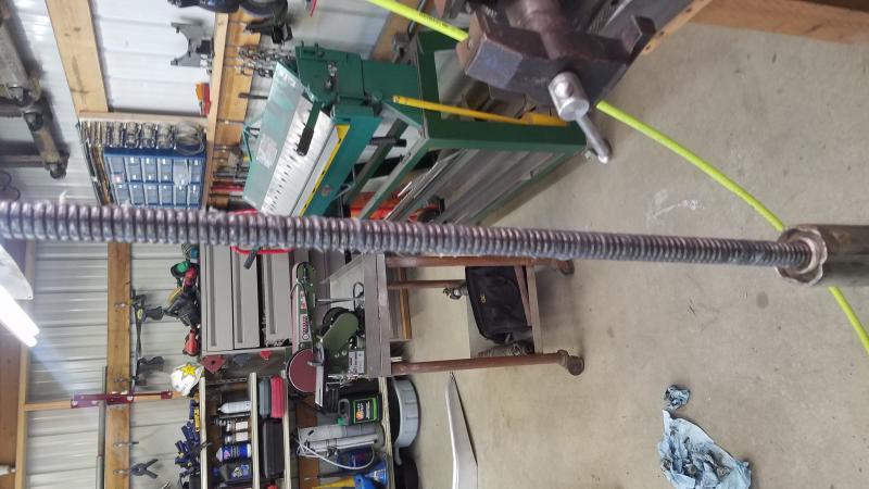

Since the threaded part of the jack had zero grease on it and was a little rusty I did a light wire wheel on it. I found running the threaded part all the way up and greasing the threads and running it down and back up and wiping the rusty grease of and then repeating got grease on the other side of the jack female threaded portion.

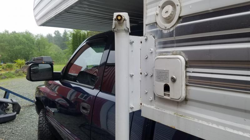

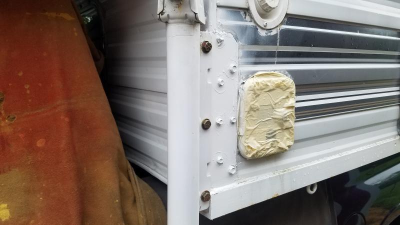

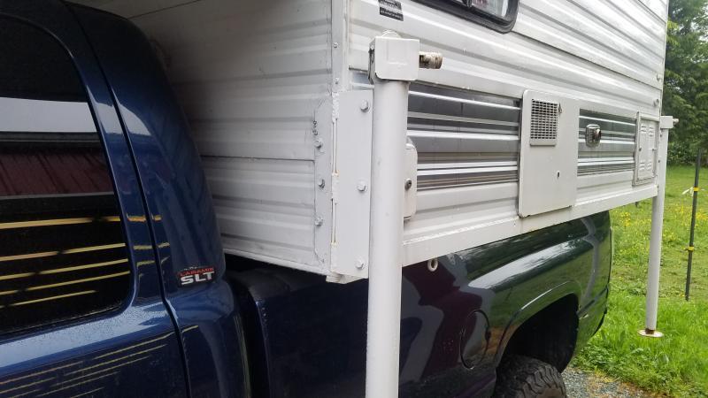

Another big reason I wanted to pull the jacks was the previous owner had a dually and welded extensions on he front jacks and really messed up my view thru the mirrors. So with a little gentle work I cut them off and now the jacks are in the original spot and much better.
