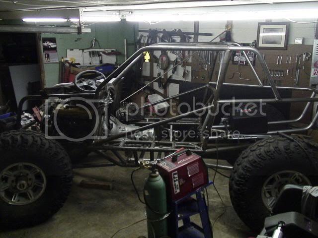

Damn its hard to get an overall picture of this thing from inside my tiny garage laughing I was literaly standing on my small roller box in the corner with the camera above my head to the ceiling behind me taking this shot :flipoff1:
Didnt touch it Saturday... I got the funk-a-nitis going on and felt like poo... still dont feel 100% but got some good stuff done today. Tcase /tranny mounted ( Im going to make one other mount off the back the case though..) put some steering time into it, tryin to lay out the ergo's Airs in back mounted, sway bar mounted just good stuff... Should have the winch in tommorow and I can put the airs , radiator and winch up front to complete the "roller" status. It is sitting all on its own now, front is on the air bumps

Got alot of lil stuff done this weekend, rad mount situation resolved, grille mounted lots of lil support tubes blah blah blah, I feel good about were its at right now and what my schedule is.
I extended the rear shocks all the way out and the bastard still wasnt hitting the ceiling in my lil garage ( it was real close though) laughing
