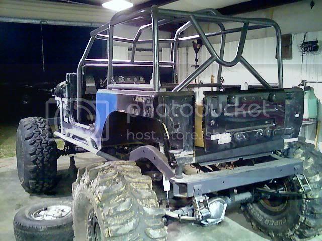

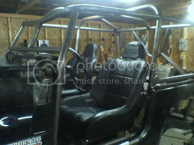

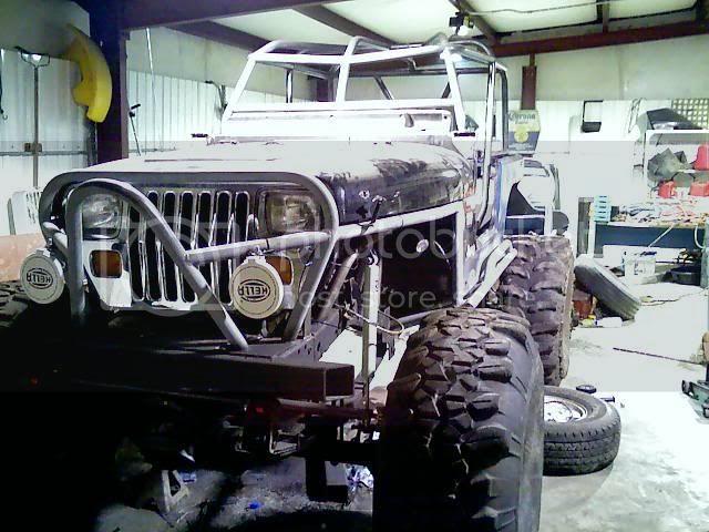

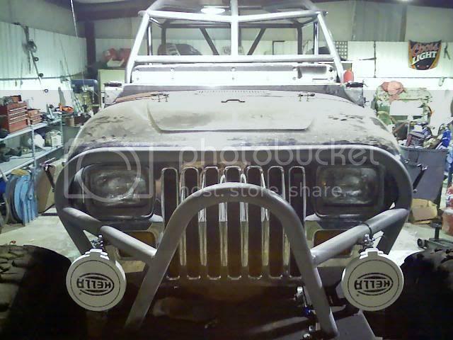

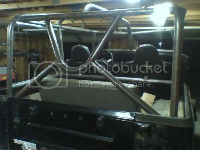

87 yj 355 sbc,turbo 350,203-300 doubler , propane injected,all msd electronics,1 ton running gear with lockers front and rear,full hydraulic high steering,110 inch wheel base,44 tsl front and 44 boggers on rear,suspension seats, art carr shifter,full , cage, 8000lb winch,custom dash .Not quite finished but close
