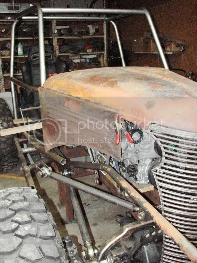

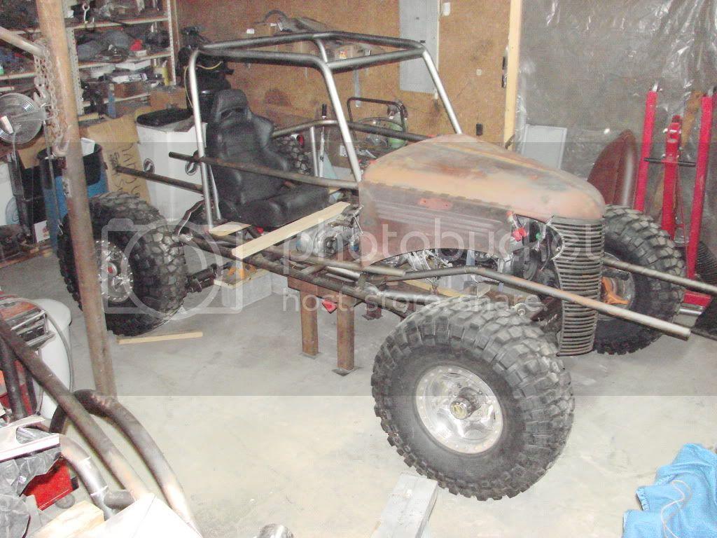

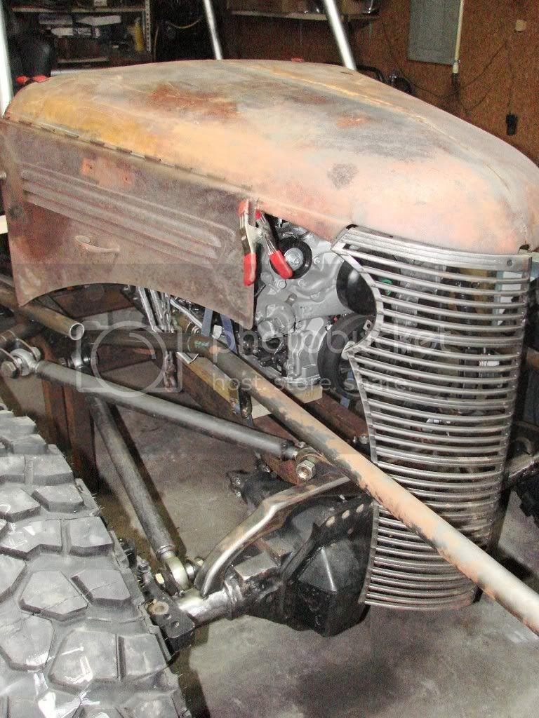

Here is the front sheet metal mocked up on the buggy.
Keep in mind the whole front clip will move a few inches forward to give the look of a cowl area and give me a place to attach a windshield frame.

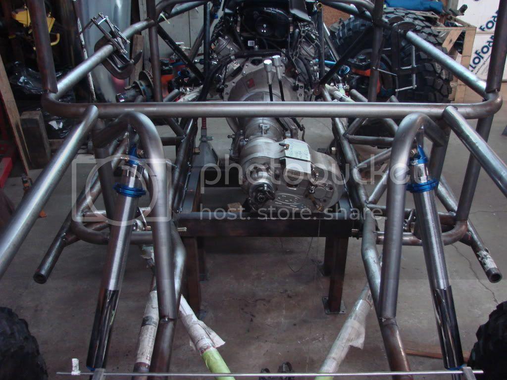

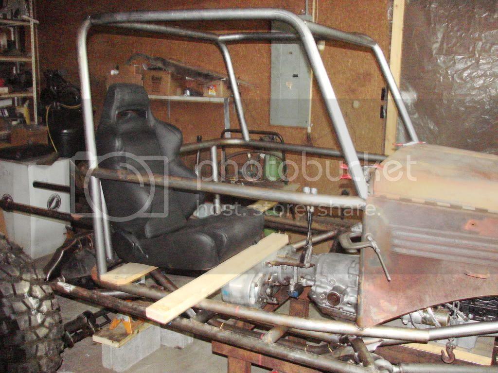

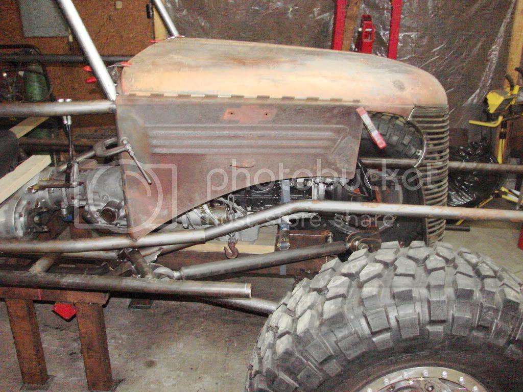

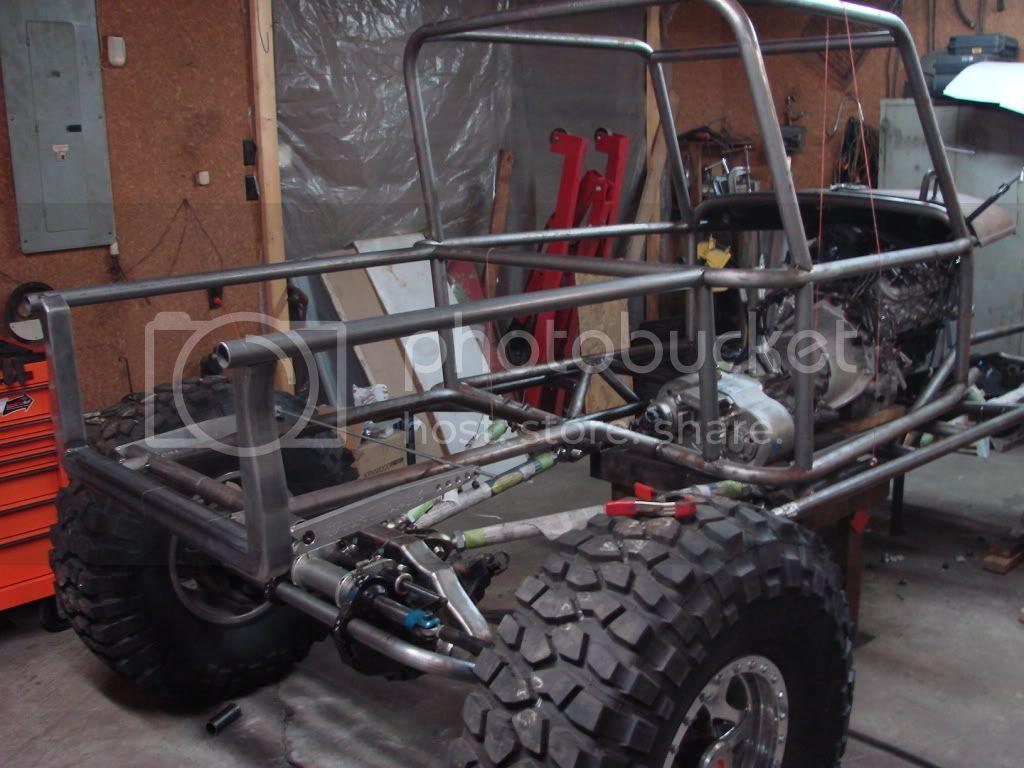

The next pictures show the top art of the cage Which John and I originally planned on making look like the cab of the pick up truck. With repairs in mind as well as a I felt like I could make the cage look better than the original cab we decided to go for the look of a roadster truck.
So I laid back the A pillar some and angled them in along with the B pillar instead of having a boxed cab area it looks more sporty.

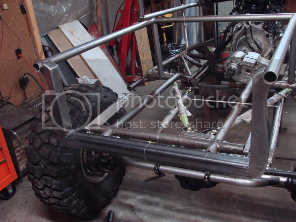

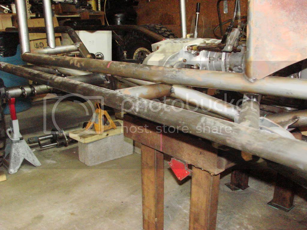

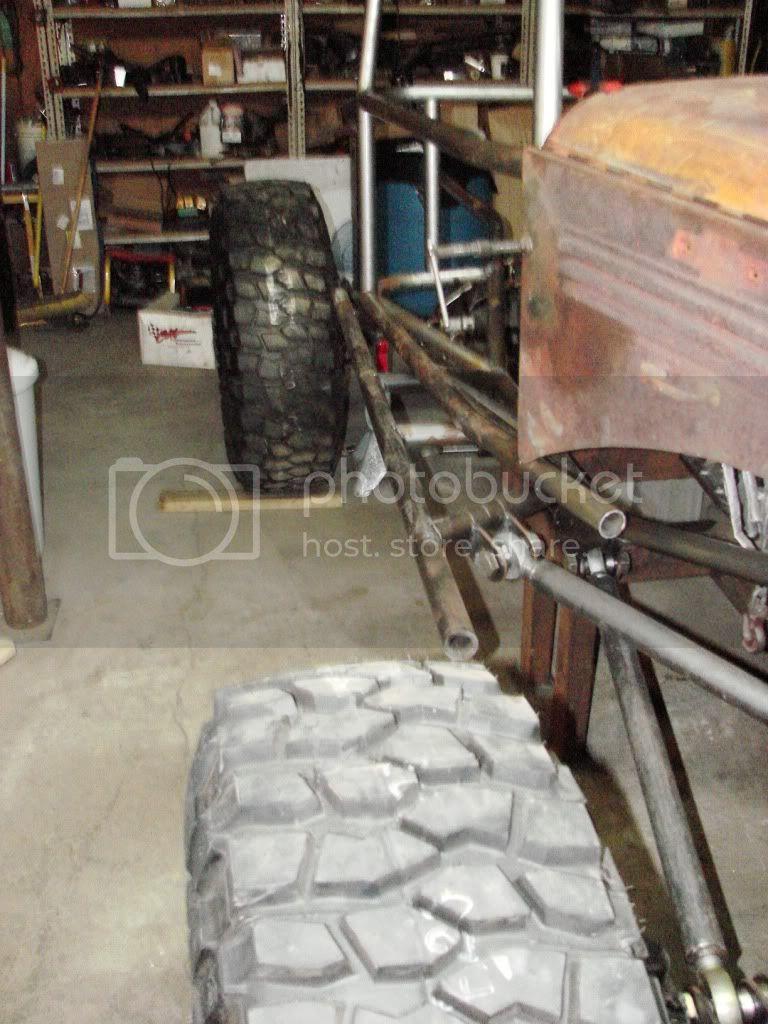

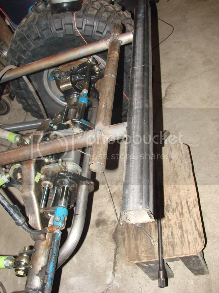

The one part that sicks out to every one that looks at the buggy is the running board bar. It it the bar that that is going to be the most significant bar of the vehicle. It runs straight as the actual body lines angle in to a point at the front of the truck.
I built the bar out of .250 Wall thickness DOM to help from bending or getting dented by rocks. This is going to be the bar that the fenders start from.

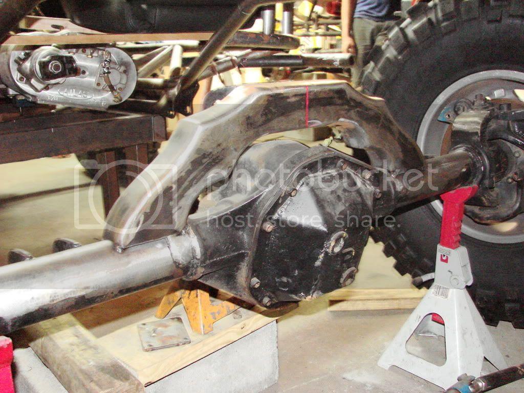

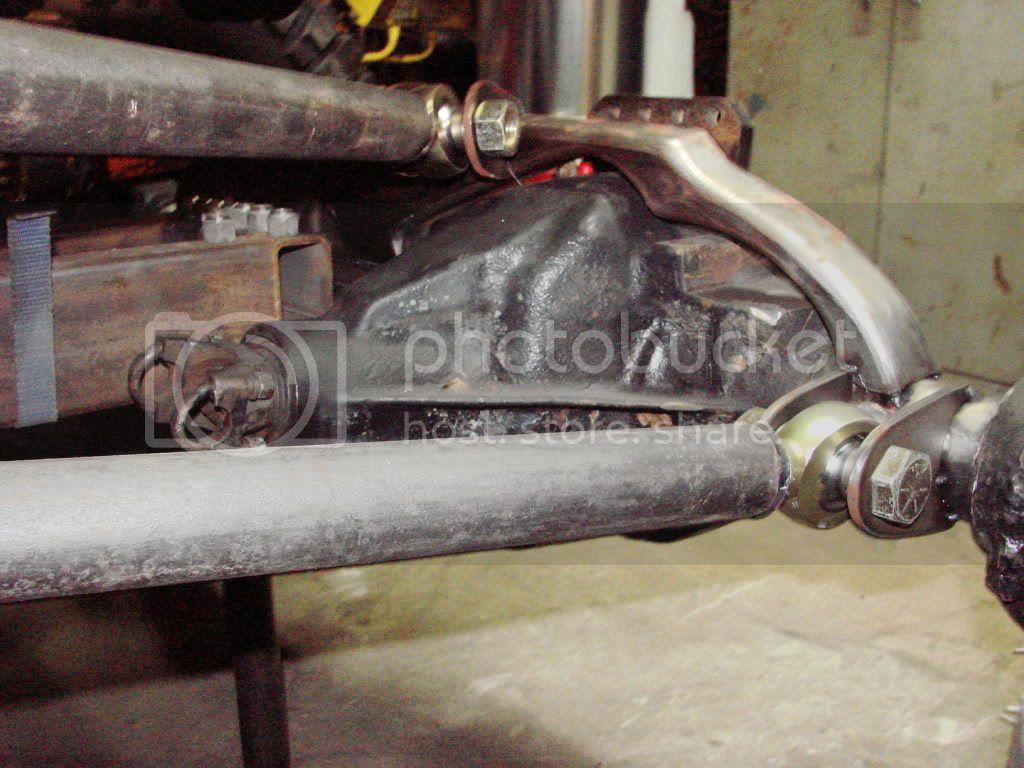

All of the four link brackets are on the axles and the chassis too. We nailed down the font we wanted yesterday and the links should ship from Branik on Friday.

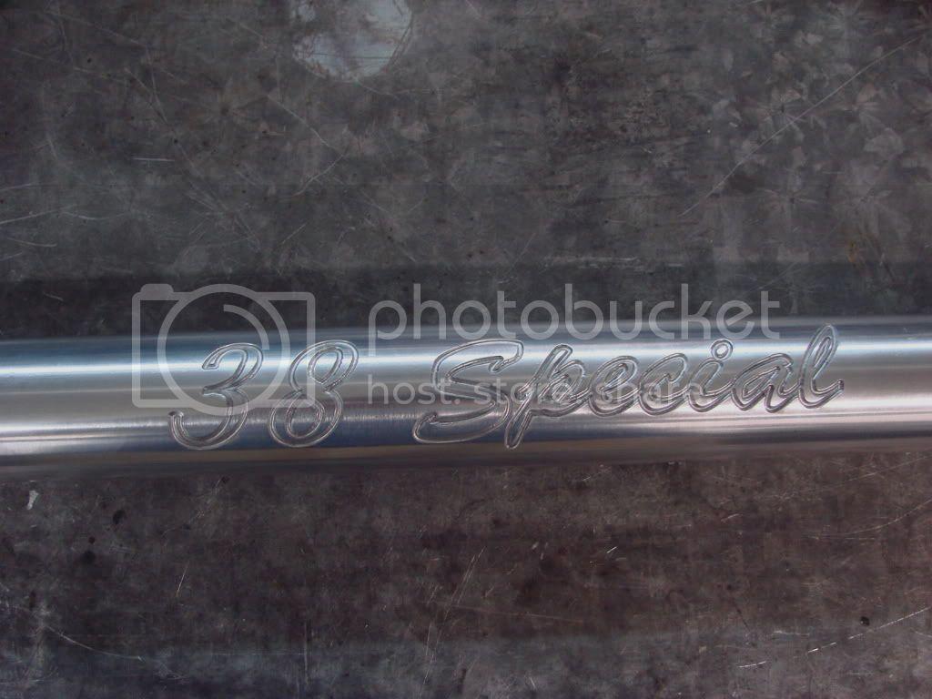

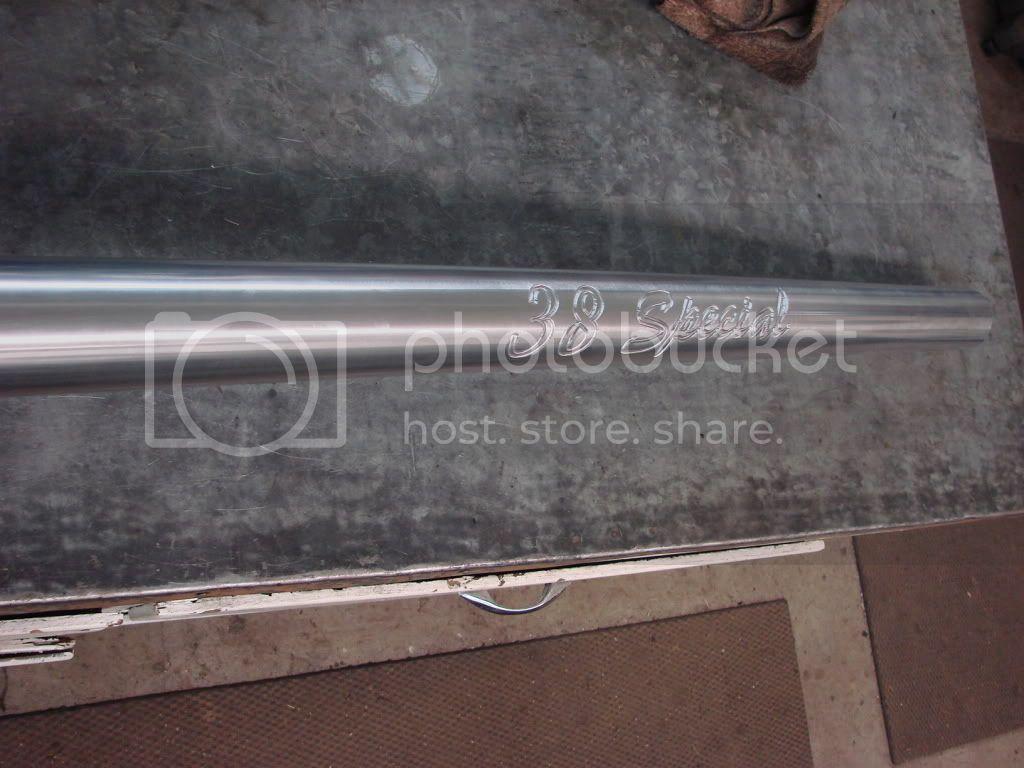

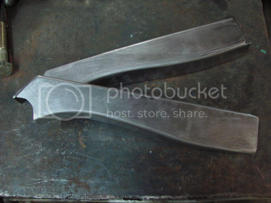

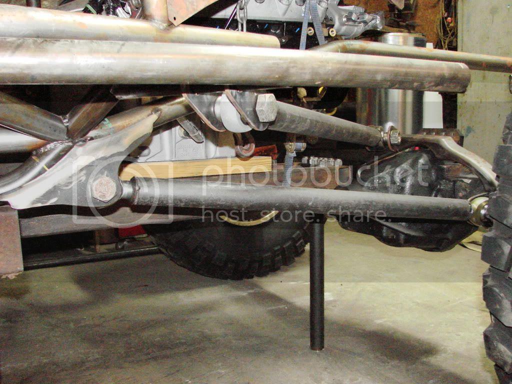

The new aluminum links Showed up from Branik Machine.
They are fully polished solid 7075 link with custom engraving on the the lower links. John and Nan found a font that matches the font on the tail gate. These kind of details are going to set this truck off.

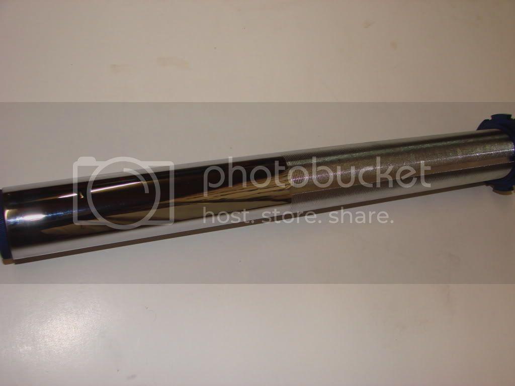

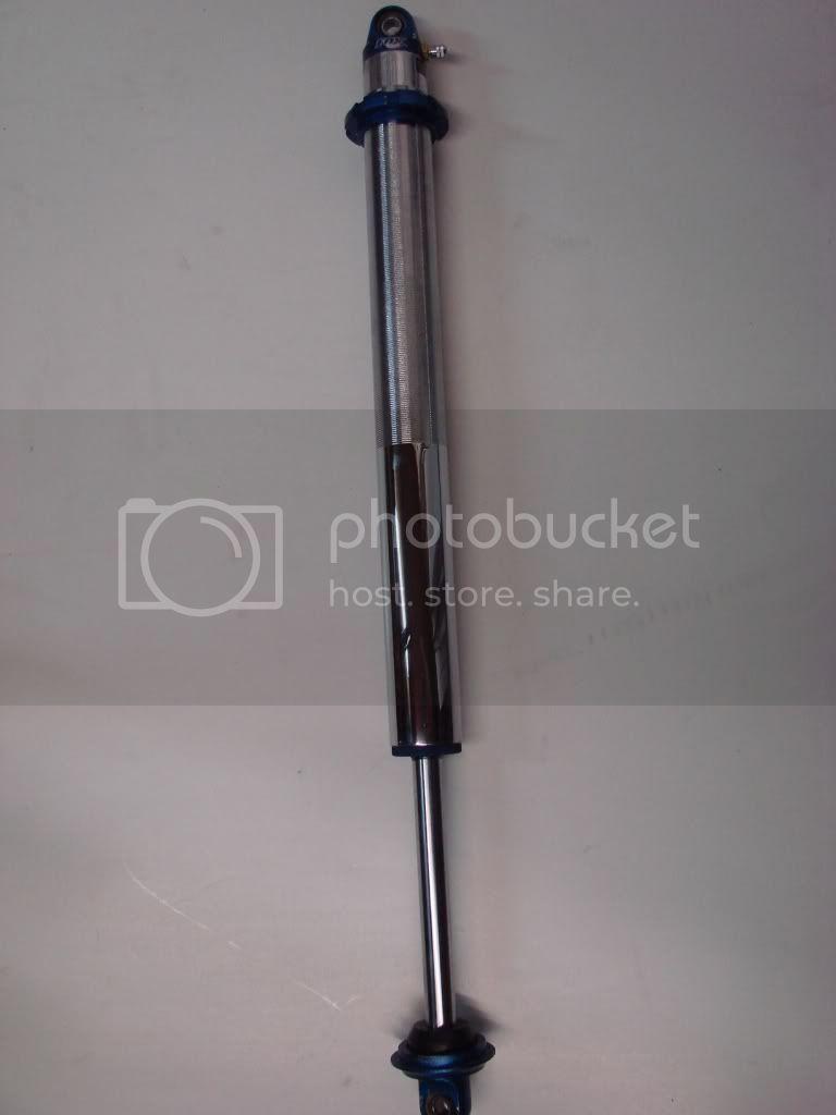

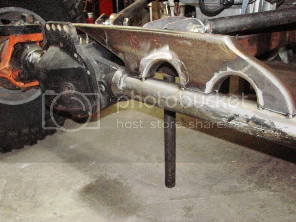

Next the old shocks came back from Fox from being refurbished and new chrome plating added.

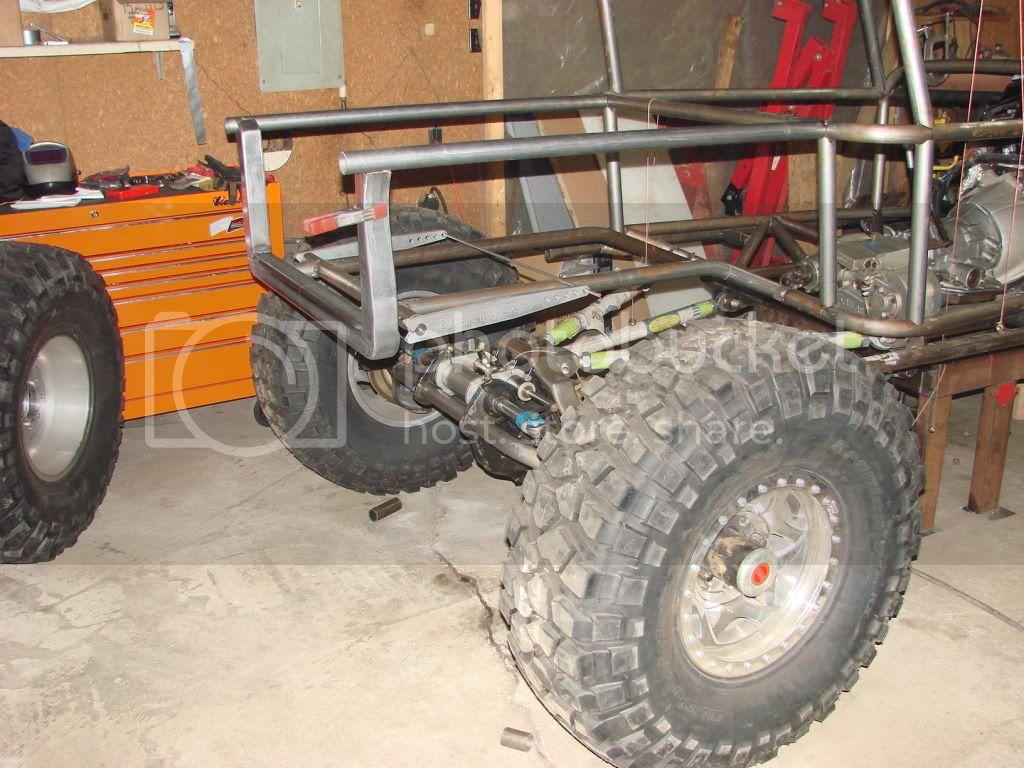

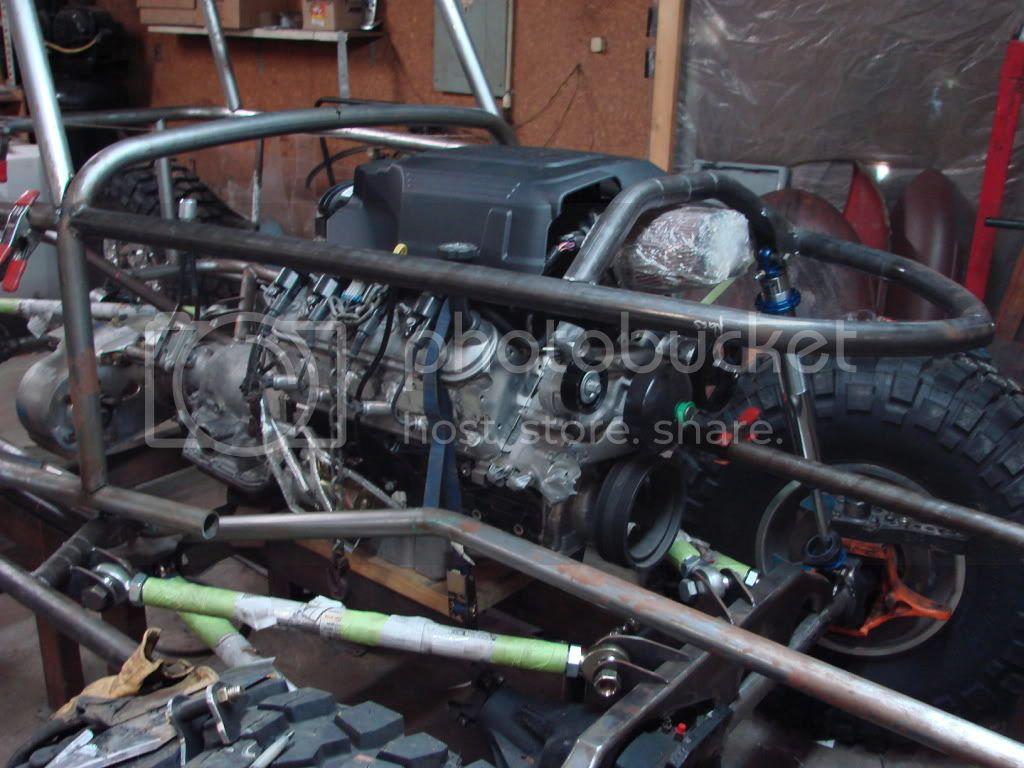

We got the front tubes laid out for the front of the buggy to support the hood and the shocks.

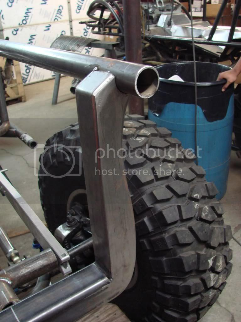

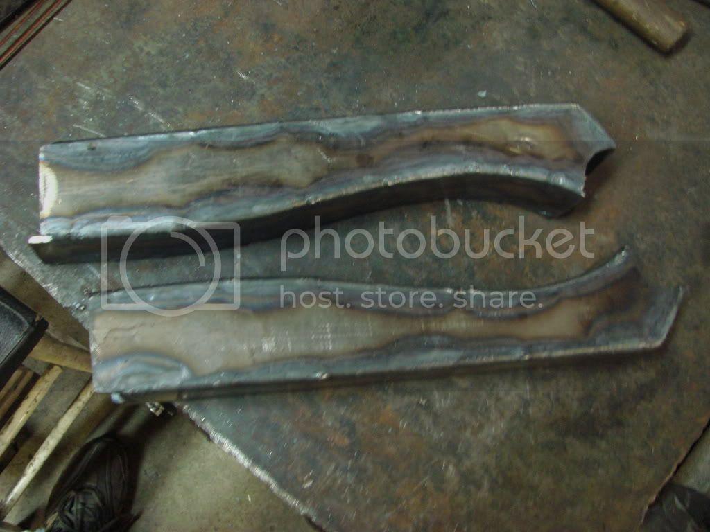

I really contemplated many different ways to tie the look of the rear bed posts with some thing that would be strong. So I just made some out of 4 different 1/8" steel. Welded them up and then ground them down and welded them to a piece of square tubing for the look just like the 38 truck has.

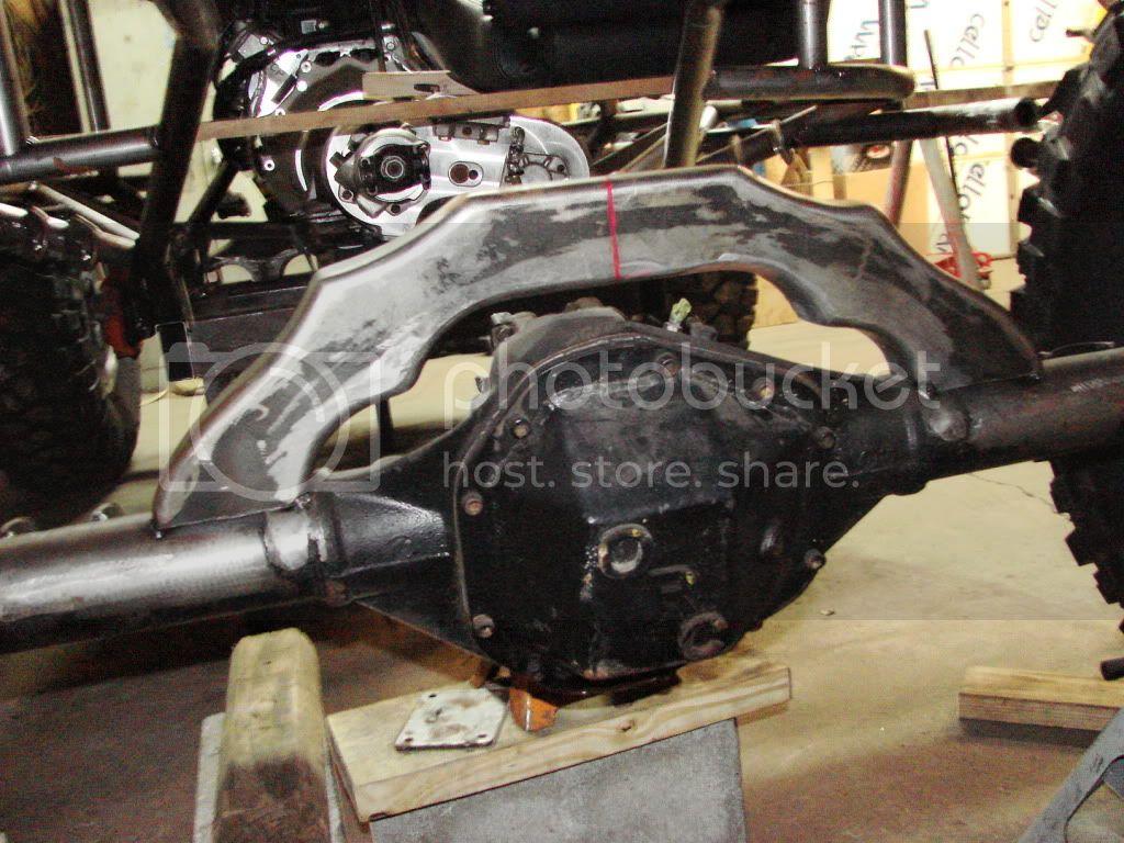

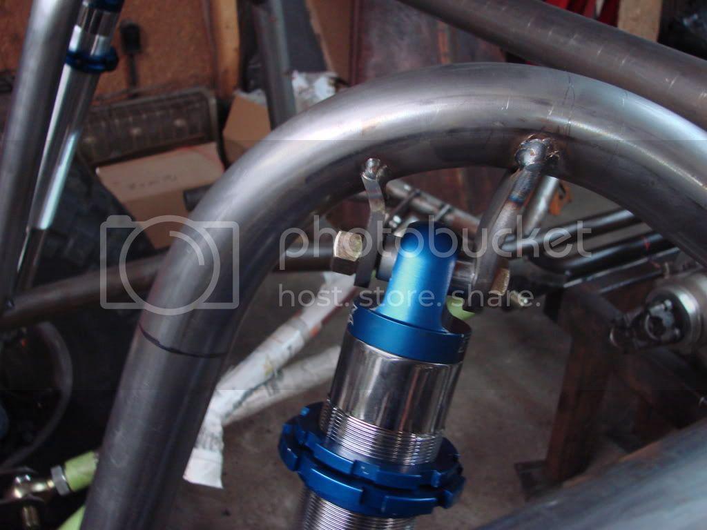

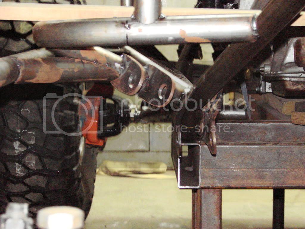

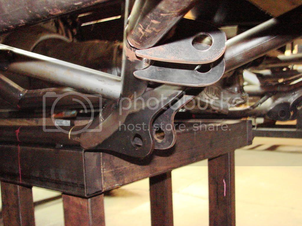

Next came the I got the rear shocks mounted.
I bent the shock tabs out at the top to give them a little better look and spread the load out a little better. It will cool real good when they are gusseted up.
