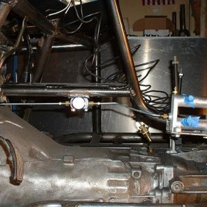

Decided to get rid of the stock tranny, wanted lower crawl box gears, more flexy lift (SOA), bigger tires 39.5 Iroks, dual battery's half doors, sliders, fender trimming, Front/rear arbs, hydro assist... etc

actually I decided to go with a different steering ram than the one pictured. That one sucks because the attatchment points would not have allowed any movement... I went with this one from Surplus center..
SWIVEL BALL END CYLINDER
Brand new, welded cylinder with wire-lock gland retainer. Swivel ball joints at both ends allow for angular motion.
SPECIFICATIONS
* Double acting
* Bore x stroke 1-1/2" x 6"
* PSI max. 3,000
* Rod dia. 1"
* Ports SAE 6
* Retracted length 13-1/4"
* Shpg. 7 lbs.
END MOUNTINGS
* Rod end swivel-ball
* Ball width 1"
* Ball O.D. 2"
* Pin hole 0.75"
* Base end swivel-ball
* Ball width 1"
* Ball O.D. 2"
* Pin hole 0.75"
