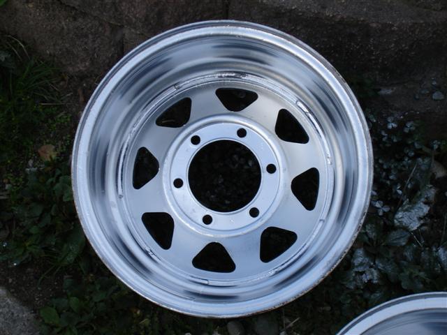

That makes me a bad ass!:D
and maybe bored after scraping all the rust off, it was the only color I had.:clappy:
