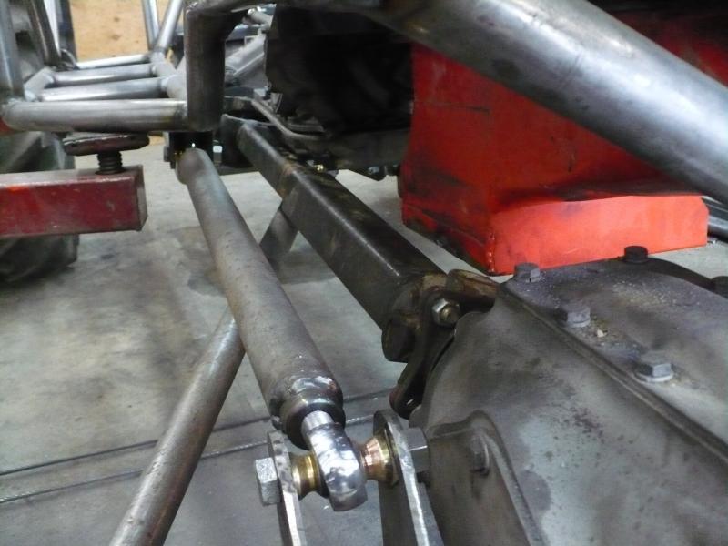

On ur drive lines, how long is the slip tube ?? How much travel is in them ?? Is that 2" box to 1 1/2" box ??

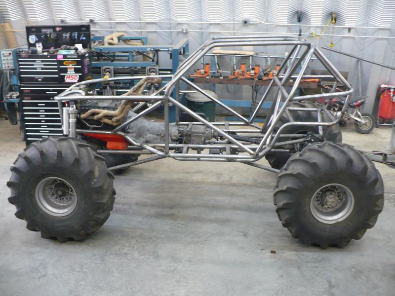

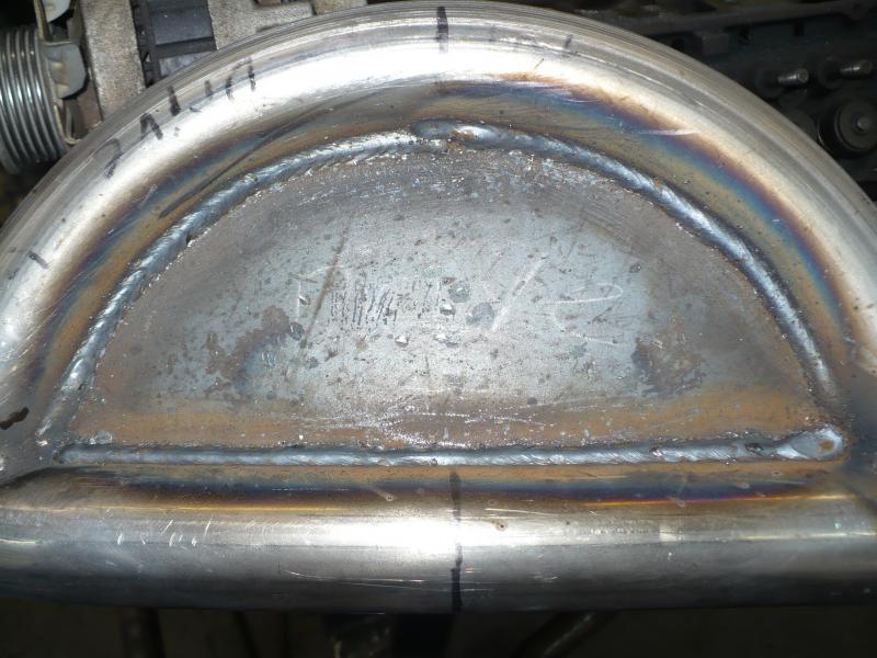

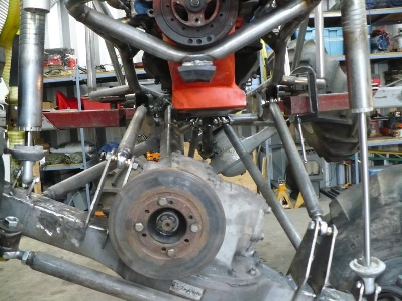

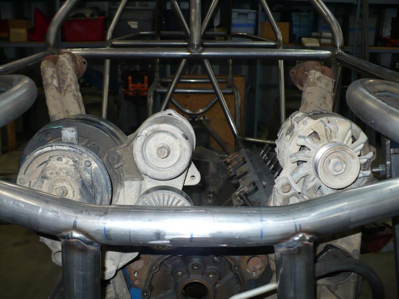

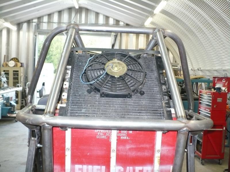

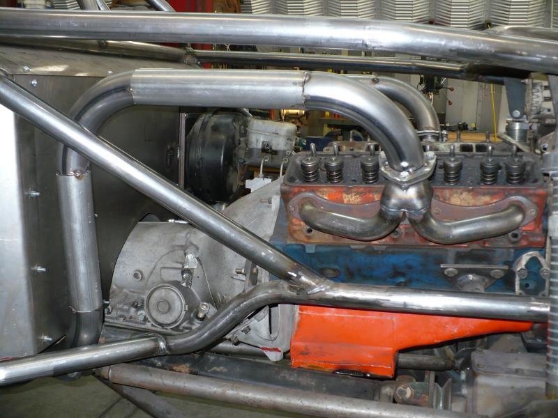

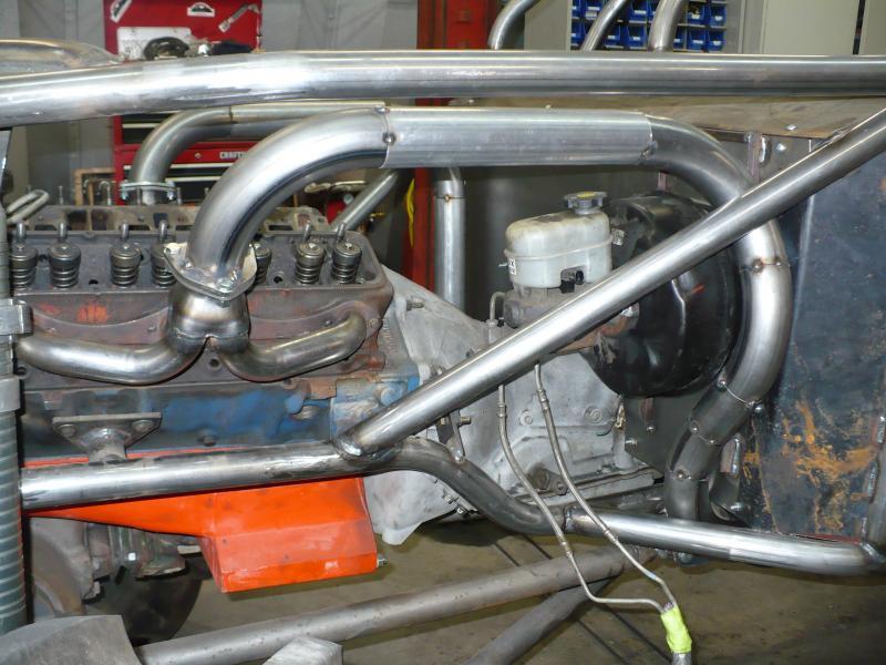

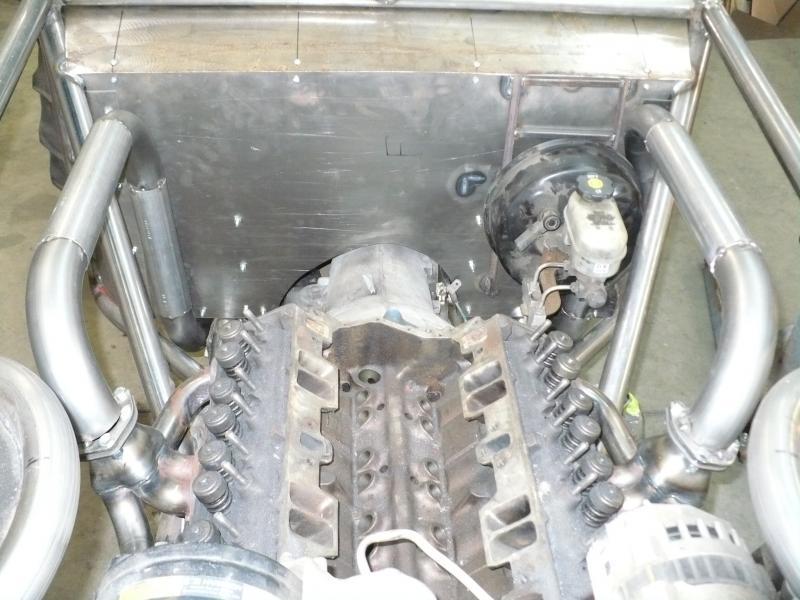

So I finally got back to work on the buggy, I've gotten the radiator mounted and some of the coolant lines run. I also finally got my header and exhaust situation worked out. I've spent the last couple days just trying to make everything fit, but its starting to come together.:D

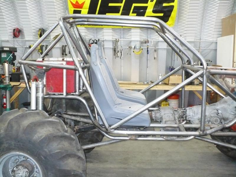

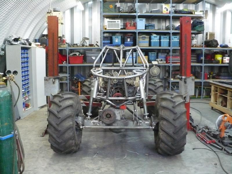

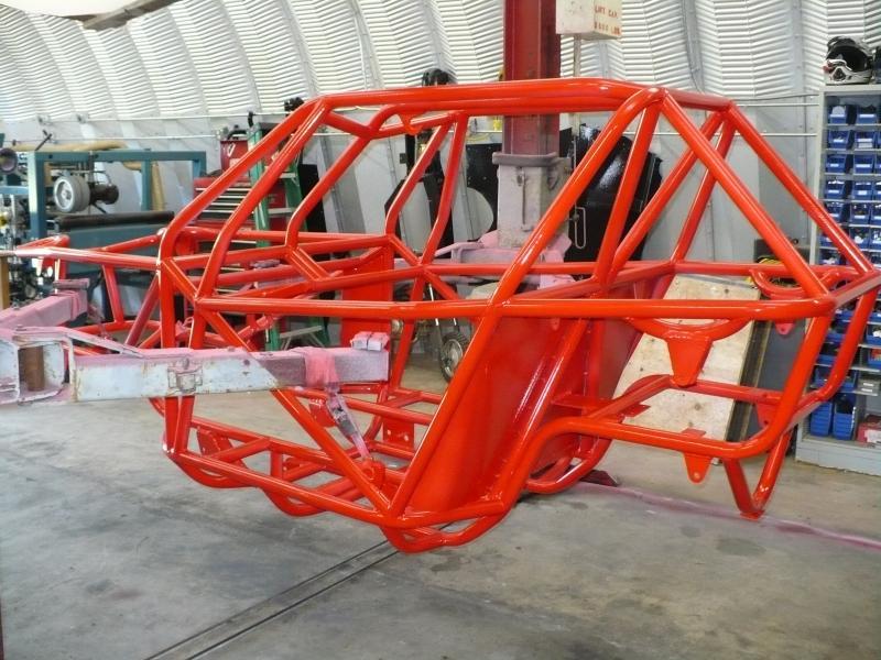

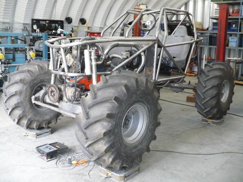

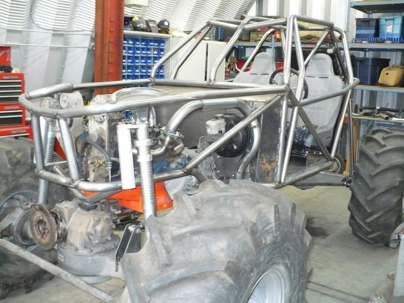

I finally finished all the major fabrication so I decided to weigh the buggy to see where it was at. As it sits right now it weighs 3566 with a front to rear weight percentage of 54% front and 46% rear. By the time it has fuel and two passengers in it, the split will be very close to 50/50. Now I'm going to take it apart, finish weld everything, add gussets and paint it.:cheer:

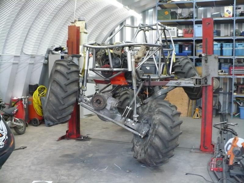

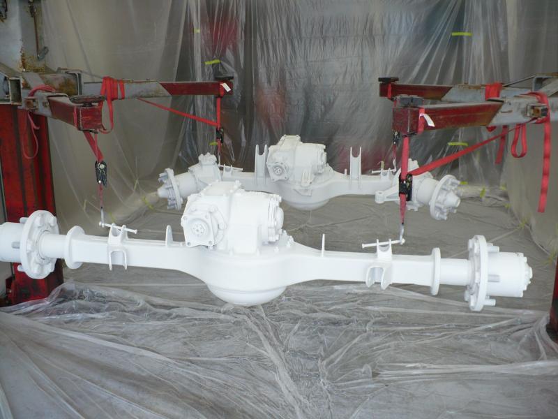

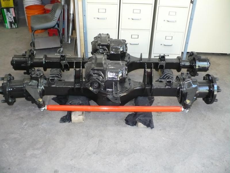

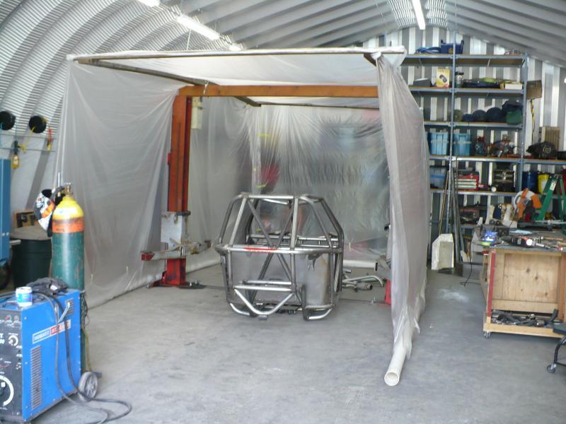

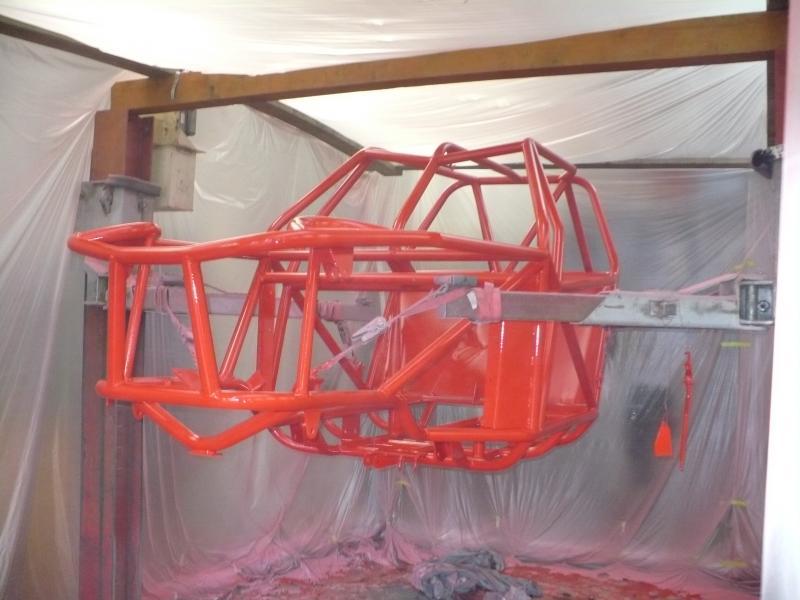

I havent posted in a while, but I've been really busy tearing this thing back apart and painting it. The white is just the primer, the whole rig is going to be red and black. I'm hoping to start reassembly some time early next week. :D

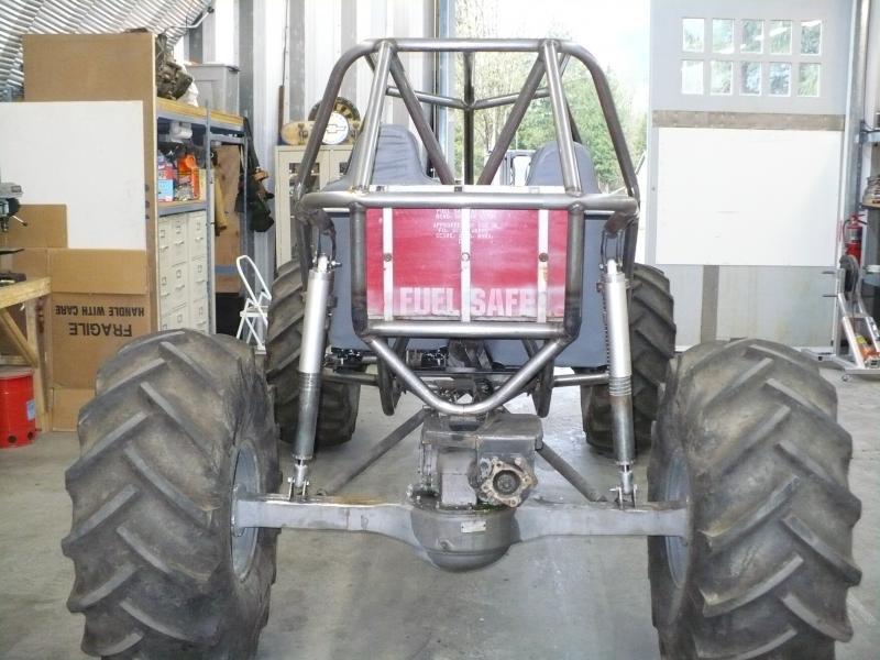

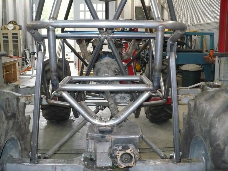

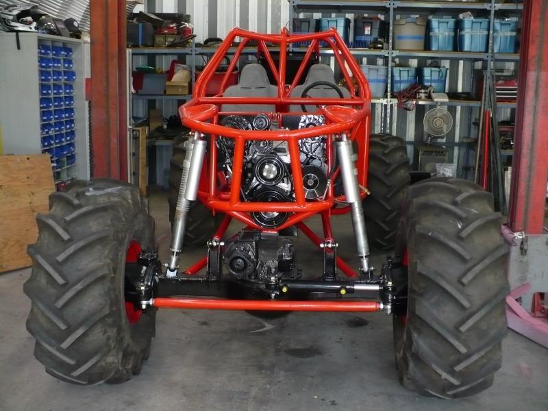

Well, I'm finally making some progress. I still have lots of parts to buy, so I wont be out wheeling anytime real soon but, at least its starting to look like something.:FIREdevil:

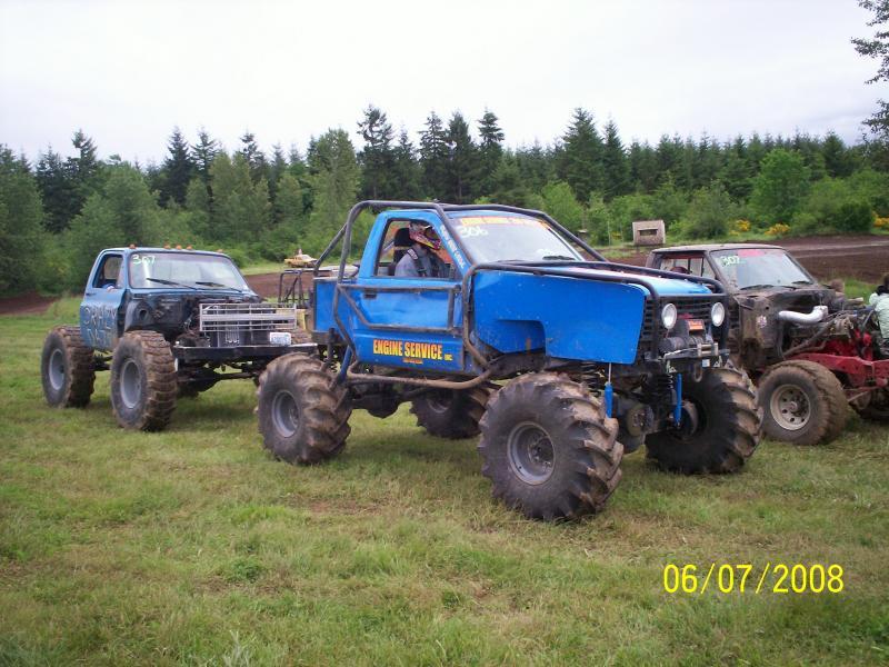

Here is an old picture from the Mudslingers tufftruck/mudbog in Ethel a couple years ago.....

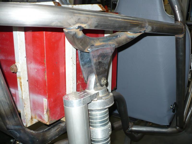

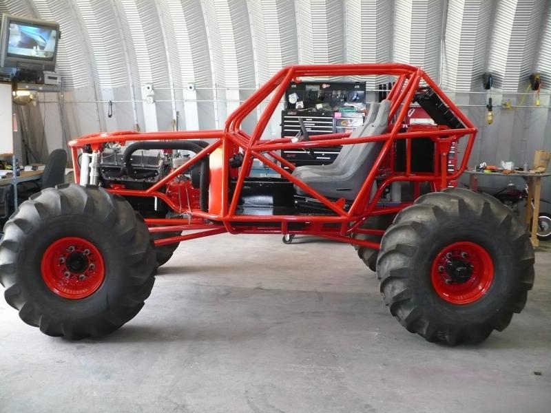

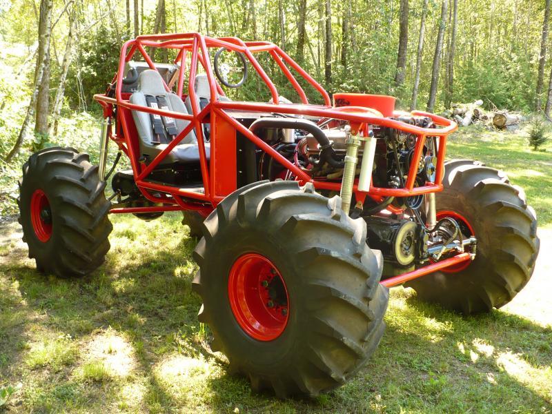

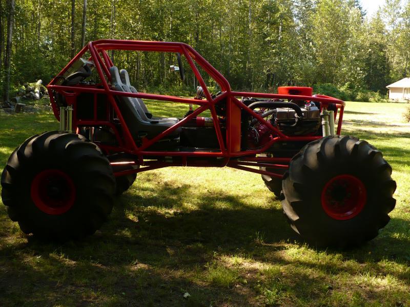

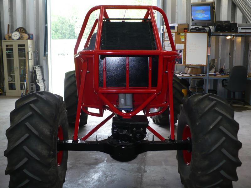

I finally got it running but not with efi, I put the carb back on it temporarily because there were too many wiring issues to deal with while working out the bugs with the chassis. I will get the efi going over the winter. It freaking screams now that it weight 2000 lbs less than the old rig. I do however have heat issues. I think the heat can be solved with a bigger radiator and a fan shroud. All in all I'm thrilled with how its turned out, now I just need to put springs on the shocks and a new radiator and wheel it!!!:D

when i put the rad. in the back of my buggy it gets turned around from when it was in the front and had to cross the coolant lines running to the back as they were in the front, i tried to reverse them and no worky, it was sucking from the top outlet and going in at the bottom, and then i would have to pull the t-stat to get the air pocket out of the block. not sure if this is how you did it but just my experience with radiators in the back. both my rigs i have the rad. in the back.
