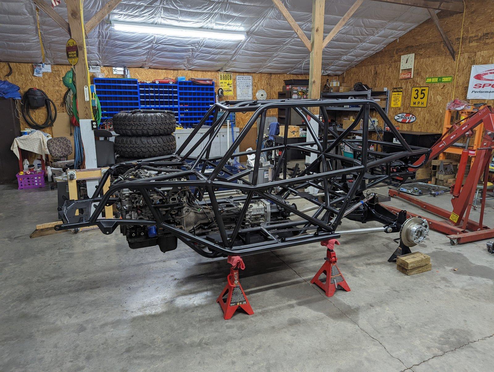

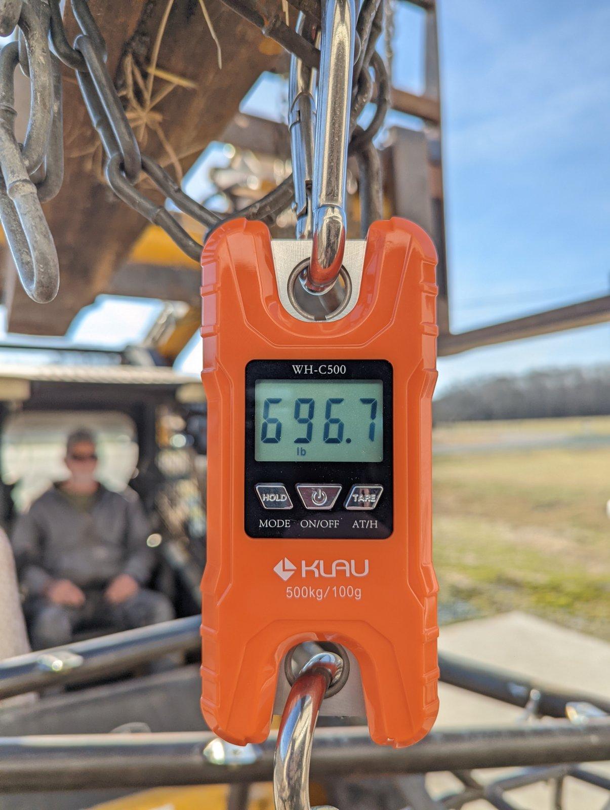

Completely forgot that I weighed the bare chassis before we painted it. It's just a cheap $45 mini crane scale but it's all I've got. Planning to weigh the axles and the engine as well just for curiosity. Will put the completed buggy on some racecar scales when it's all finished.
That’s awesome on weighing everything as it’s being reassembled!
@ridered3 local guy has a paint booth at his house that I rented out for the weekend and I had a buddy spray it. SPI black epoxy primer is what's on the chassis and the axles. Wanted something that was easy to touch up down the road with some semi-gloss black rattle can.
Is it just epoxy primer with no clear coat?
Thanks for the heads up. Too late to change it now, that is what my buddy suggested to use. If it gets bad in the future, I'll just rattle can it more.
Assuming you are going to keep the buggy inside... then it won't be much of an issue.
buddy painted his with DP90 epoxy primer and it looks and matches krylon satin black. Every couple years he'd hit the outside of the tubes that got rashed up with rattle can. Just held a piece of carboard on the back and painted the "face" of the tubes.

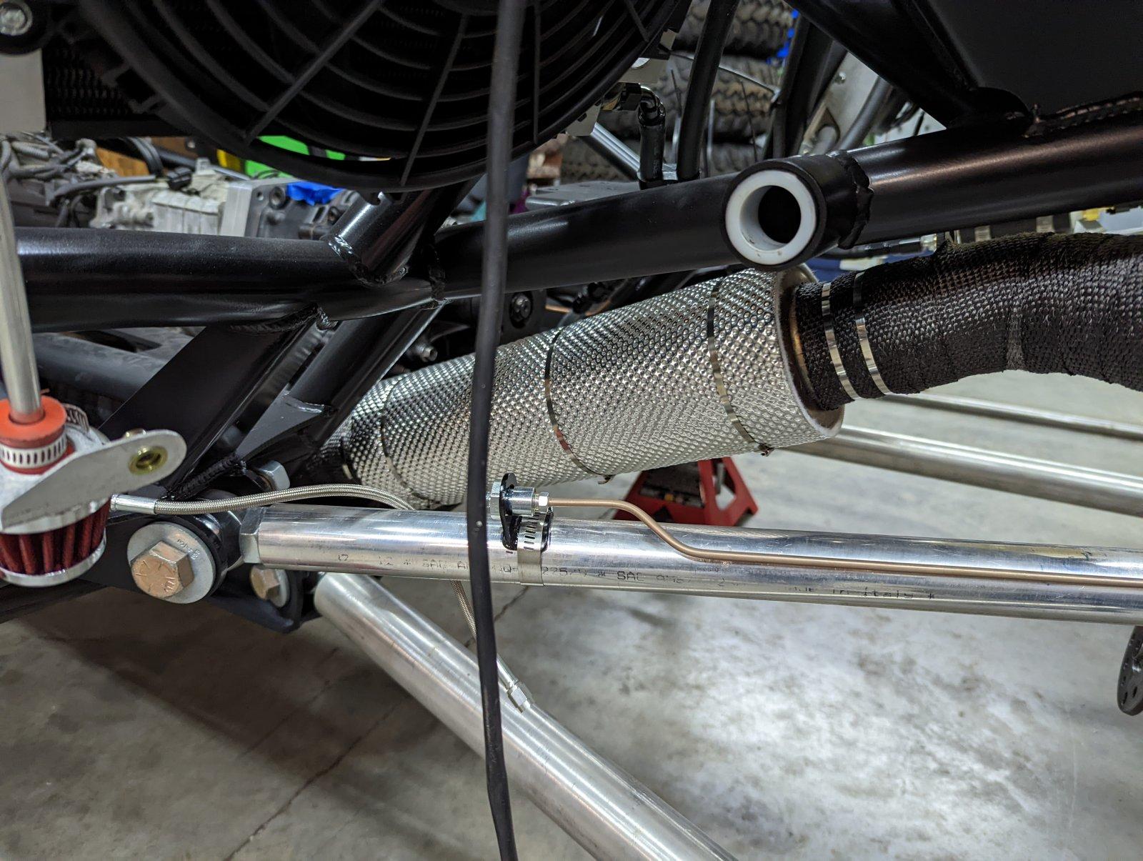

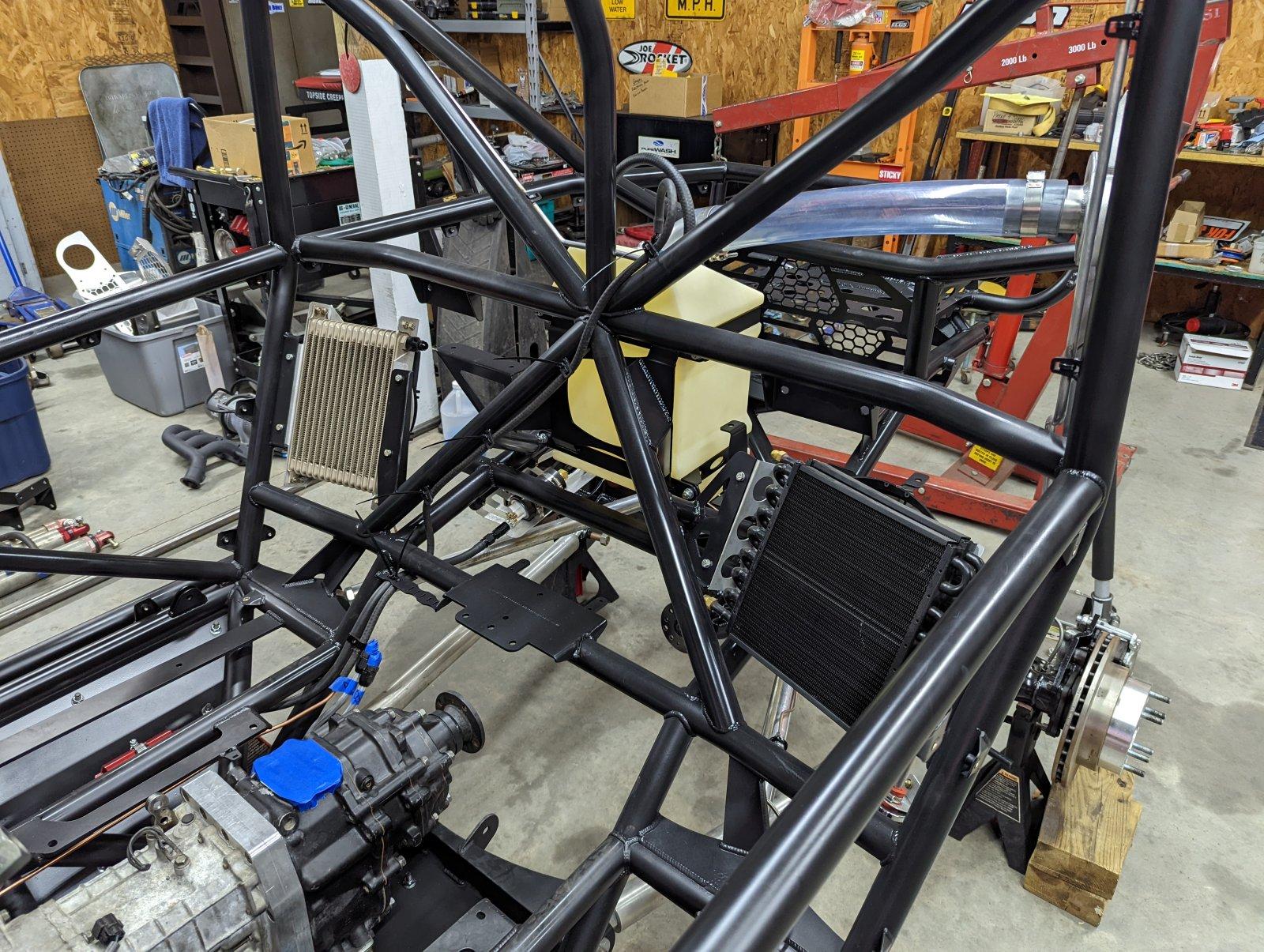

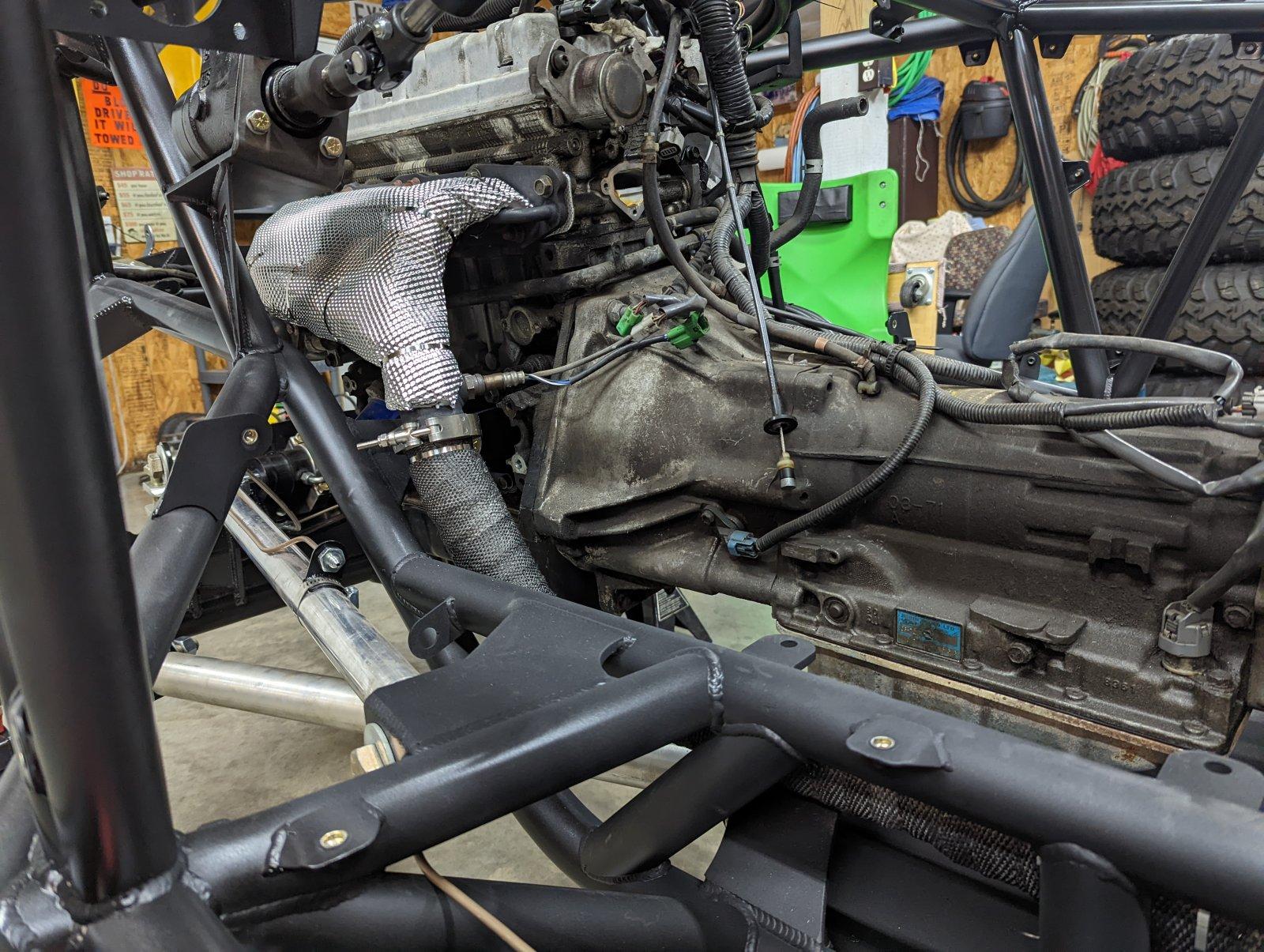

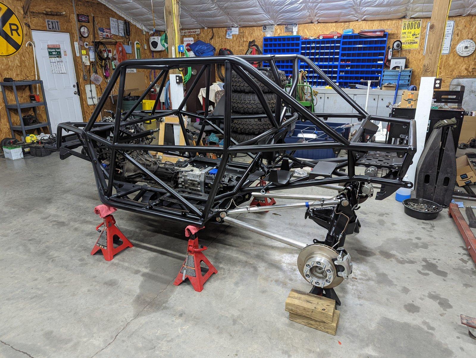

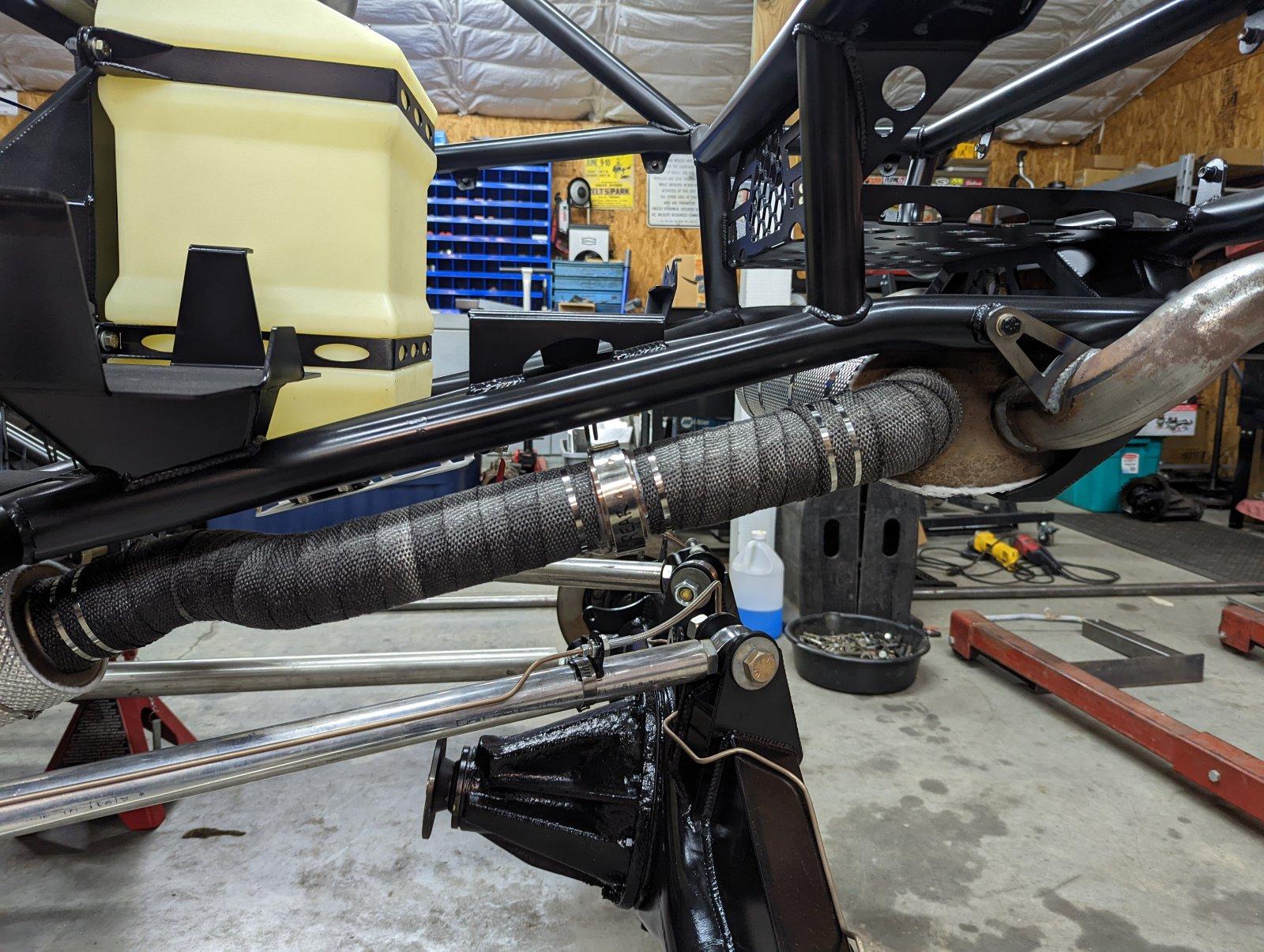

Few more steps closer. Front axle is in, plumbing is 90% complete, exhaust is wrapped and installed, trans and steering coolers are mounted. Hopefully get the air shocks rebuilt this week and it will almost be a roller. Waiting on the long side inner shaft from RCV and I'll have every part in hand to make it a roller.

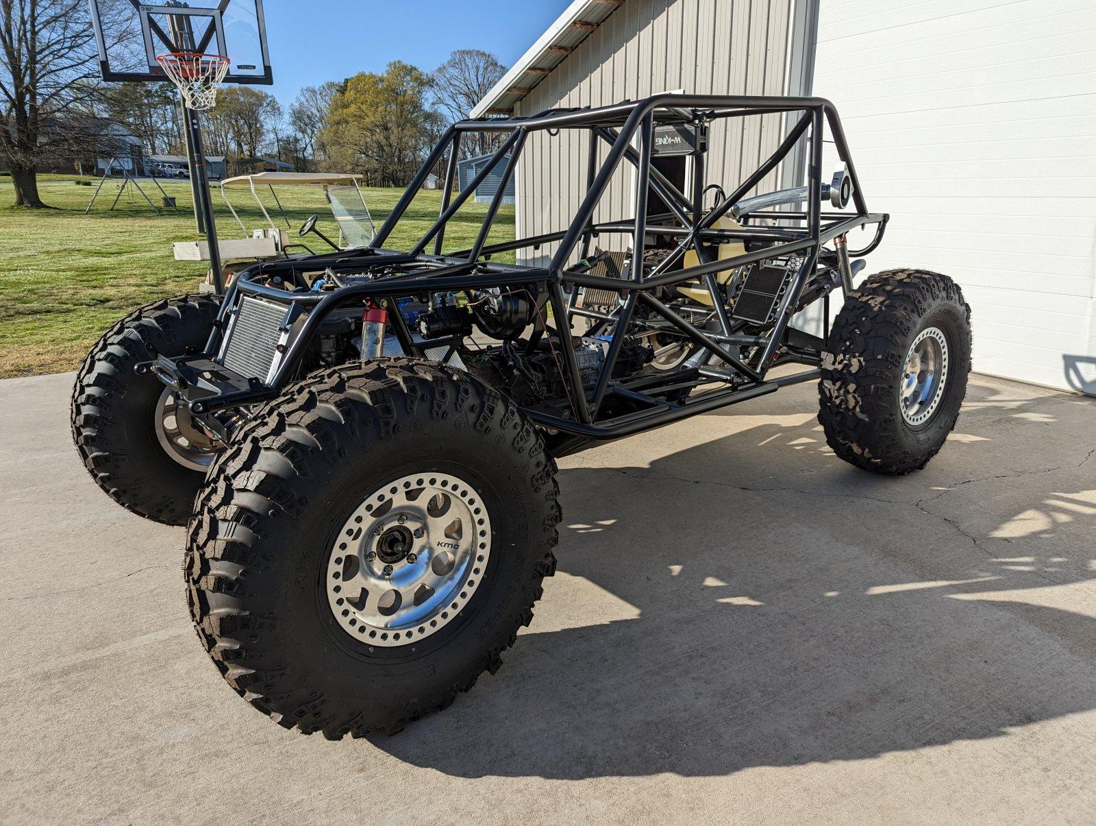

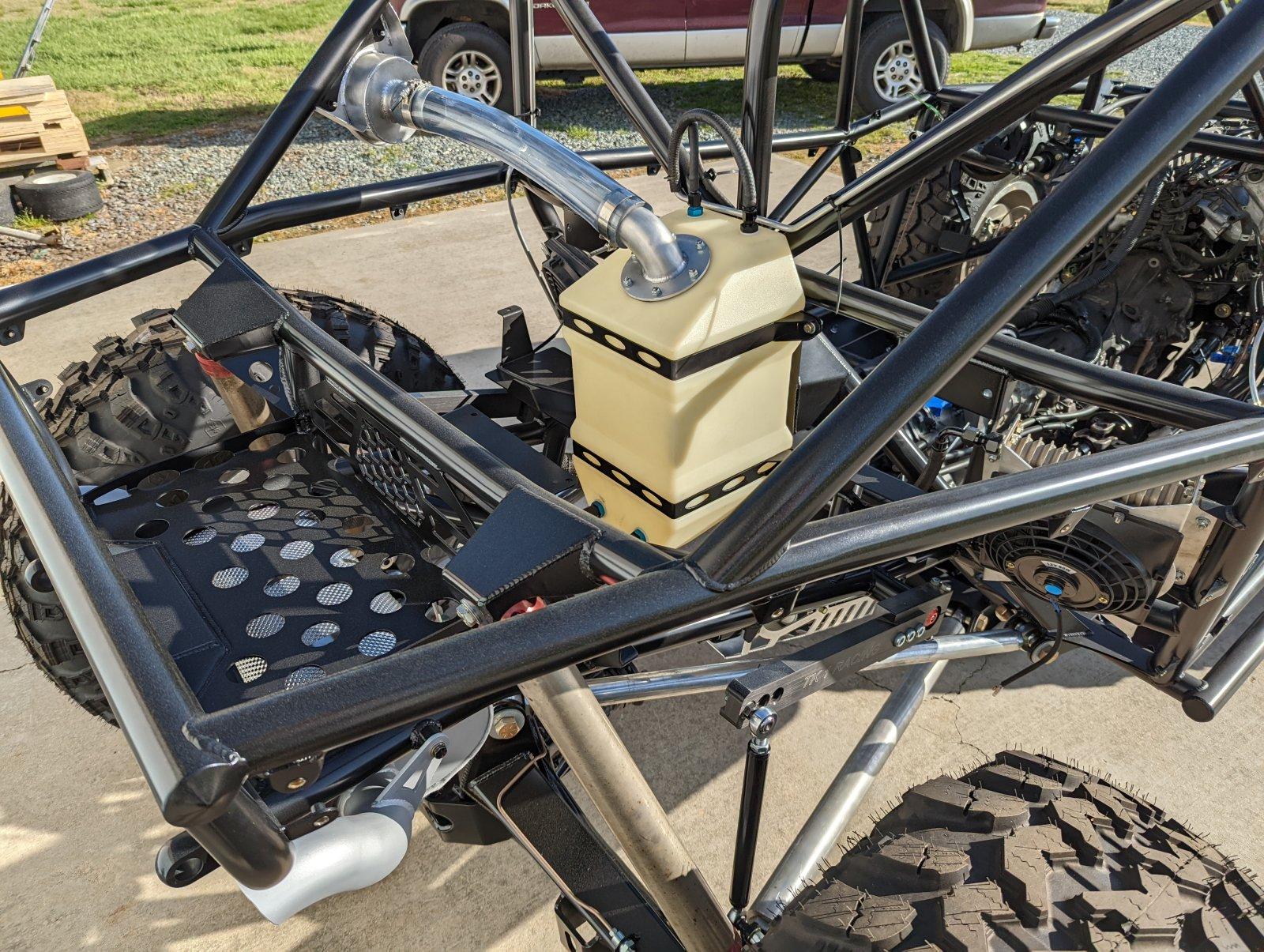

Got the air shocks rebuilt and installed, the rear is back to a roller. I got the knuckles shimmed, bearings packed and the long side RCV shaft finally came in. Need to clearance inside the knuckle balls for the birfs then I'll put the shafts in and install the knuckles and it will be a complete roller.
Radiator is in and now all the plumbing is hooked up. Dropped off the flanges and long travel slip to get the rear driveshaft made. It's coming along, won't be long now until it's ready for wiring and vinyl wrap on the panels.

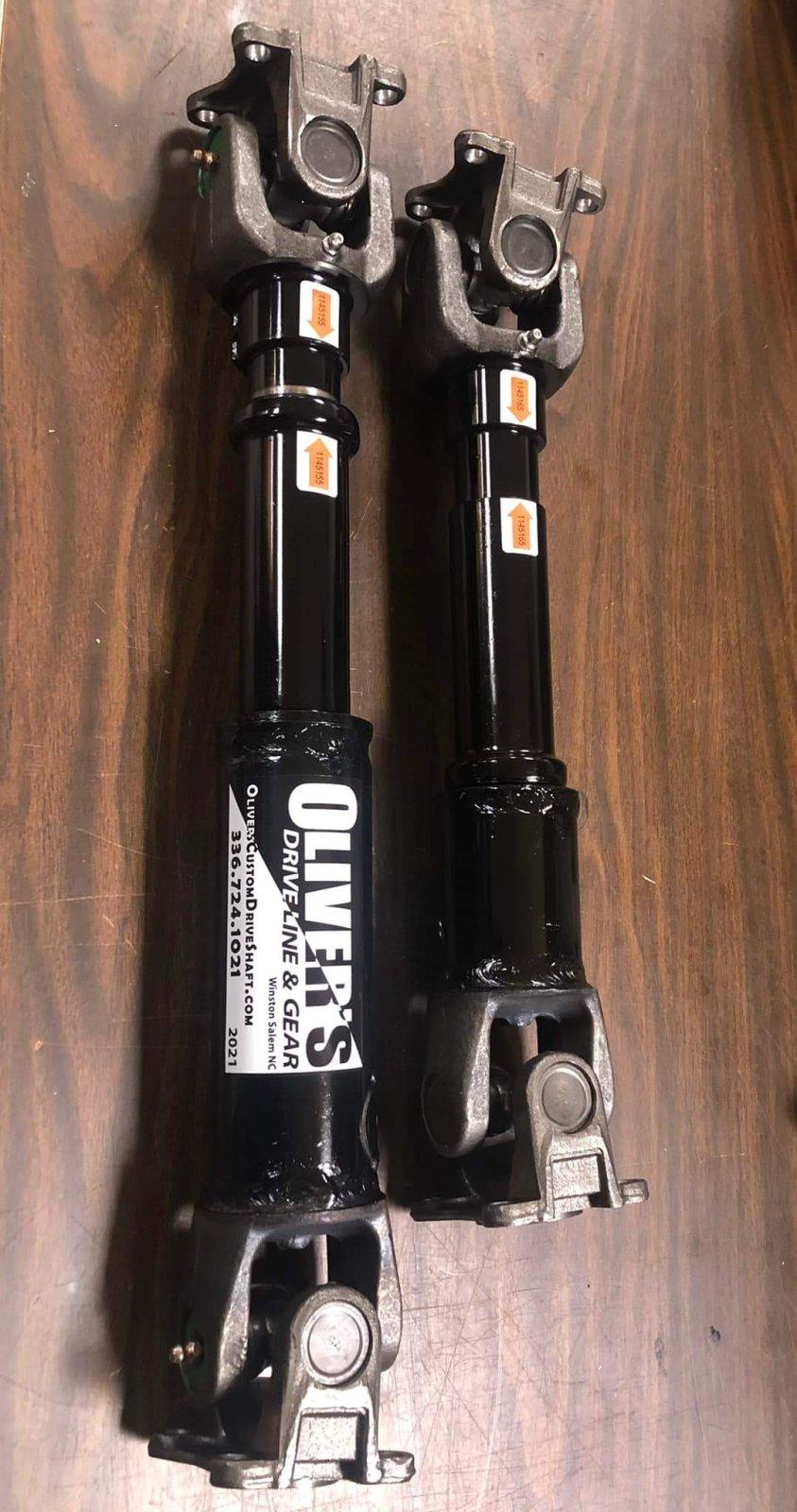

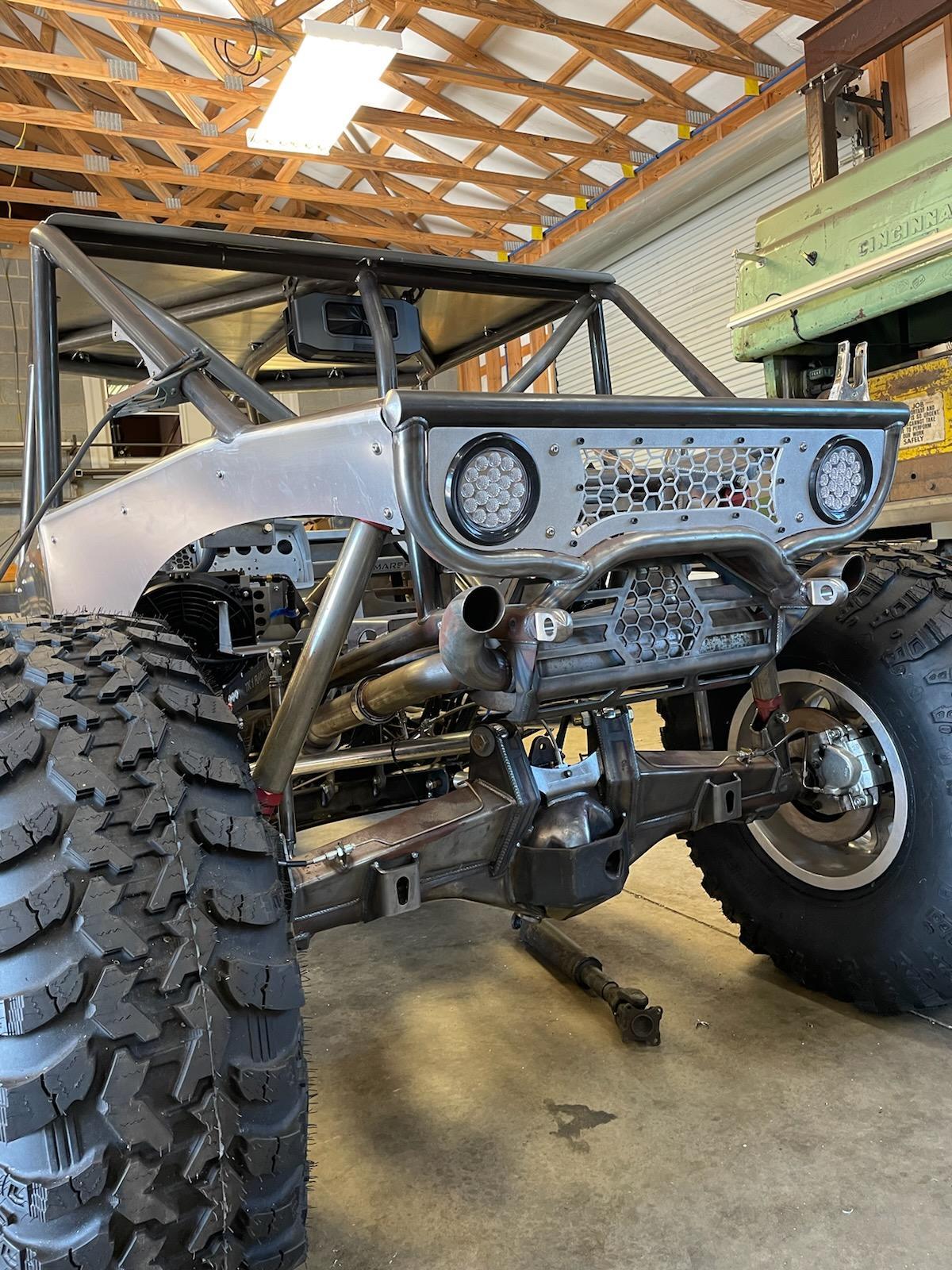

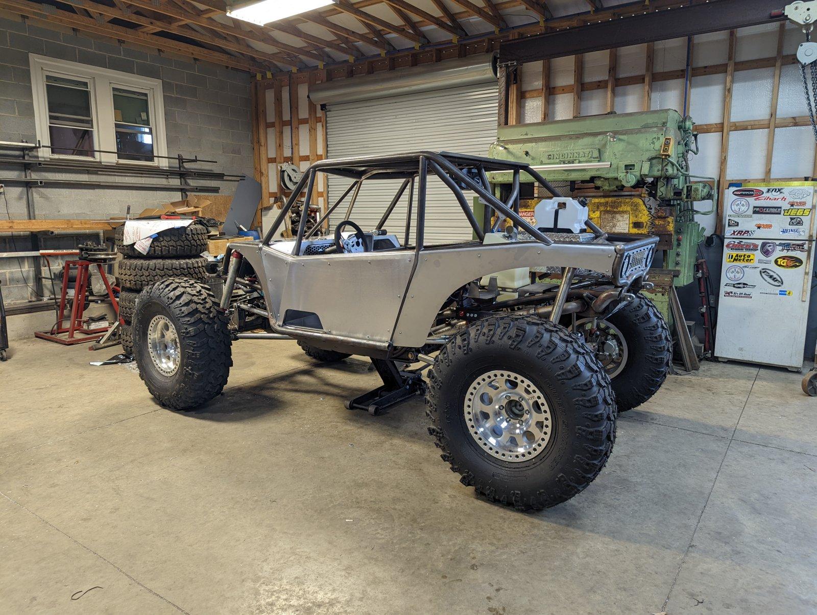

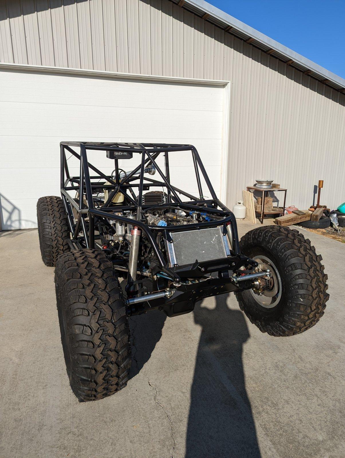

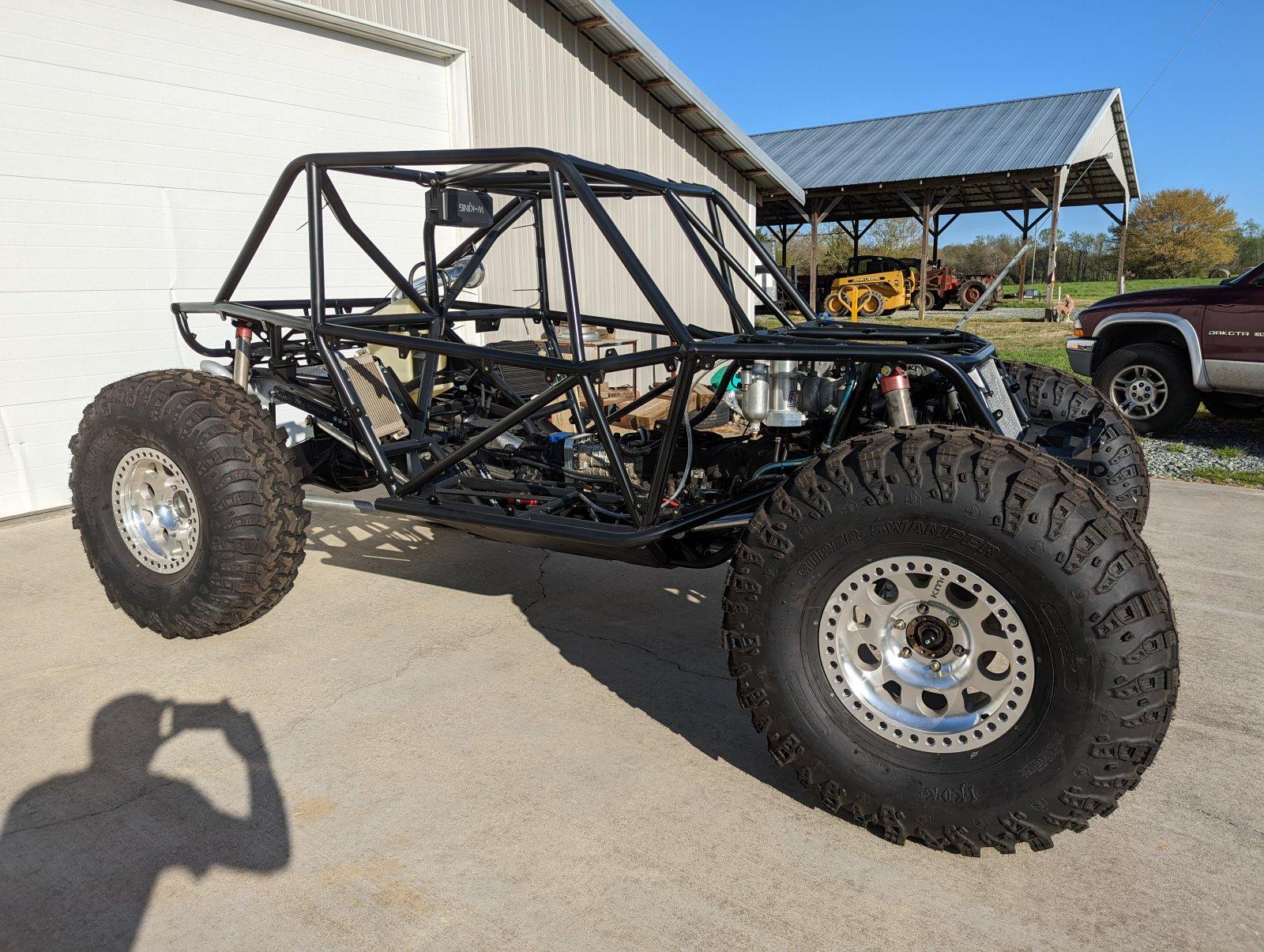

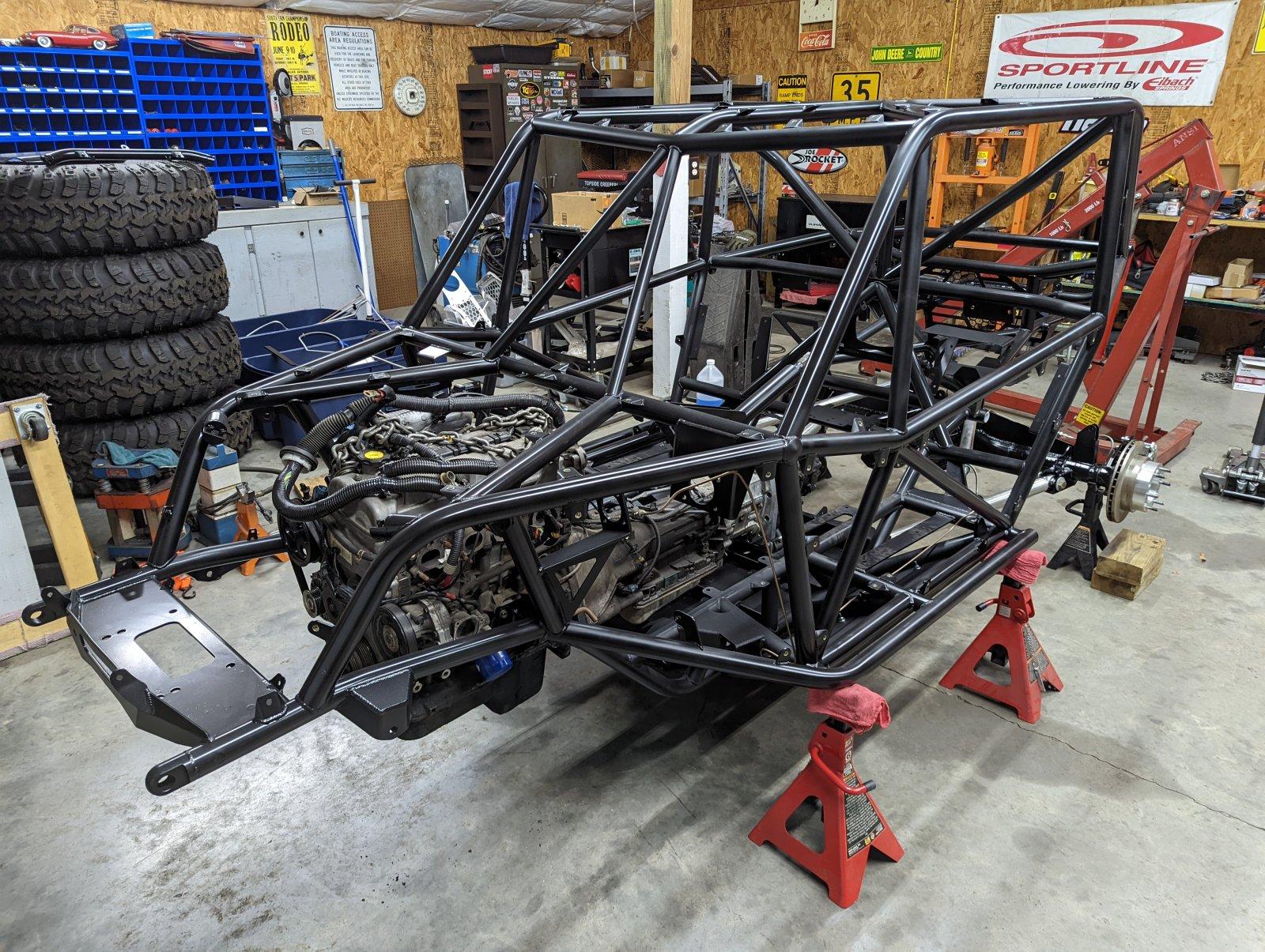

Plumbing is done, air shocks are rebuilt and installed. Front and intermediate driveshafts are installed and picking up my rear driveshaft from Oliver's tomorrow. Knuckles rebuilt and installed, RCV's are in.

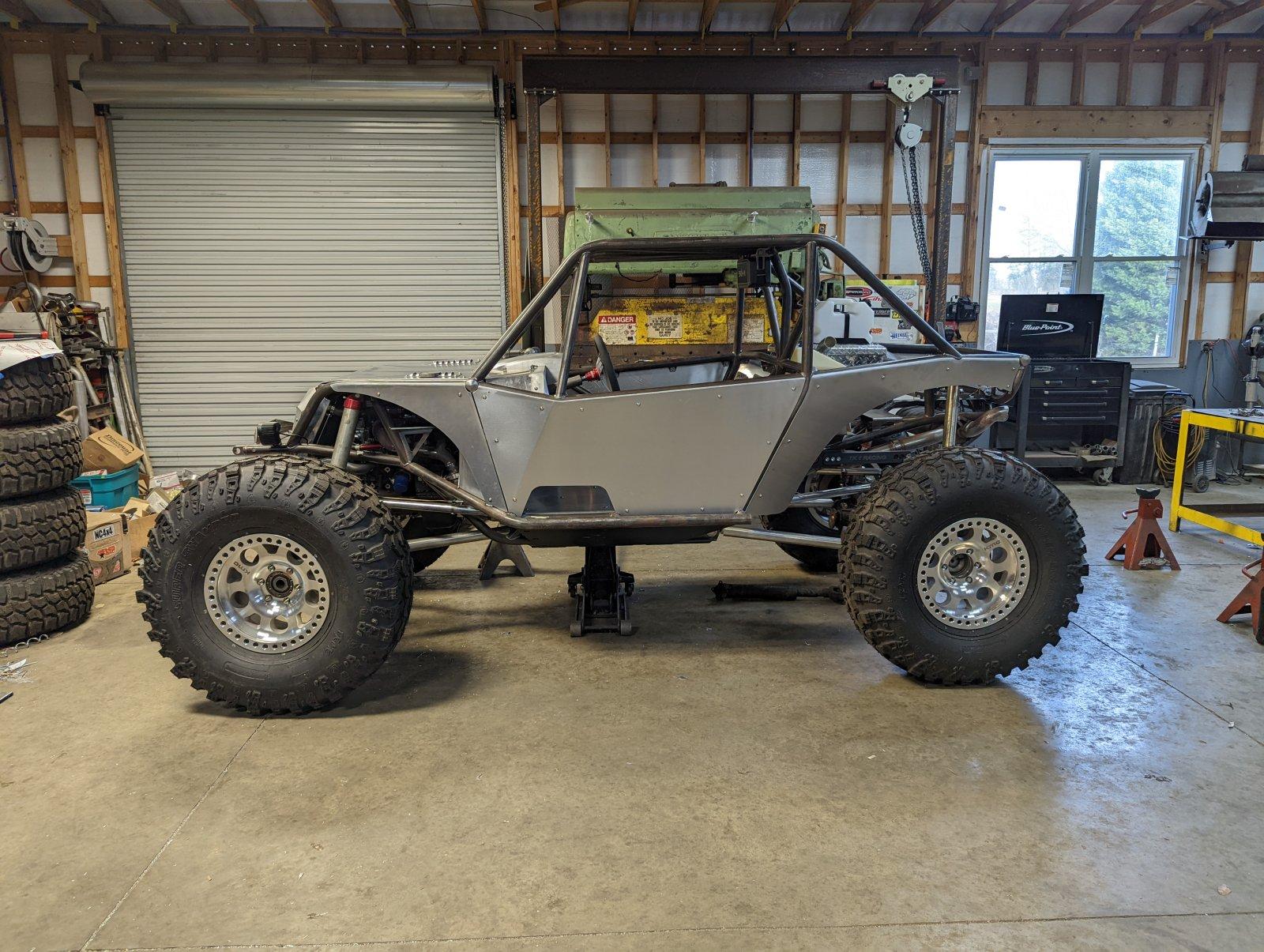

And best news of all, it's a roller. Even rolled it outside to get a good look at it.

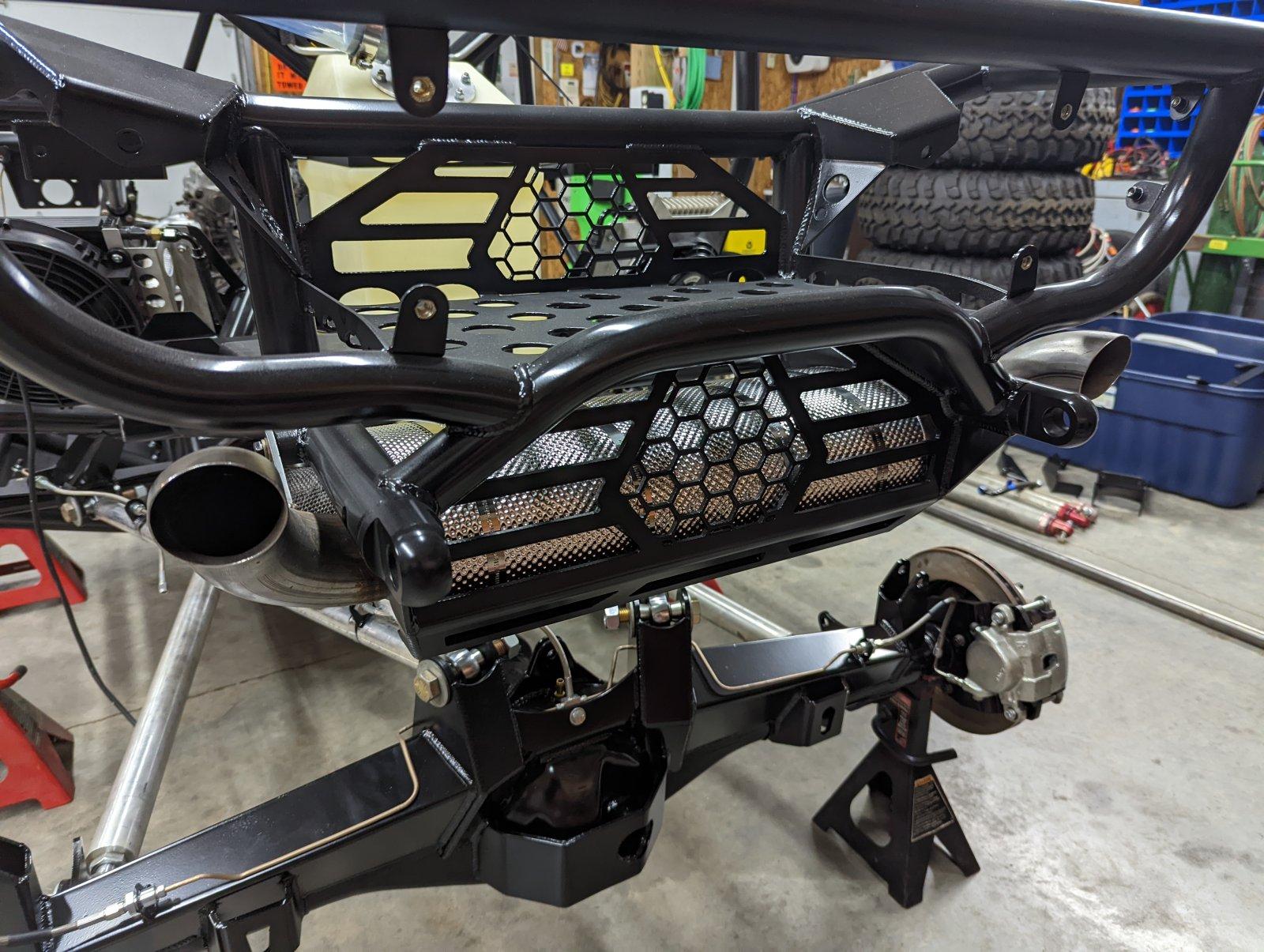

Hopefully it won't, it's a bit more out of the way than it looks in the picture. Plus the rear side panel should protect it some as well.

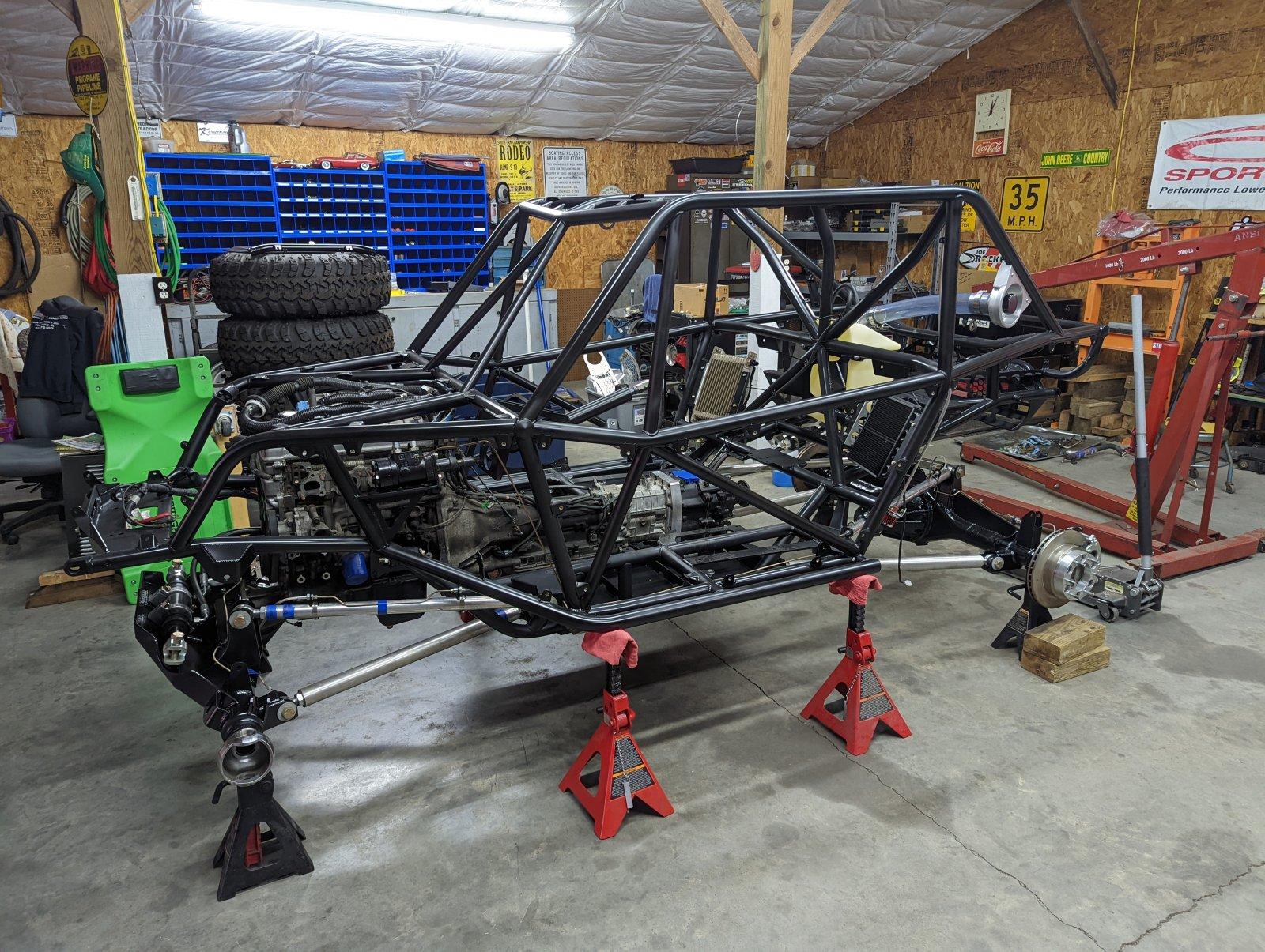

Still slowly making some progress. Going to start adding fluids to everything this weekend. The vinyl for my panels came in this week. And the biggest hurdle left is the wiring but I've had some help and got part of it done. It's gonna get done eventually, believe me I'm dying to get it out on the trails.
