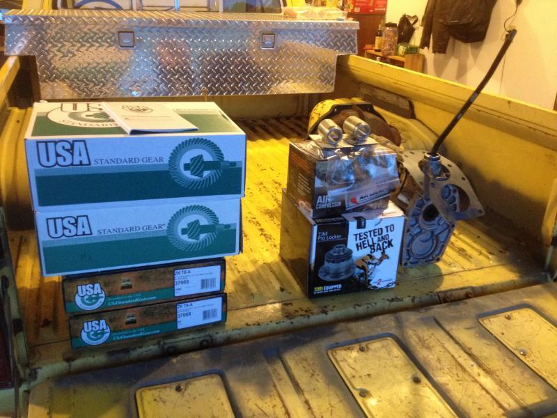

Ok, got back from a 2 week long trip and all these goods where waiting for me. I got a few small project to finish up in the shop in order to make room to start installing all this stuff. I still need to get a new clutch and a few gallons of gear oil but for the most part its all here.

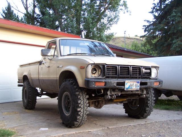

Those are the ones, got them for $500, picking them up tomorrow. I think these tires look sweet on these little trucks with little to no lift. Thats the idea, I want to get the job done without lifting the truck if I can. I may still try and perk up the front springs since they have sagged.
Here is a tease pick of a 1st gen with these tires.

Yer gonna want to run some sort of dual beadlock (Inner Air/Staun), as these things do NOT want to stay on the rims at any pressures below about 8psi...Ask me how I know. :redneck: Had an 81 with shackle lift and 34x9.5's yrs ago...ended up trading them for a set of 33x12.5" TSL radials...overall height difference between the 34's and 33's was lesss than 1", AND I could run em at 5 psi! :haha:
