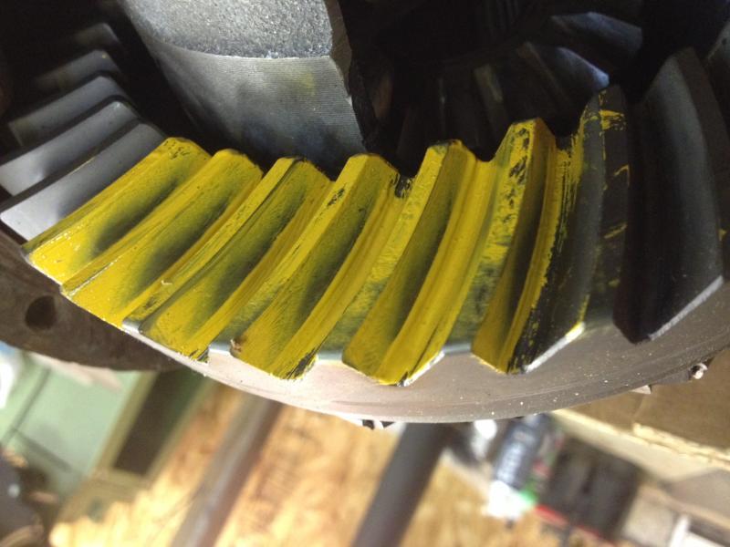

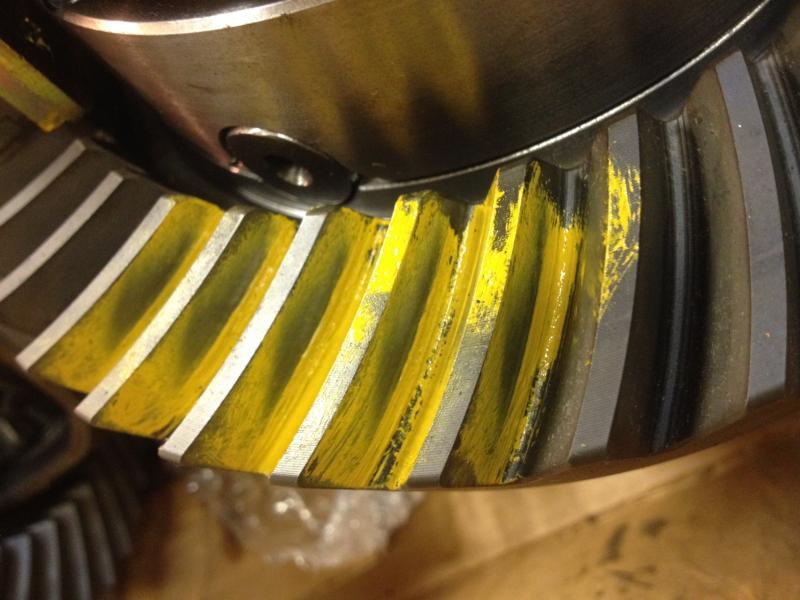

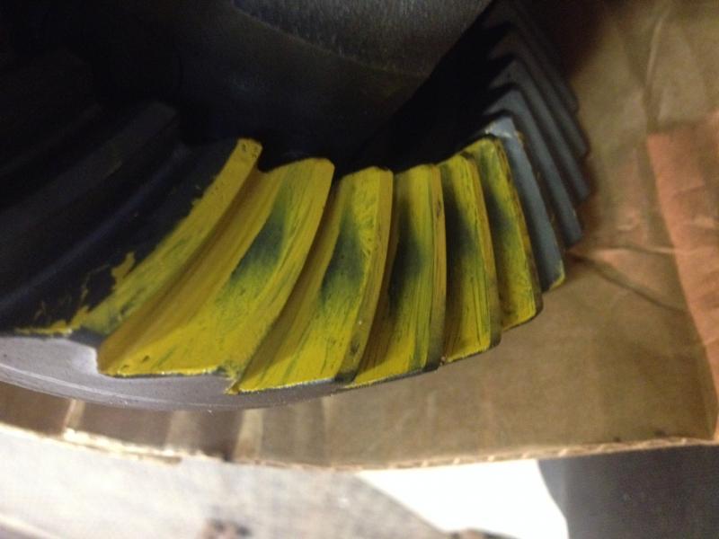

Ok guys, here is some more gear pattern pics. Let it rip.
Pics are Drive side rear, Drive side front, Drive side coast. The coast side rear is in the other page.

Oh Ya, Waaay too deep...Good thing it was caught now instead of after being run...might cost ya a couple pinion seals, but...
If the guy that set these up knows anything about setting up gears, he should have known this. Dana or not, a pattern is a pattern Nick...:awesomework:
Ok, so if you were going to correct this in one shop what would you do? Remove some pinion shims? .010"? Its the pinion depth shim not the preload shims. I also am running the solid spacers.
Likely not gonna get it in one shot, AND when you change pinion depth, you HAVE to change preload shims as well to obtain the proper preload......
Ya I kinda figure that out after I posted that. Take some off the depth and put some on the preload side. Ok, well Ill get it dialed in and Ill post up hear before I install them on the truck again.

Nope, Ask me how I know.! Here's the long and short of it...
If you add pinion depth shims under the inner pinion, you add pinion preload shims to take up the clearances..
IF you remove pinion depth shims (like in your case), you'll need to remove pinion preload shims to get the preload back...
The pinion preload will not change with depth changes. Your not typing what you should be thinking! :redneck:
Nick,
The pinion head has shims under it to set the DEPTH. The solid spacer has shims on it to set the distance/preload of the bearings. This shim pack needs to be left alone if the preload is acceptable as it sits. Pinion preload should be 10-15 inch/lbs with NO pinion seal and no carrier installed.
The shim pack under the pinion head will need to be a tiny bit shorter. That will let the pinion head be closer to the bearing or further away from the carrier/ring.
Remember to locktite the cap bolts and spanner lock tabs (12mm) once your all done.
Now I understand your thinking. You shim under the bearing RACES, correct?
I shim behind the large pinion bearing. Just my preferred way and its simple. :beer:
No, I do not use shims under the race, NOW if the guy that set up your gears Nick is using shims under the race to set depth, it WILL change your preload therefore requiring a change in shims... I Digress Choppy, I got my D44-60's/Toy's mixed up...:haha: :awesomework:
Bottom line is, make sure your depth is good, AND preload is set properly, and backlash is good, AND everything is lock-tighted (red)...

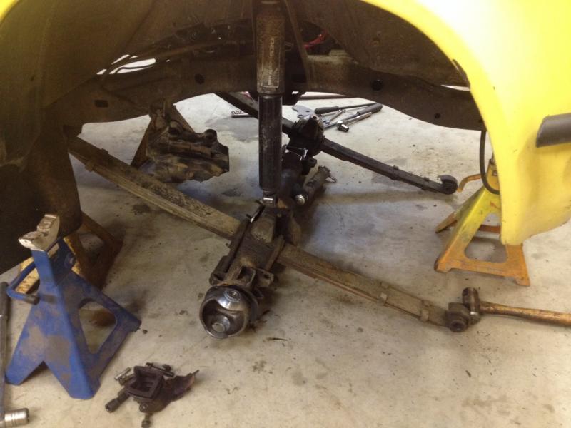

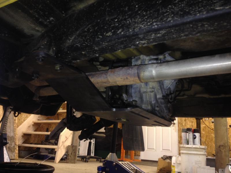

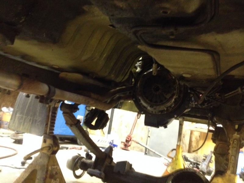

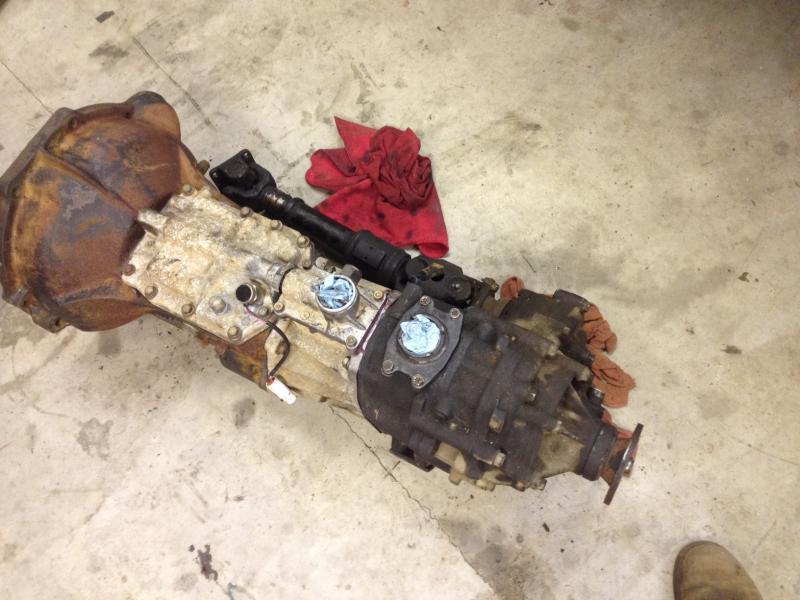

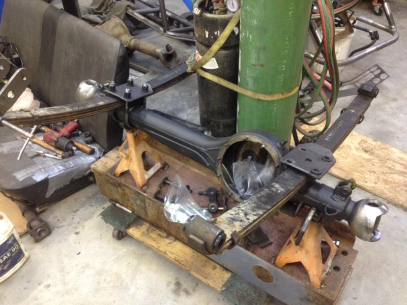

Ok, getting a few more things done on this. I got a little lazy for a few weeks but now I am back on it. I have also been running down parts and building some cool stuff. Thanks to lots of great folks on here, this little truck is looking sweet. I was able to get the 5 speed and new clutch back in and test fit the custom skid plate. I also got the front axle all cleaned up with the extra brackets removed, rebuilt the front spring packs. I used the factory front main and 2nd leaf, then used a factory rear main and 2nd leaf. I cut the eyes off the rear mains and bolted them up to the factory front pack. Im thinking it will help bring the front off the deck and make room for the 34s.
    73.4 KB
    54.2 KB
Get some lift shackles for the front.
Whats that bracket/flatbar coming off the back of the passenger side over that jackstand?
Ya working on the shackles now. Not sure what bracket/flatbar thing you are talking about? On the axle?

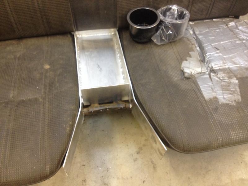

Worked on a little custom center console before I send the seat out to get covered. It will have a switch panel and 2 beverage holders.
