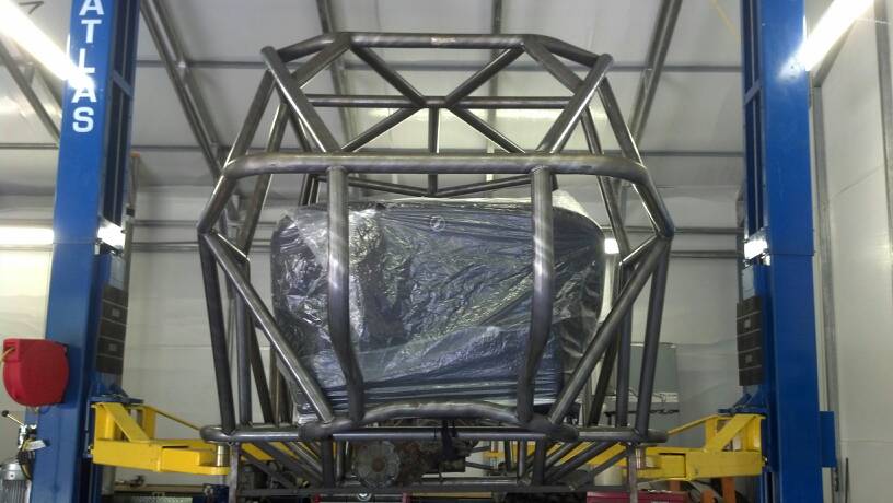

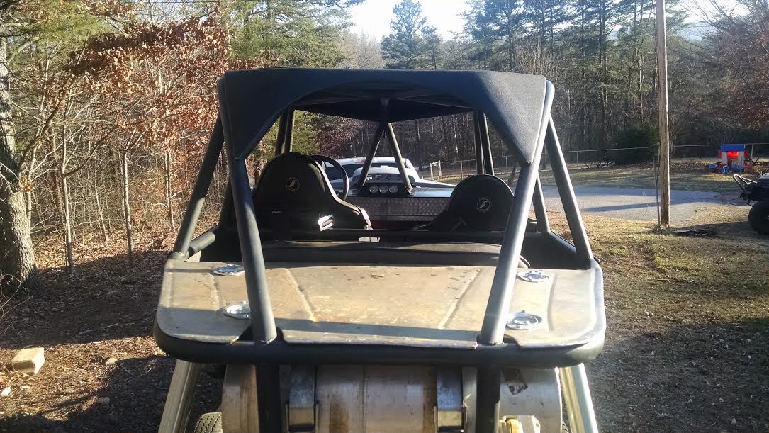

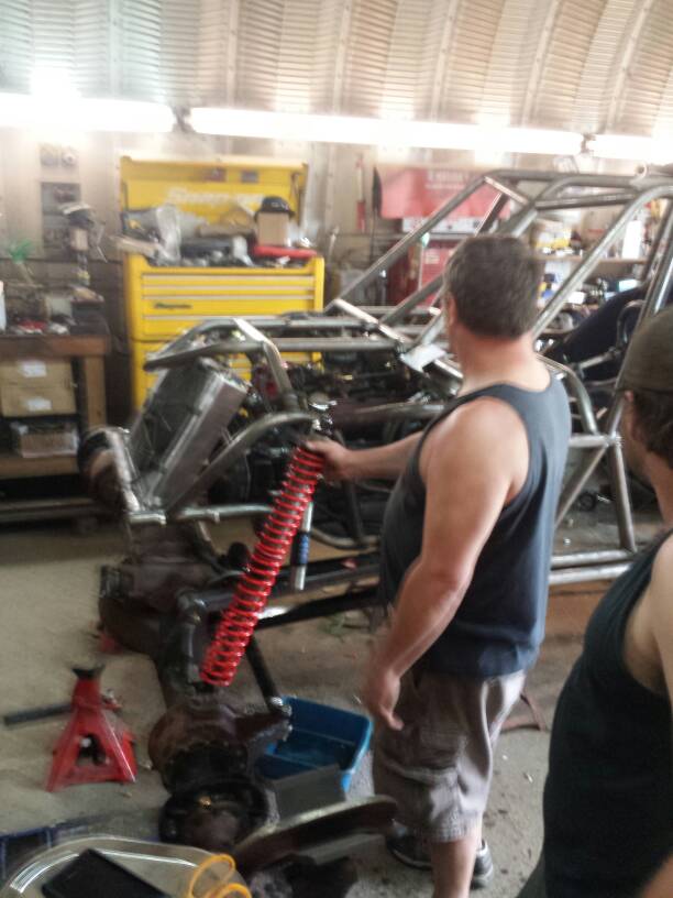

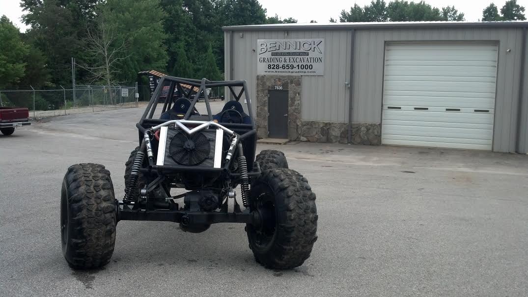

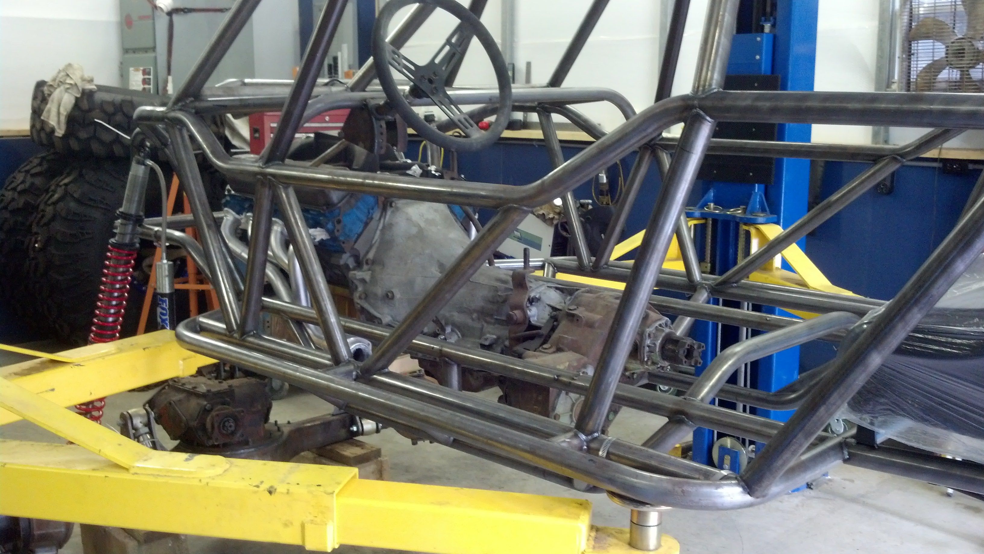

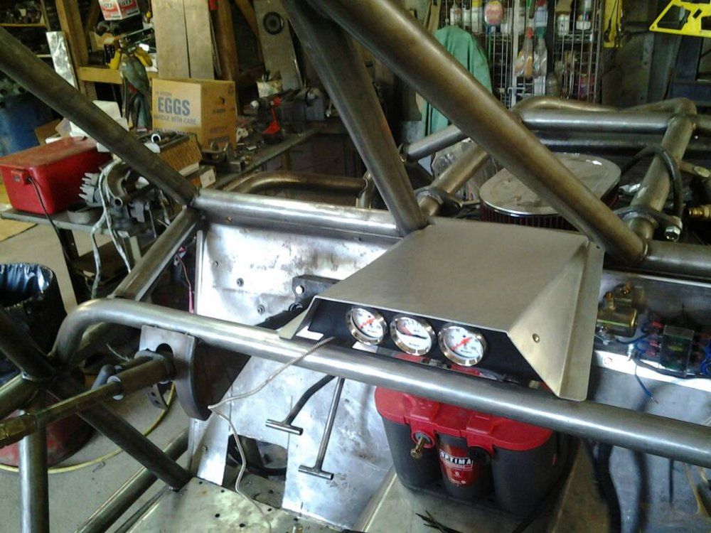

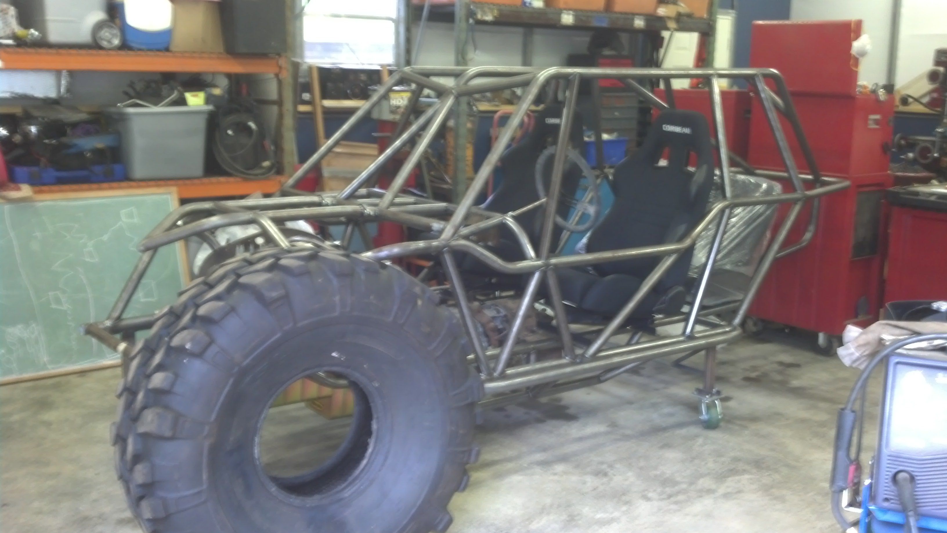

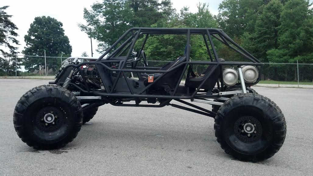

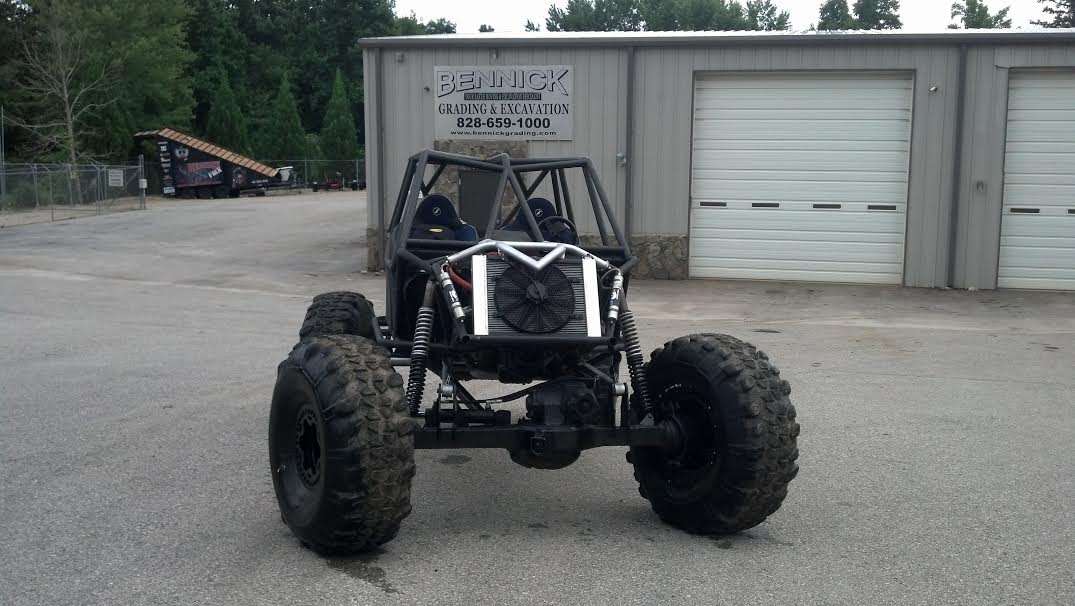

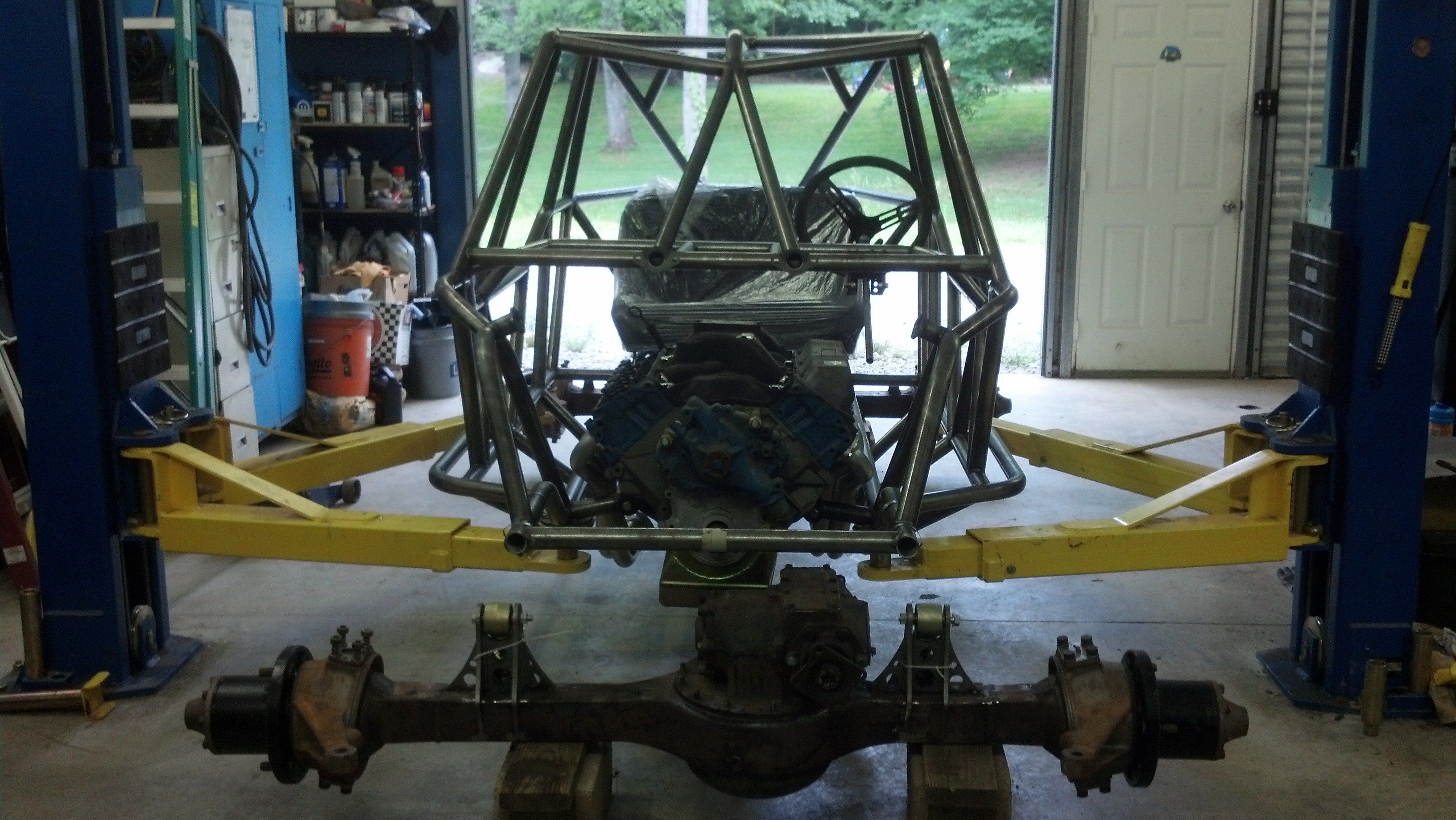

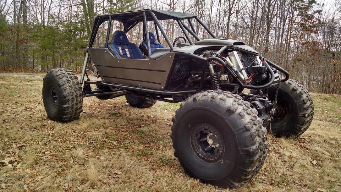

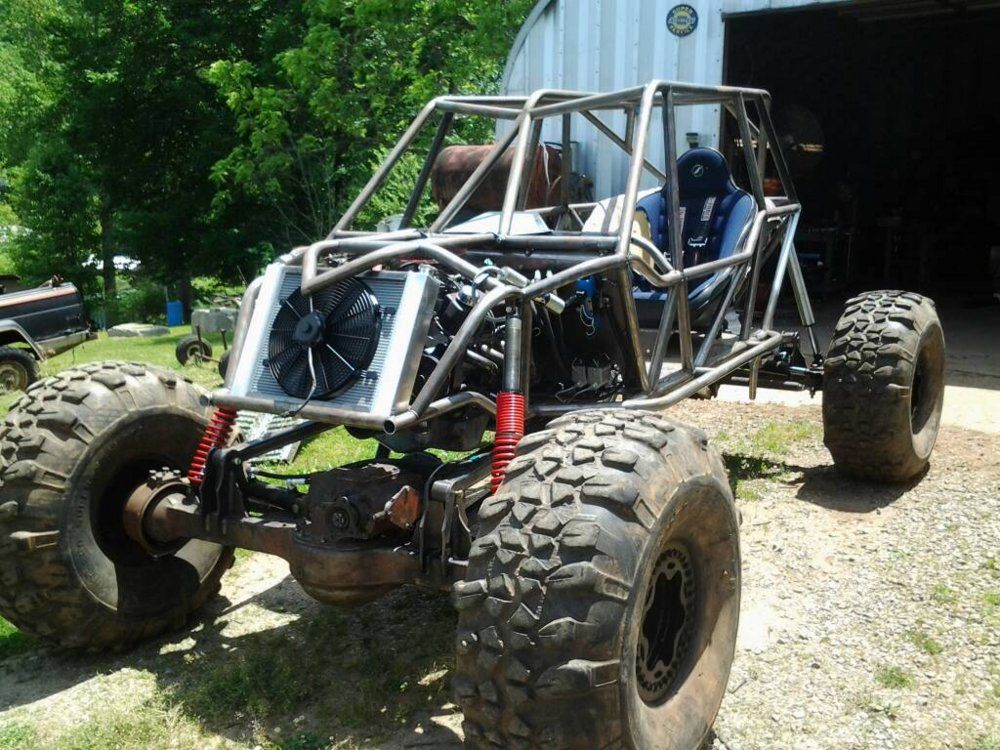

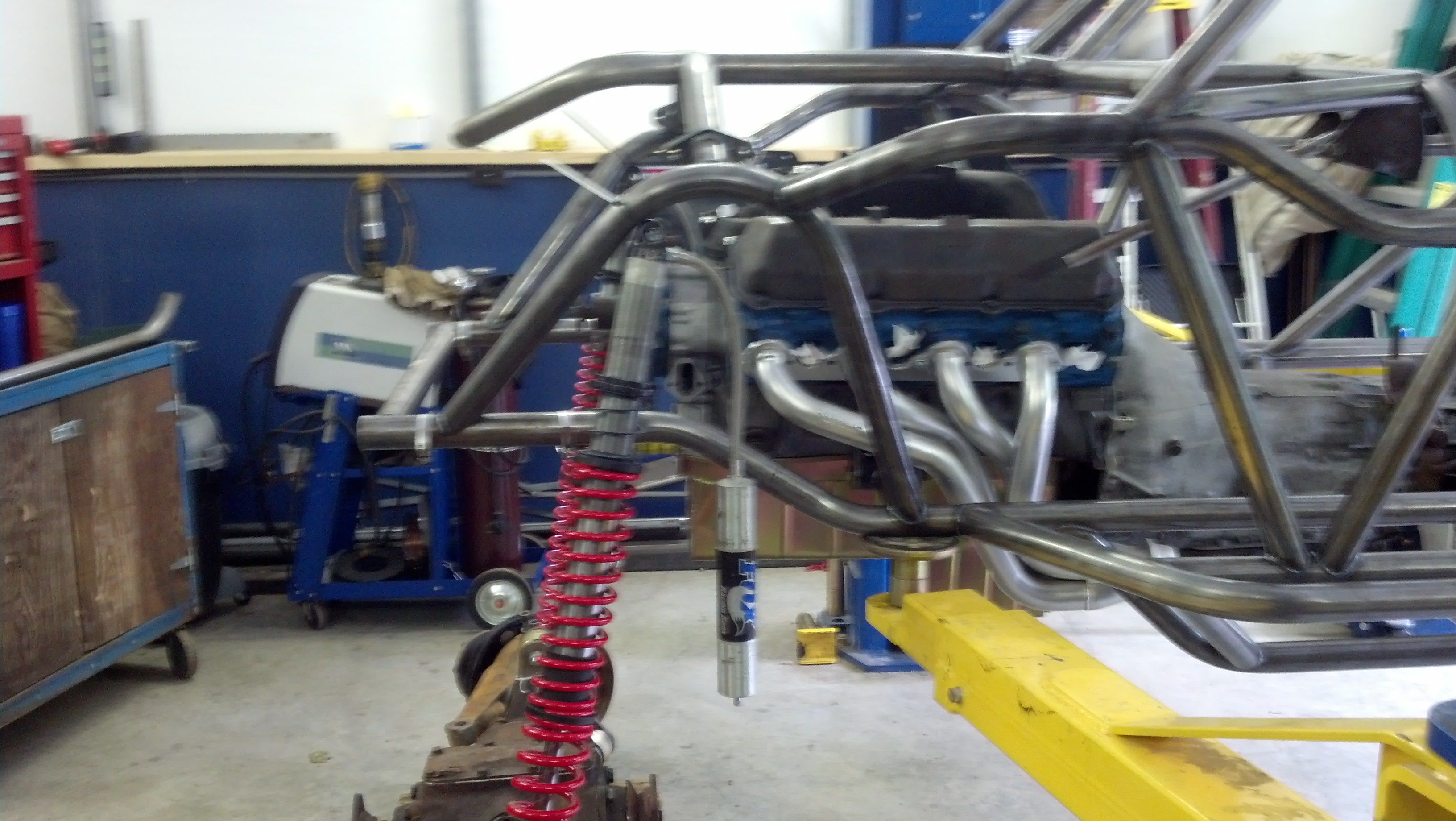

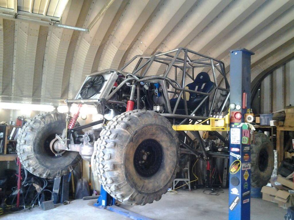

The buggy is about 95% so there is a little work to be done like the winch and tube work around it and brace up the bottom and she will be done!
Thanks to Chris @ BUCKEYE PERFORMANCE INC. for doing a lot of the work on it!
Here are the specs on the buggy:
Chassis is from MARSFAB

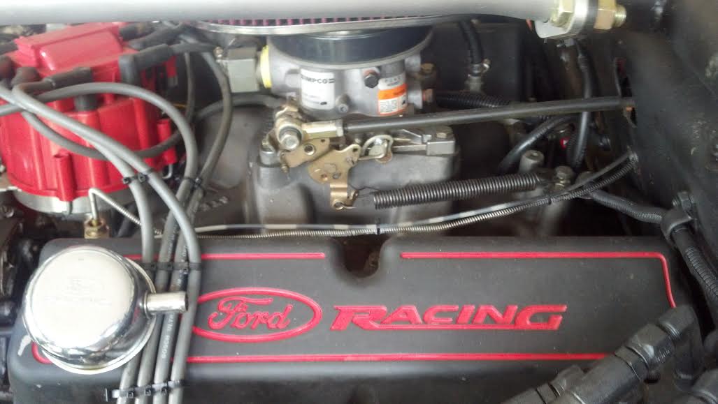

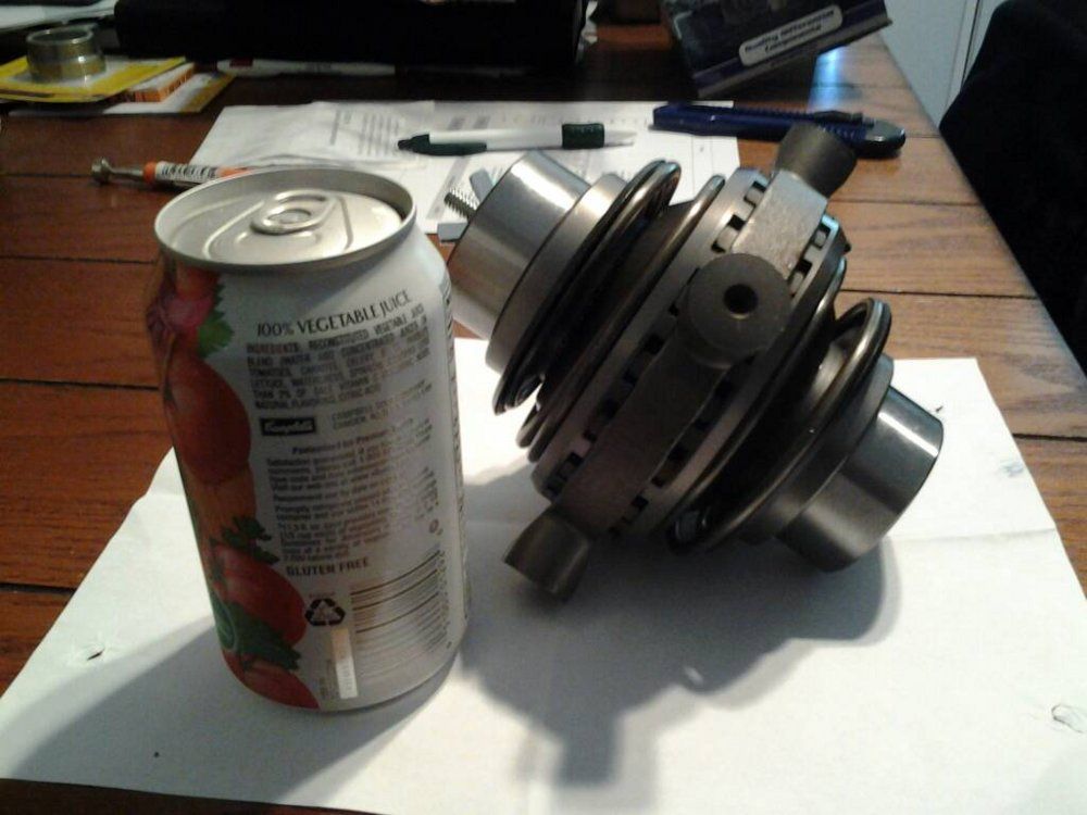

F/R steer rocks grizzly locker
built 351 Windsor on propane
C6 tranny w/ 203/205 doubler
Fox 2.0 coilovers and 2.5 air shocks
44 swampers
Corbeau seats
wheelbase 130'
Smittybilt 8000 w/ rope

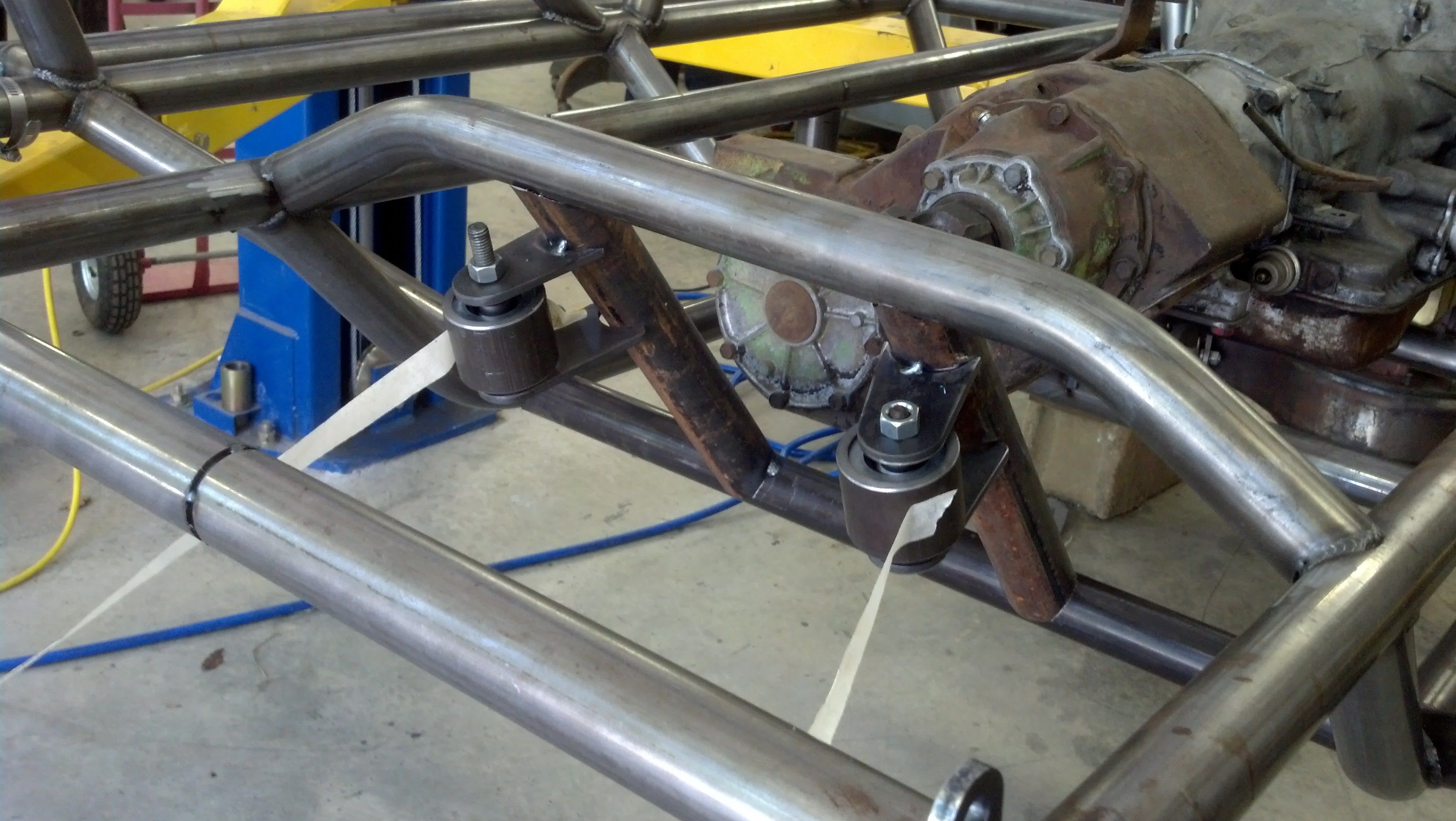

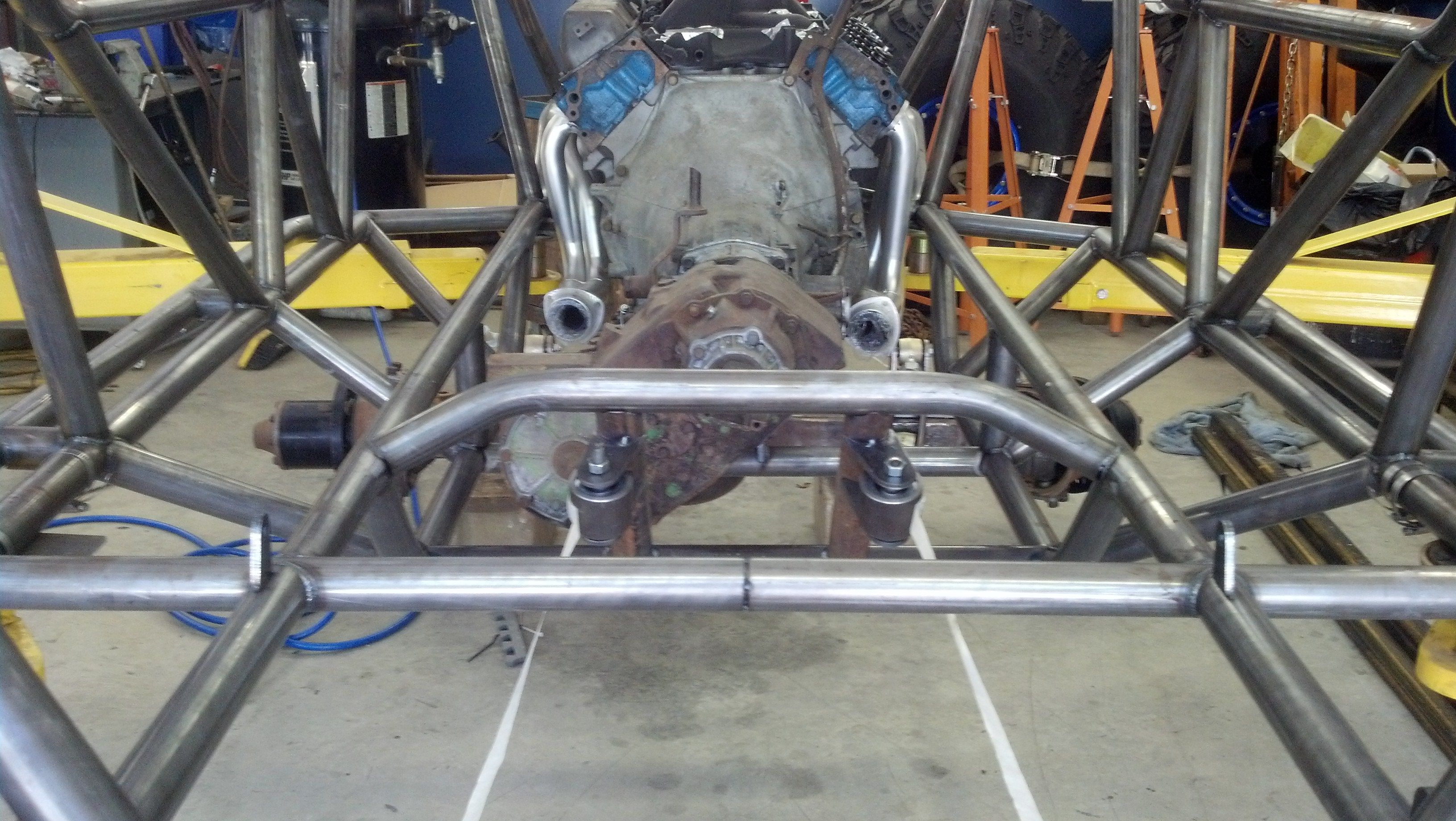

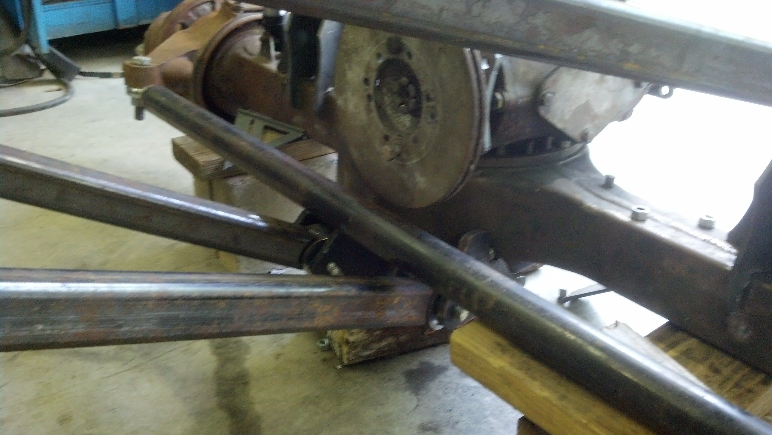

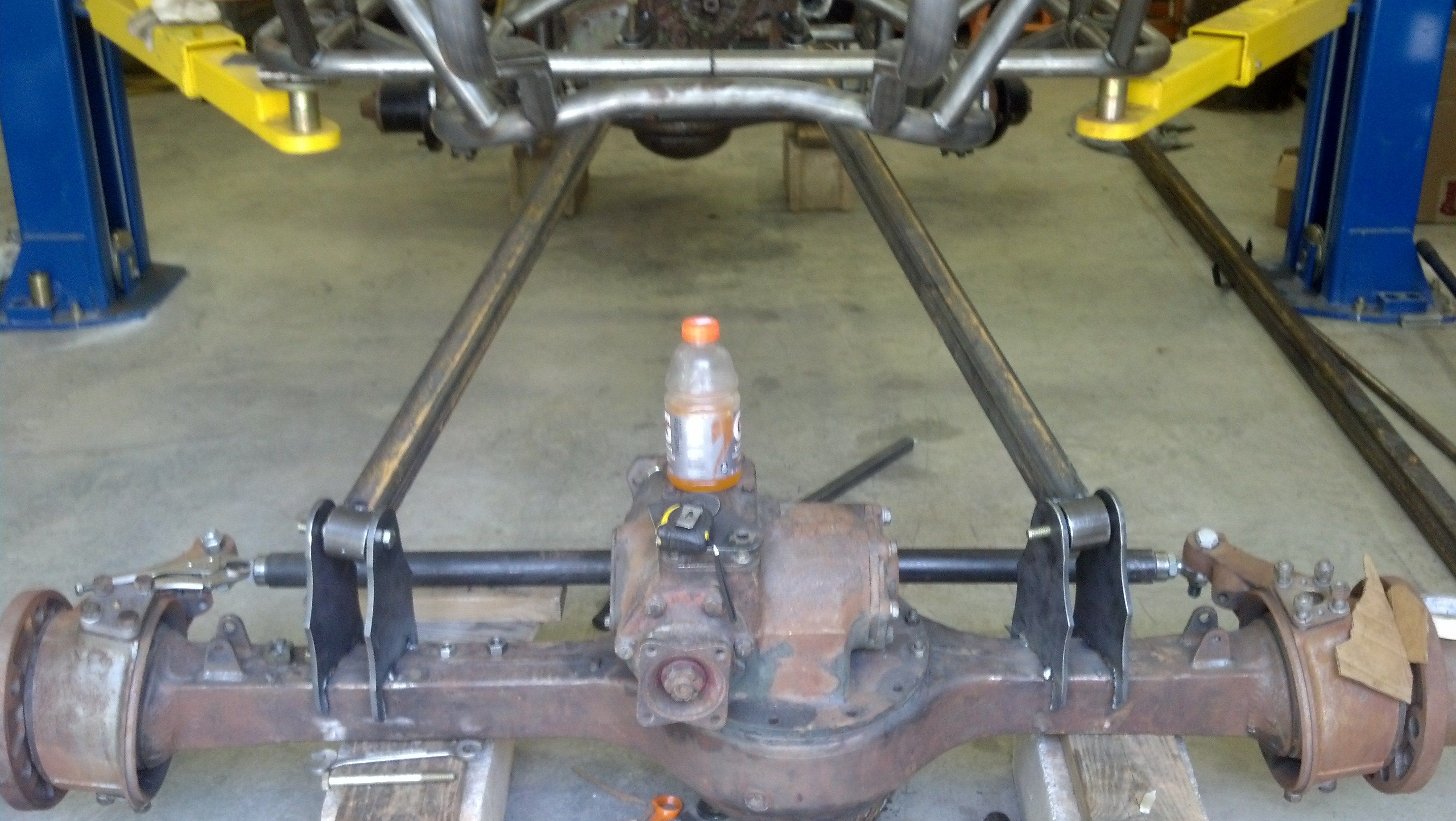

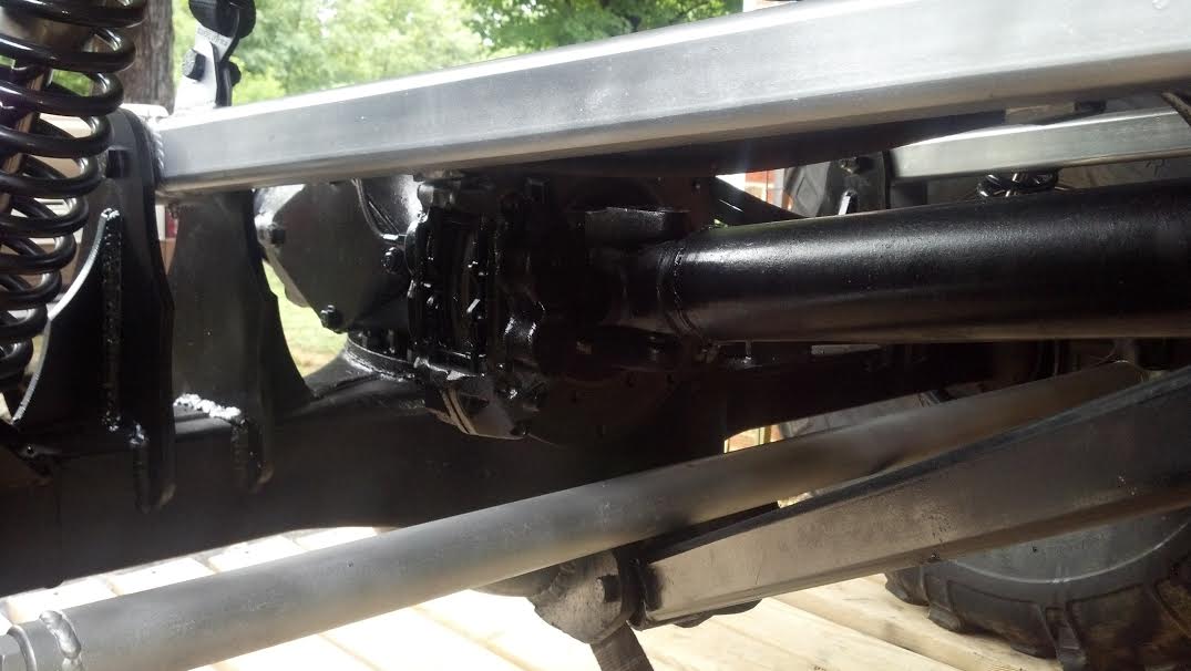

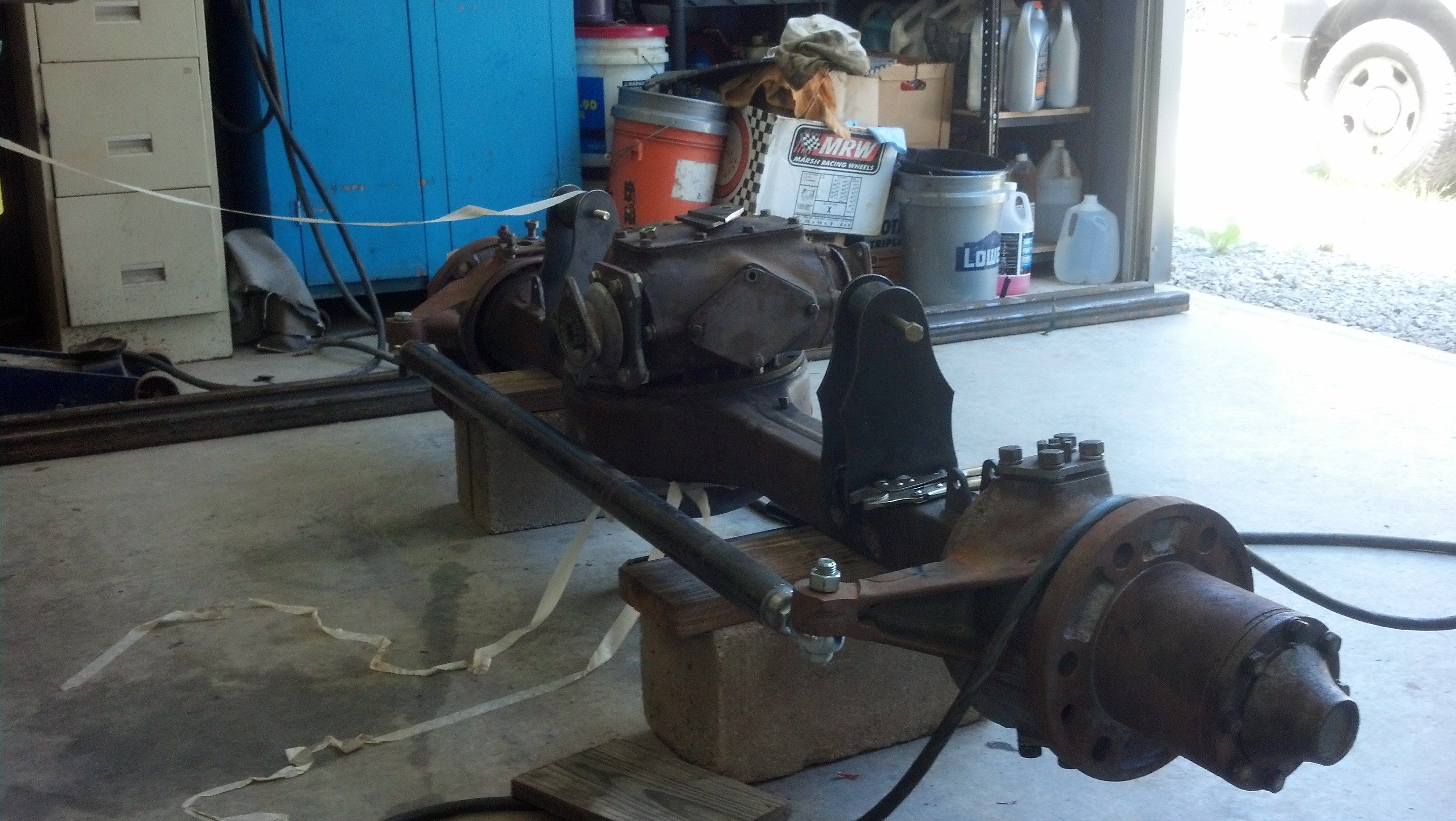

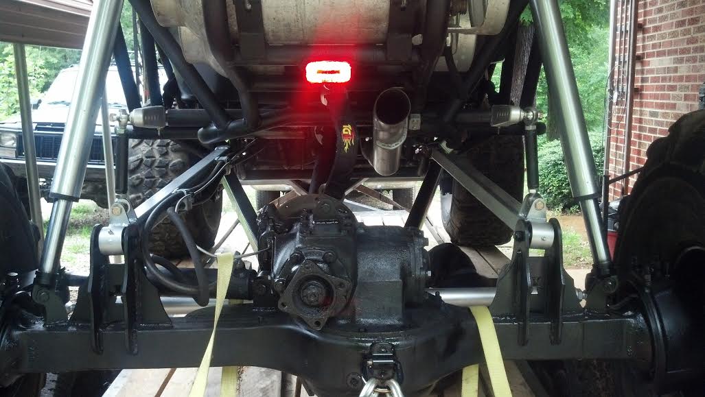

You can see it in the picture showing the rear of the buggy. He just come off of the axle with a small plate and mounted it. Very simple.
I like the sq links . I put them on a buggy a few years ago an they are still holding up great . surprised the **** out of me :dblthumb: nice build

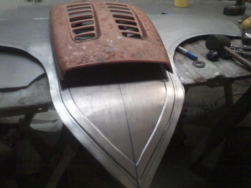

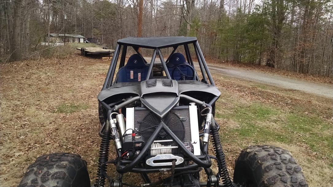

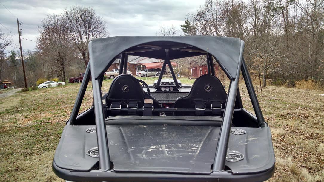

Got some skins on the buggy. I wanted something a little different than the normal so my guy hooked me up. His name is Nathan 828-403-1004. He has some different ideas for sure. I still have to paint them and will have some better pics once it is done.
