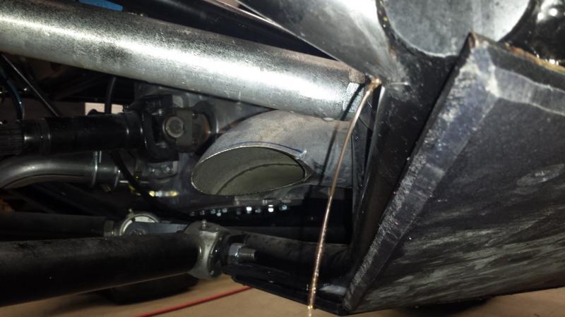

So in readyness to run it--I figured I would get coolant in it.
Fawk it leaks at a welded joint---another thing to fix :mad:

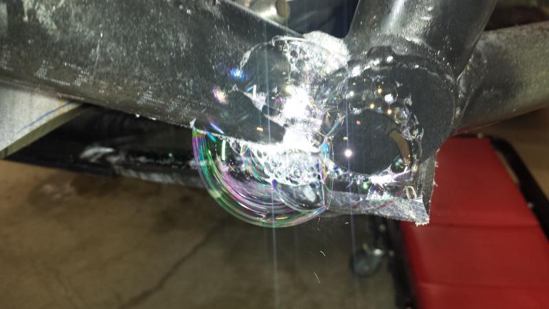

So I built a tool so I could properly pressure test the system with air because I was finding more leaks in the system at welded joints.

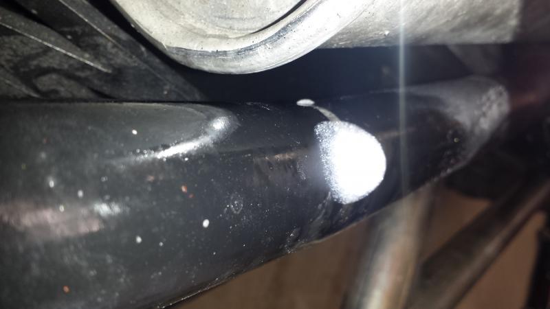

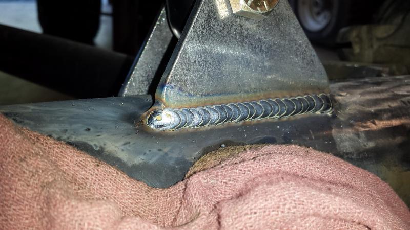

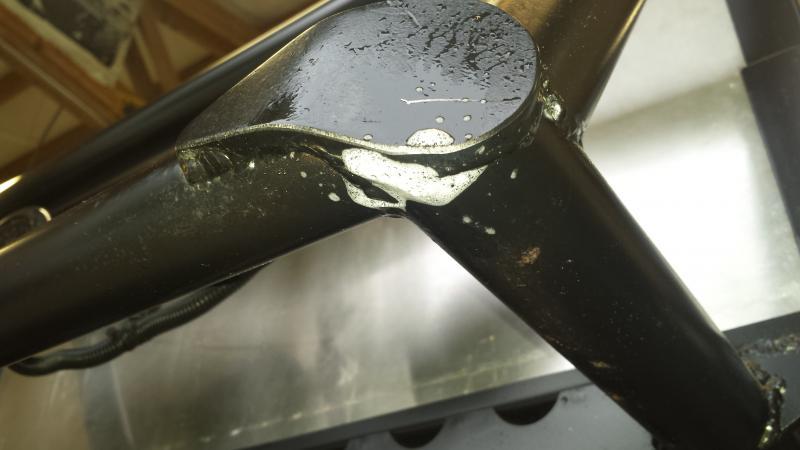

So I got the tool hooked up and what I was finding there was no way to drain the coolant out of the chassis-it was only seeping coolant. #1 that makes it difficult to pinpoint the leak and #2 trying to weld it will be difficult. So what I ended up having to do was drill a hole and drain the coolant and then plug weld the hole back up.

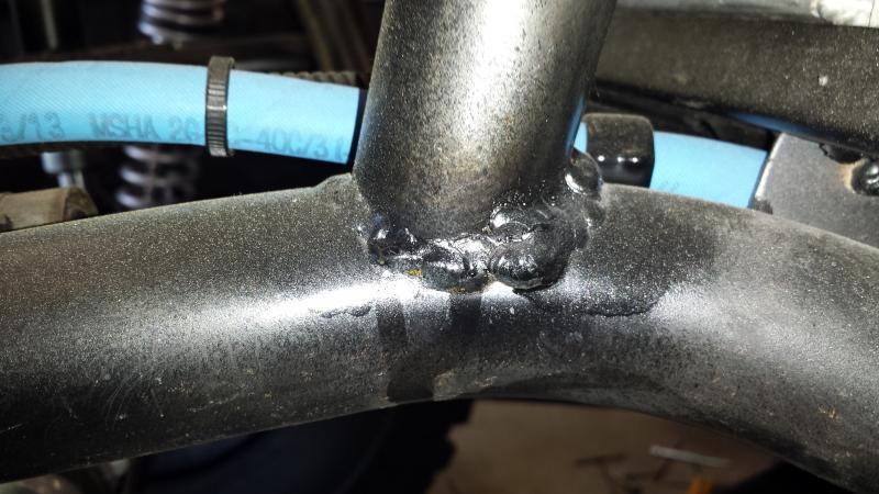

So there were 5 separate leaks in the short section where the coolant goes thru the chassis--5.....
One was right in the middle of a tube where 2 sections were butt welded..
It took some work to get them all fixed but I finally did and ran the system and got the coolant all topped off,,,

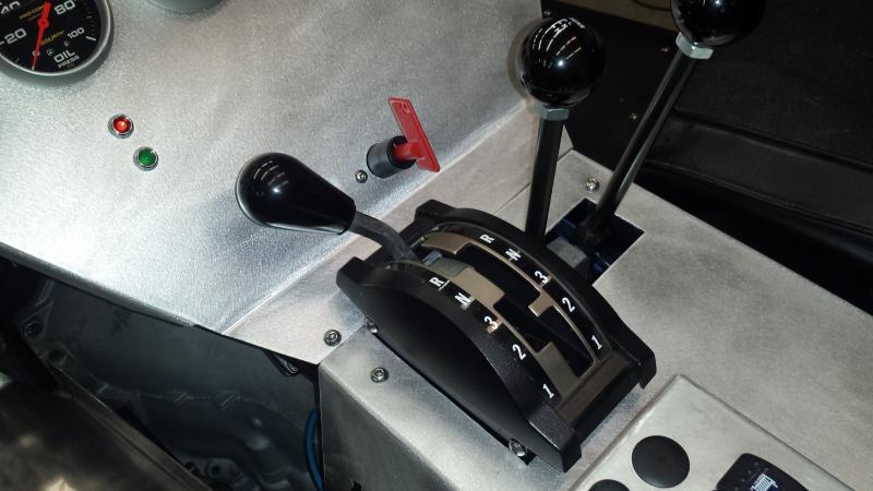

So I made a couple tweeks. First I moved the ignition switch back on the switch pod. I found the shifter knob was very close to the safety portion of the switch. I also had to put a little bend in the shifter itself to help with clearance against the t-case shifters.

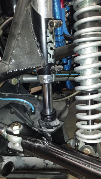

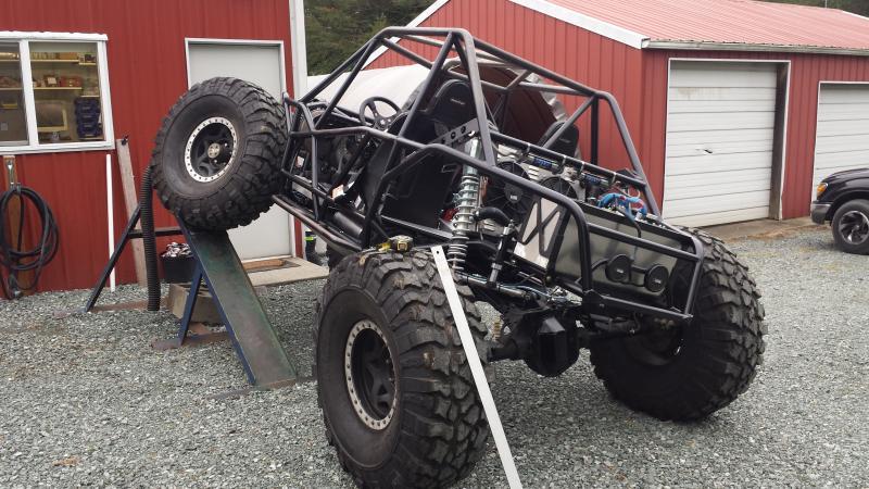

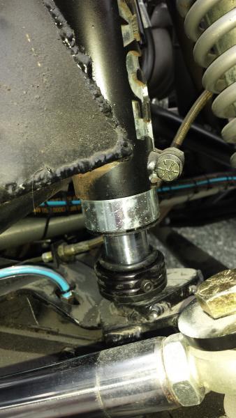

So on the way up the ramp I could feel the rig binding up. Well ya guess what I found. Guess what another fawked up thing. :looser:
So the shocks sit at roughly 12 degrees in. The upper mount will be a pos to rebuild and move. I took a bunch of measurements and I can move the lower shock mount inward about 2.5" and have the shock at 5 degrees. I know thats not "perfect" but from my own experience I have found it will not change the performance. So I called and talked with matt and let him know what was happening.

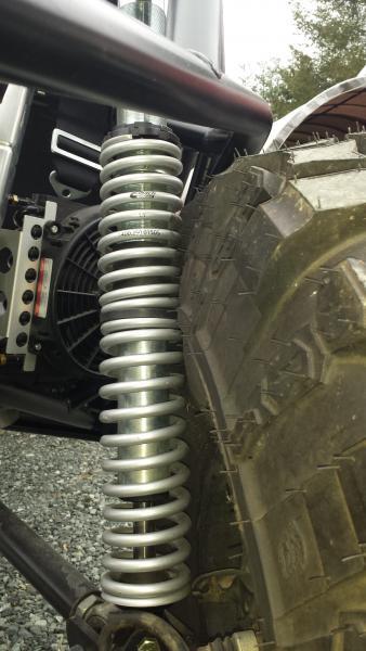

Also here is the rear air bump. Right now the tire is about 1.3" from hitting the chassis and stopping. Yet another fawked up thing.. I ordered new cans and going to cut them off and drop them down.
So these are the front air bumps from ride height to about 1" left of shock compression. The fronts are 4" and the rears are 2".
So I am thinking of swapping the front with the rears. I have to get the rear coilovers moved and cans cut off and do some measuring.

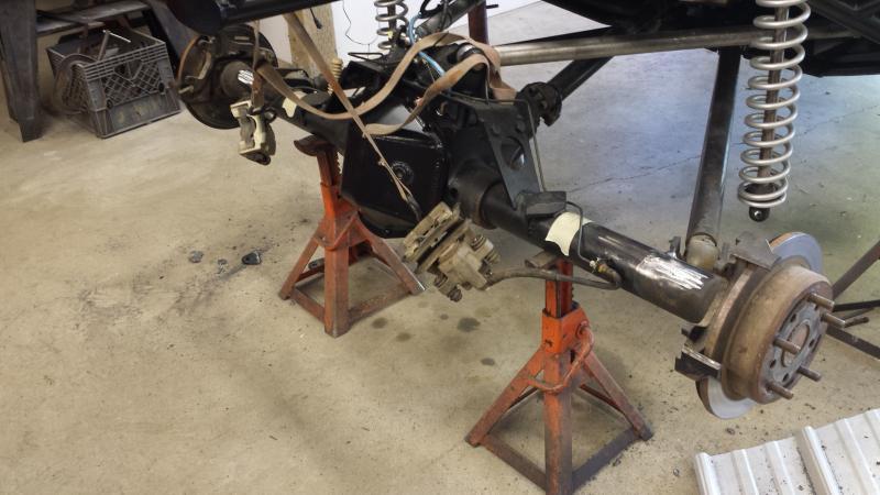

So started with getting the rear coilovers situated. cut old mounts off and made new ones...
