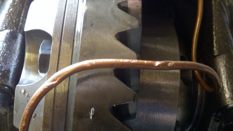

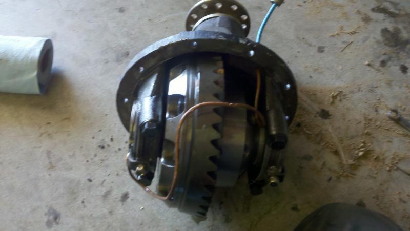

I didn't see all the stuff you told me to check Brad since I was in the garage already. I pulled the 3rd out and tried locking it in with the ARB compressor. Didn't make a single sound or noise when engaged.
I'll post up a few pics of the copper line. A little gualed up, thing I fubar'd it when installing.
