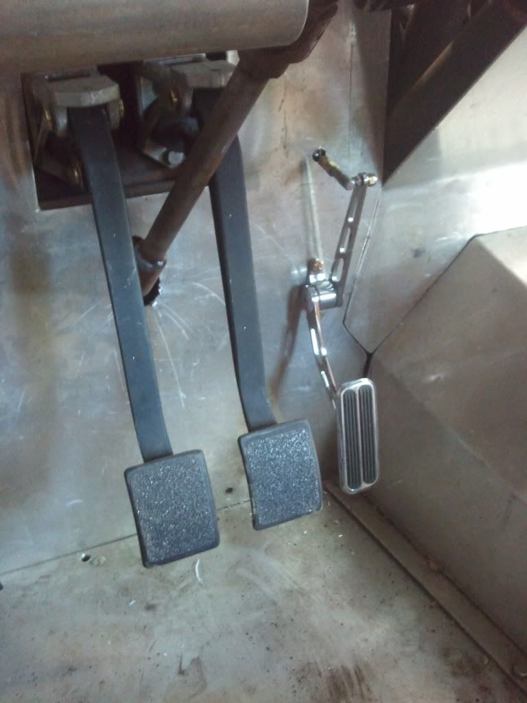

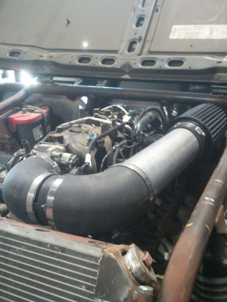

I put the acc bracket system on, went to full stuff, tons of room. Put the rad back in, got a lower hose on it, the upper is a bit of a trick. It will be 2 piece, and I can't find any pieces at the shop that will make it go. I'm trying to get the upper mocked up so I can get the intake elbows and MAF with filter mounted. I think I'm going to start plumbing and wiring and get it running for now, worry about MM crossmember and skid and bottom skid/tcase shifters when it moves. I need to hear it run to motivate me.
