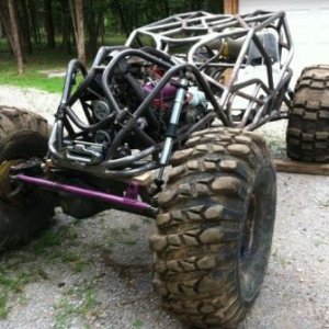

Here is my truck with grooved 54" Boggers
