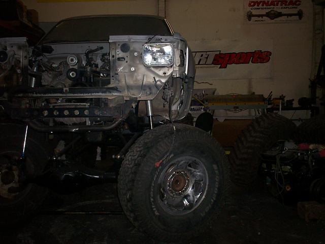

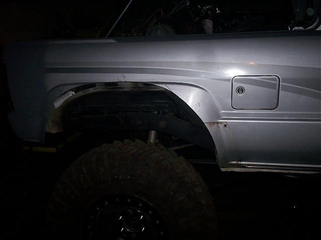

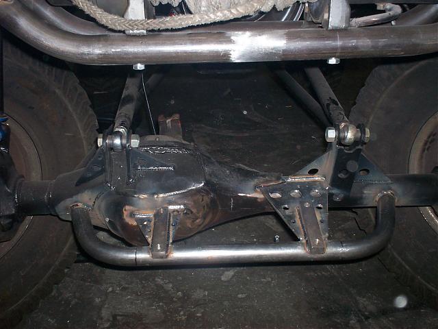

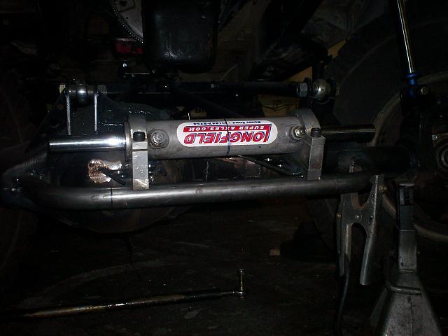

Got off my ass and did a little tonight, also got some pics of what the rear fender's look like, they are cut exactly to where the tire touches at full stuff all the way around, I think it look's gay, so we'll see if I can figure out something better looking. Also my custom 80 degree knuckles.

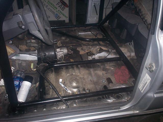

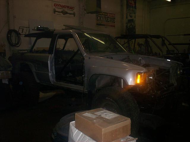

I'm still kinda putting along, got seat's mounted, and finished up on the cage what i couldn't do when I had to pull it out.
